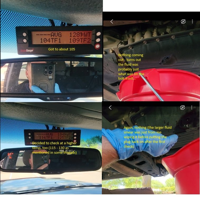

    I just went out and slightly loosened the hex check plug and I could see fluid starting to want to come out. Quickly tightened it back up. This is with it below temperature. So that makes me think that it may be overfilled since the fluid expands when hotter.
    Grabbing a bucket and some cardboard and I'm going to video record the fluid coming out it when it's at temperature and plug it at a slow trickle.

    Yup - fluid is low. I had the truck running.
    Nevermind - it must just have been fluid that was on the bolt or something.
    Here are some screenshots from two videos I took. I checked at about 105 and I checked at 115. No fluid came out. Time to call the shop, ask for a quart, and tell them I'm fucking doing it myself.

    There's always a teaspoon or so of fluid in the tube so there will always be a bit of fluid run out when you pull the check plug even if it's low.

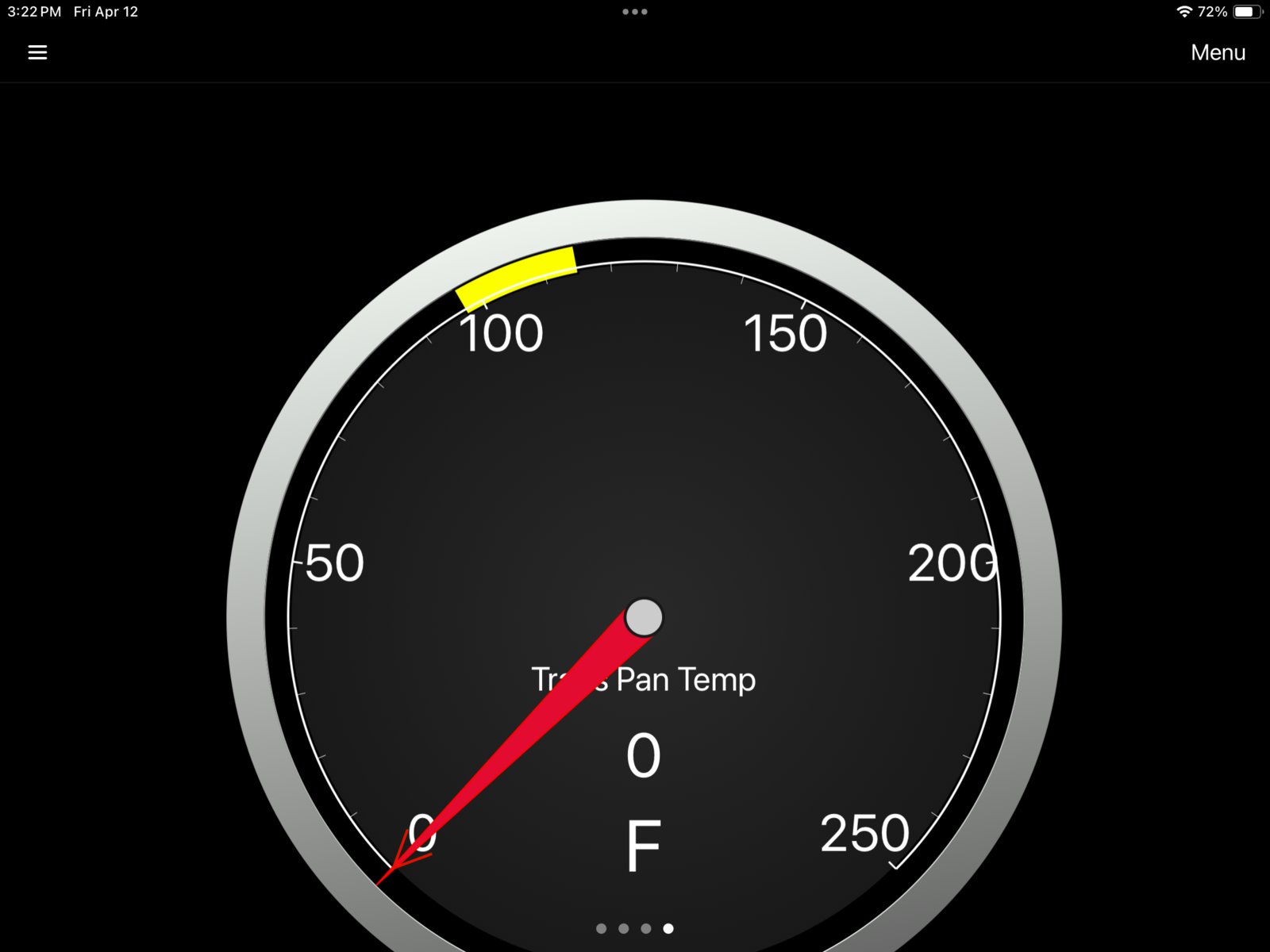

    I've been doing more reading and I do think that for my transmission I need to check it at 115 - 130 F. I have the A750F transmission, not the A340 E/F or the AC60 E/F.

    Between 97-115'

    A750 check temp was updated to 95-115F per TSB 0129-08.

    When she hits yella check that fella.
