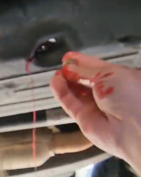

    The shop's response - "I don't know how it's low! We did the 11.5 quarts just like you gave us from the manual." :annoyed:
    I told them - yes, that's the capacity of it, but you have to overfill it and perform the check procedure to confirm! I told them it was obviously not performed because there was no fluid around the check bolt and I could tell it hadn't been cleaned around it, either. Of course, the lady said "The tech told me he checked it." Well lady - your tech lied to you.
    They have yet to find out that it was actually nearly THREE QUARTS low. I want to wait a few days to see if I experience any issues before calling them back to give them the whole story and express how f***ing insane it is that I had to do all this crap myself to get it right. I waited about 2 hours after driving it around for a few minutes this morning and performed the check procedure again at about 113 degrees pan temp. Of course, the washer from the check bolt fell and I couldn't retrieve it quickly :facepalm:so I had to put the check bolt back on without the washer. Then, I undid the bolt really quickly and threw the washer back on and it didn't really lose much additional fluid.
    I'm thinking when the replacement fill bolt comes in to replace my mangled one, I'm gonna put in like 300 ml more of ATF fluid, drive it around, and do the check one more time the following morning to be 100% sure everything is all good.
    Pic above is a still from a video I took right before putting the plug back on. I made sure to record every time I was doing the check procedure to have it for my records.
    Thanks again for all y'alls help and advice!

    Well, at least you know what the problem is.
    A shop that doesn't know what they are doing, and transmission low on fluid.
    I think you'll be fine. I doubt too much damage was done. One day, you might think about dropping the pan ad changing the filter and cleaning he magnets.
    But most people never do. It's like anything else, how long do expect the truck to last, and how much maintenance are you will to do to make it meet your expectations?

    Looks like a good stream to me. Put the plug back in and drive it. :thumbsup:
