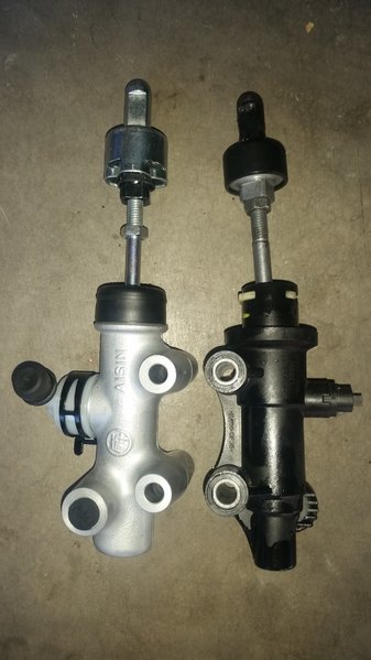

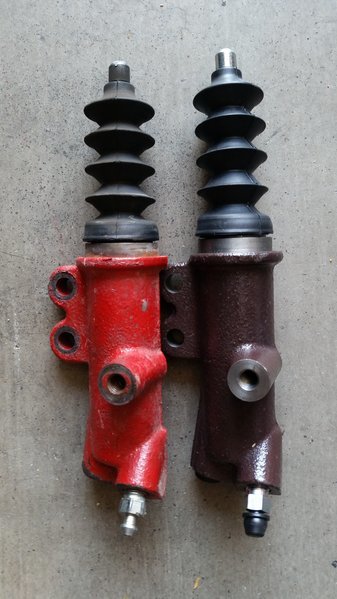

    I'll add some info in regards to the part numbers in the TSB for the master and slave cylinders. I recently replaced them and the parts are different from OEM.
    Left: TSB made by Aisin. Right: OEM made by LUK. The Aisin unit has a longer pushrod and clevis allowing for more adjustment and a metal clevis. I've seen a couple of posts where the plastic clevis of the LUK unit has snapped.
    Left: OEM slave cylinder (don't mind my fancy red paint). Right: TSB slave cylinder. The TSB unit has a longer pushrod and/or spring.
    I was able to apply some grease to the snout a few weeks ago by locking the clutch pedal in the depressed position. This made a very noticeable, improved difference.
    When I replace my clutch and TOB in the near future,I will complete the TSB with the pivot ball and arm.
