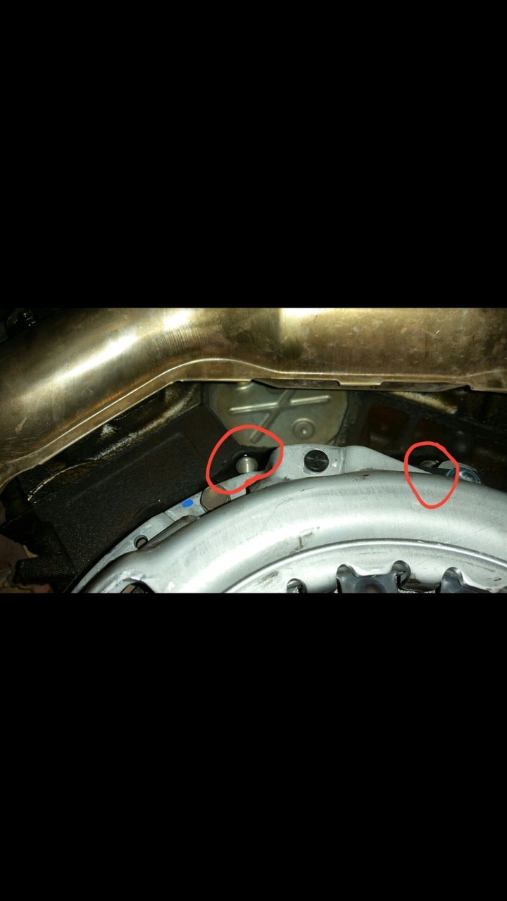

    Hey guys I have the r150 transmission (1996 tacoma 4x4, manual 3.4l) and I got all six transmission bolts, and both starter bolts out, but now I can't get the transmission to move out. It's moved maybe 1/16" away from the engine(I think) but I just can't seem to get the two to separate.
    Am I missing something? Is there another bolt somewhere? Or are there any tricks to pulling it back?

    Did you remove the flywheel viewing cover thing?

    Did you remove the debris plate that covers the bottom 1/4 of the bell housing opening on the engine side? Should be 4 bolts, I think 10mm (or maybe 12mm) heads.

    Gearcruncher: yeah that's me with the possible input shaft issue, but I had a mechanic look at the old clutch kit and he said it looked like a faulty TOB and it was seizing on the pressure plate, what are the odds of 2 faulty TOB's (both were Aisin brand)
    And I'll check today, but it's possible I left a clutch cover bolt on

    Not sure the clutch cover is the problem since you can't get to it until you get the transmission separated from the engine.
    ISU and I are referring to the debris plate on the bell housing. It is removable once you have the 4 lower bolts out. I got my transmission partly out and found the plate had to be removed in order to remove the transmission. I accidentally skipped over the step in the FSM.
    If it isn't that, it comes down to playing the angles to take any pressure off the input shaft. One other trick is looping a ratchet strap around the transfer case and the rear axle and tightening it up as tight as you can get it. Then shake the transmission to "jiggle" it free.

    Ah well I think the PO took the debris plate off (it covers the bottom of the bell housing right?) and didn't put it back on because there are 4 empty bolt holes on the bottom where my repair manual shows the bolts for it being.
    Also that ratchet strap thing sounds pretty smart, If I get time and a strap I'll try it out tonight
