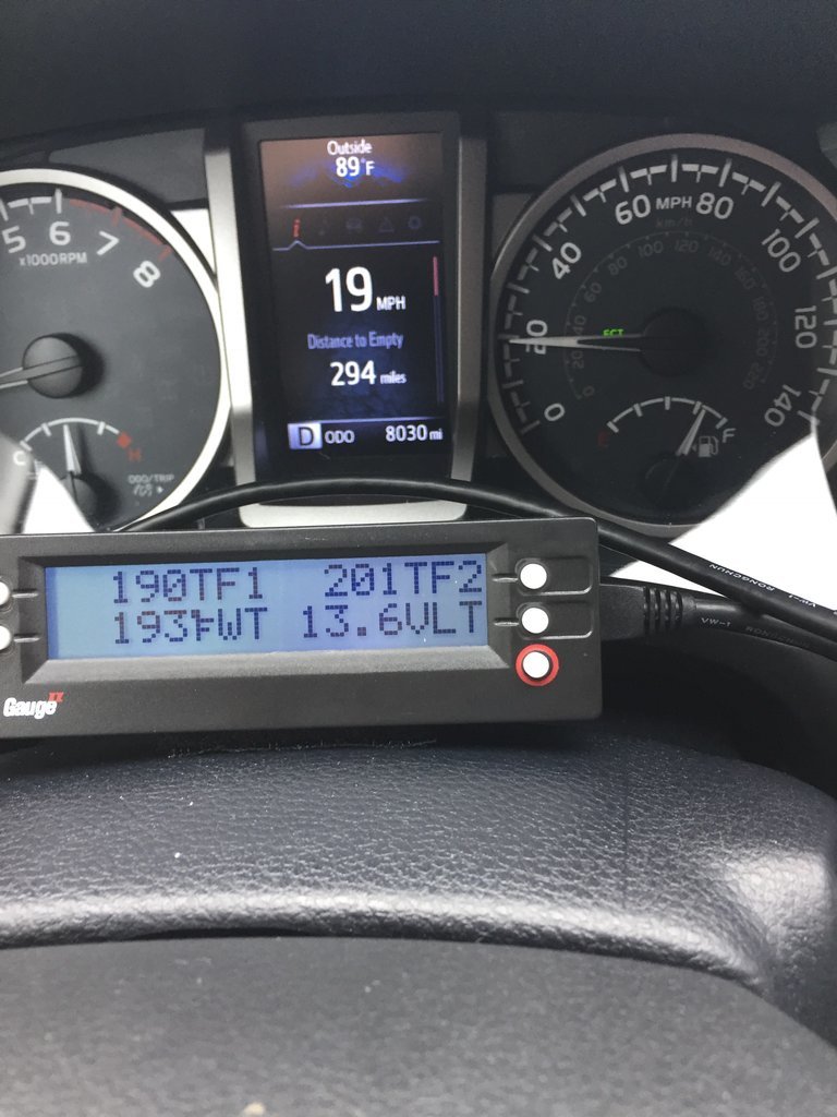

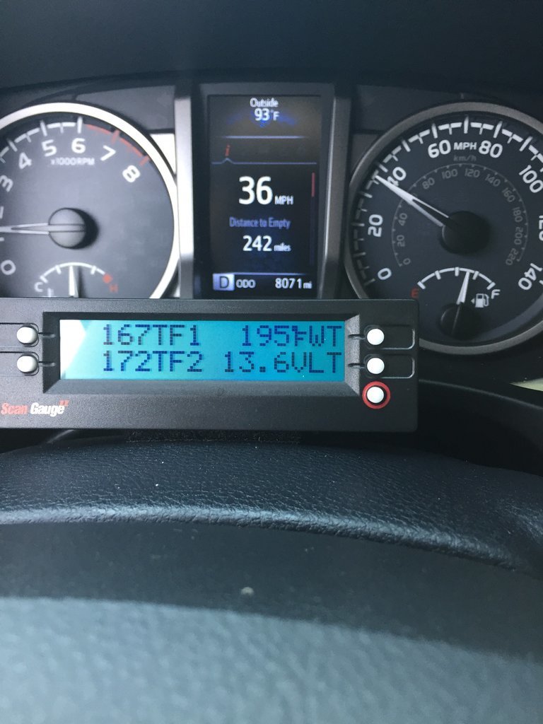

    I recently began the same process and I highly recommend the scangauge2. I purchased mine at advance auto ant it was on clearance marked down to $139.
    I also highly recommend pinning your thermostat when towing or in high temp conditions. Recently it has been in the 90s here so I tried it out and it greatly reduced my trans temps.
    Pic one is after pinning
    I also plan on adding an auxiliary cooler soon for a cross county trip.

    What codes are you using to get two tranny temps? And what year is your truck?
