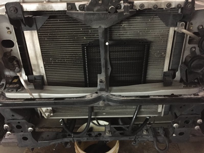

    I installed a Hayden unit and it made a HUGE difference in temps according to my UltraGauge. I was worried at one point that it wasn't allowing my trans to get hot enough because it was doing such a great job of cooling.

    Hey justinlhc, it looks like you mounted directly to condenser. I was going to do it that way but read that some people had damage to condenser from rubbing. What has been your experience. Tia

    Nope, mounted it to the brace in the middle. You can see the shiny bolt at the top. It fit perfectly with enough room for each cooler to wiggle if necessary. I wouldn't be comfortable mounting directly to the condenser. I live in AZ so my condenser is extremely important. :thumbsup:
    The bottom is also securely mounted, I just can't remember where or how exactly.

    Ok I see that now. It was an optical illusion of it being so close to condenser. I like where you mounted it I'm going to do same location. Thanks

    Your install will be even better if you install with hoses up to ensure no trapped air. Pretty much every plate and fin cooler manufacturer recomend ports on side or top and side ports emphasizing flow path to purge air.
    Tube and fin designs are not critical since they are simply extensions of the hoses.

    Yes, that is a huge cooler with very high BTU capacity. Guessing it was a tight fit unless there was no oem tow cooler or it was removed.

    Hayden never mentioned it. They specified that it could be mounted in any direction.

    Your truck no doubt. Any fluid cooler whether coolant, oil, or trans should be oriented to self purge entrapped air. Ports down invites a trapped air bubble that can limit cooler function or drop fluid level as the bubble purges out. All the best and many miles.
