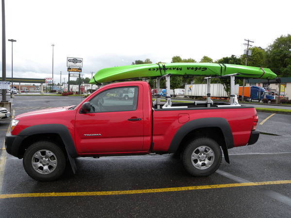

    My setup. I use pull/cams instead of ratchets since they are lighter and cant readily apply as much force that could warp or bend. 2 around the supports/kayak, the 2 more at the ends running back to the supports to keep it from sliding fwd or reverse.

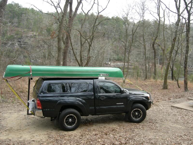

    This canoe is 17'. The bar was $50 from harbor freight and the styrofoam feet were $15-20. The front was attached to the nfab lightbar.
