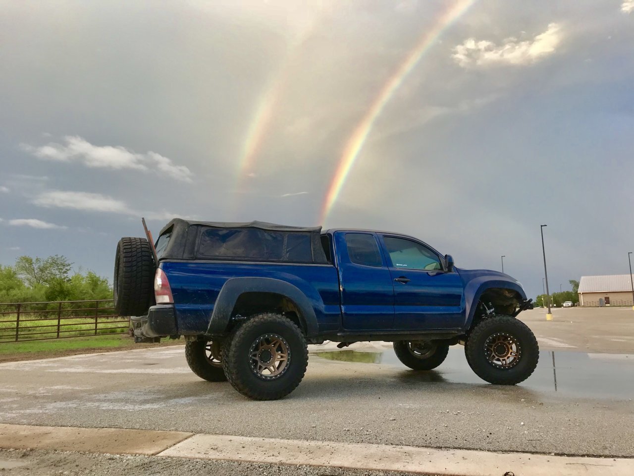

    Threw some 2” spacers on the rear

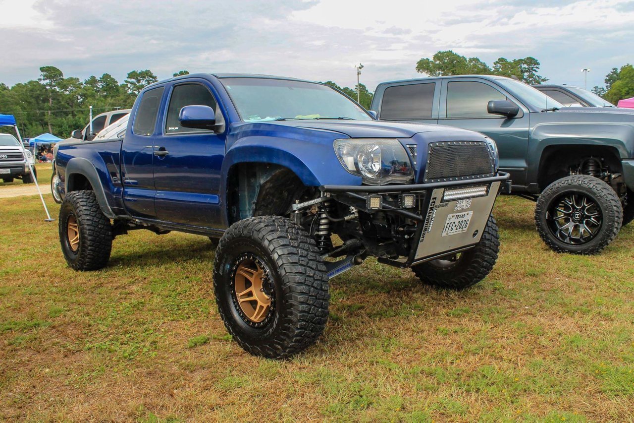

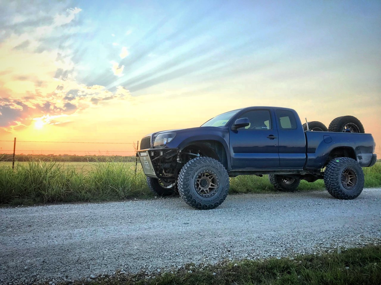

    The Prius is broken so I had to drive it to work yesterday it was a very expensive drive, but the pictures made it worth it

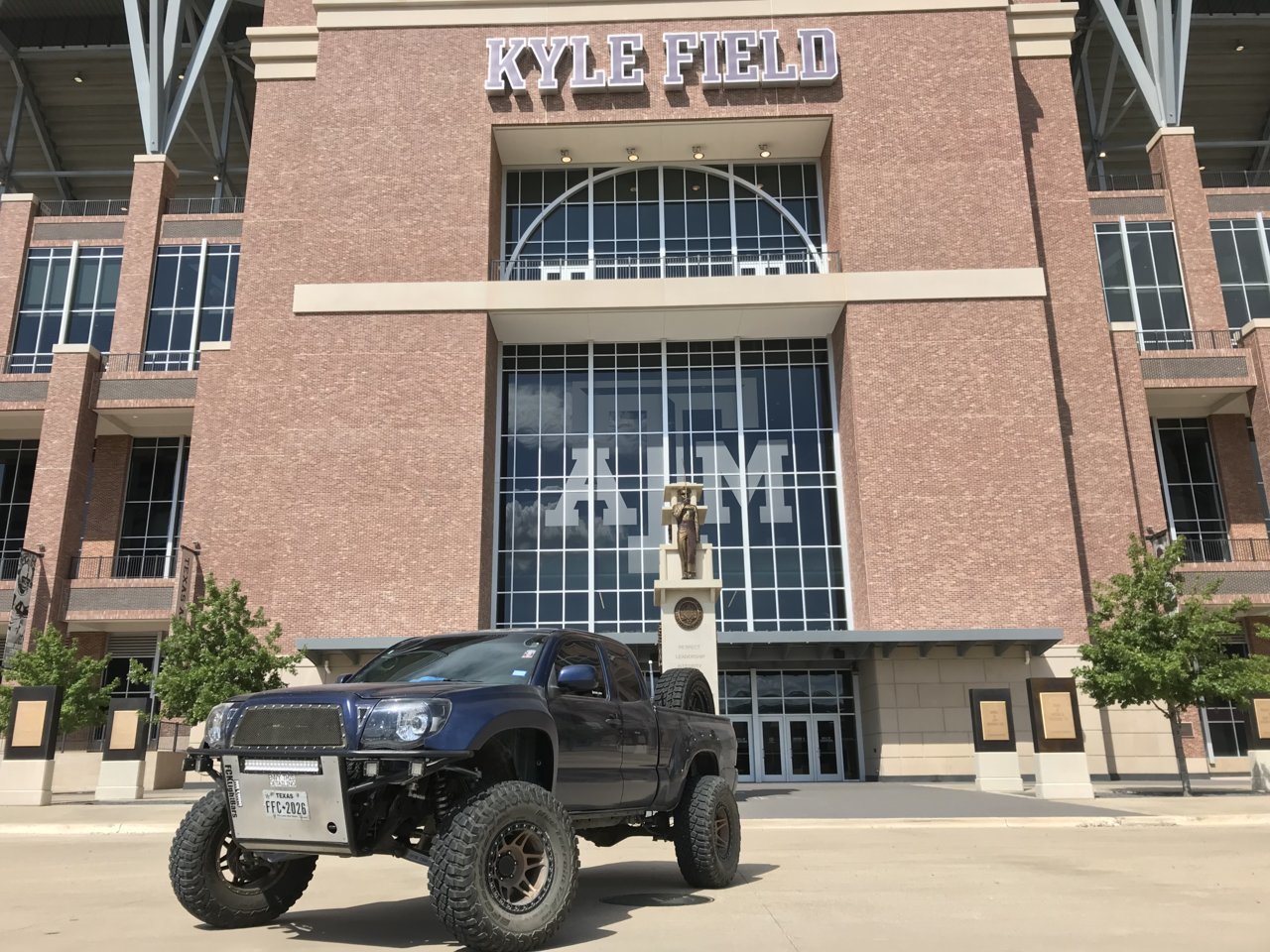

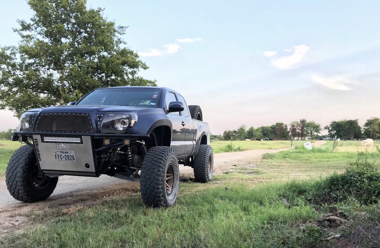

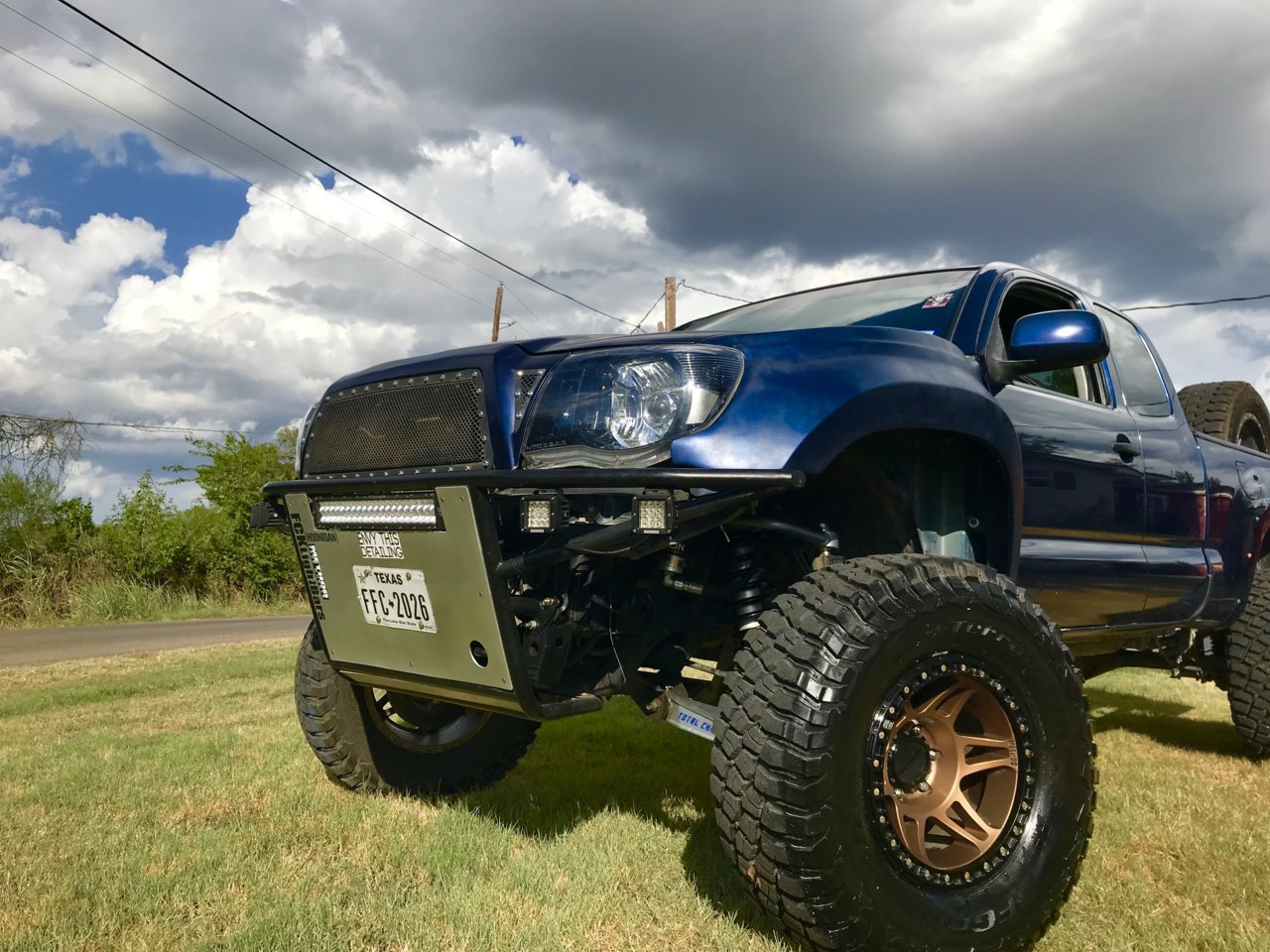

    Polished and waxed Now time to park it

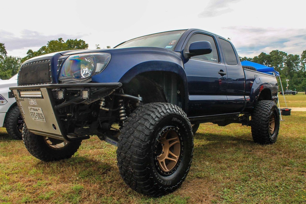

    Sick truck man I love it. How many inches are you sitting at? those 35's are looking comfy

    I’m around 5.5” lift and 8.5” width over stock

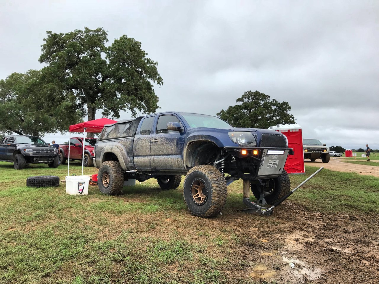

    The pot of gold at the end of the double rainbow got a new to me Bestop Supertop. I love it! #offroadminivan

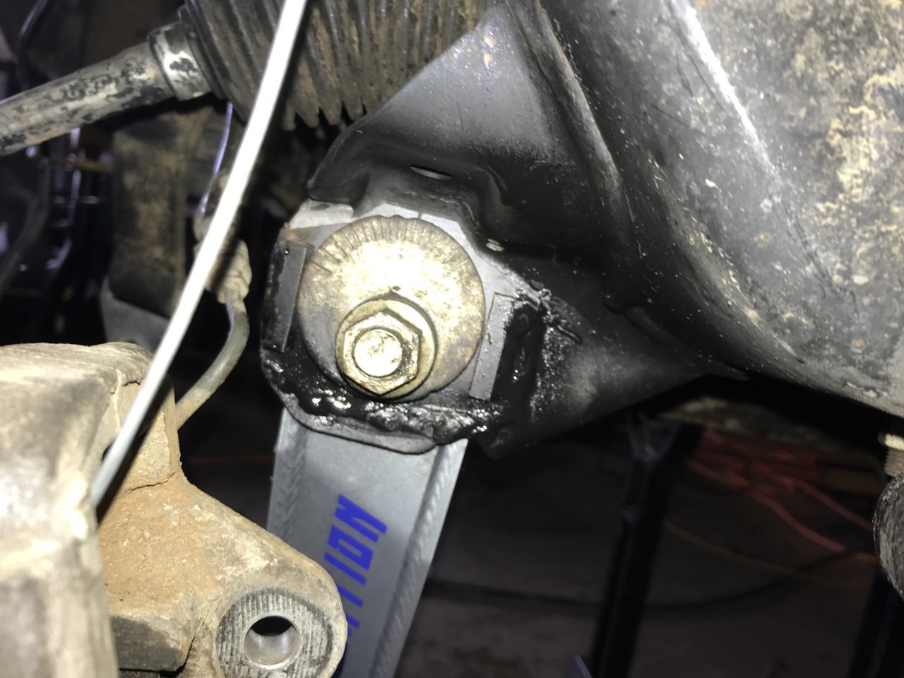

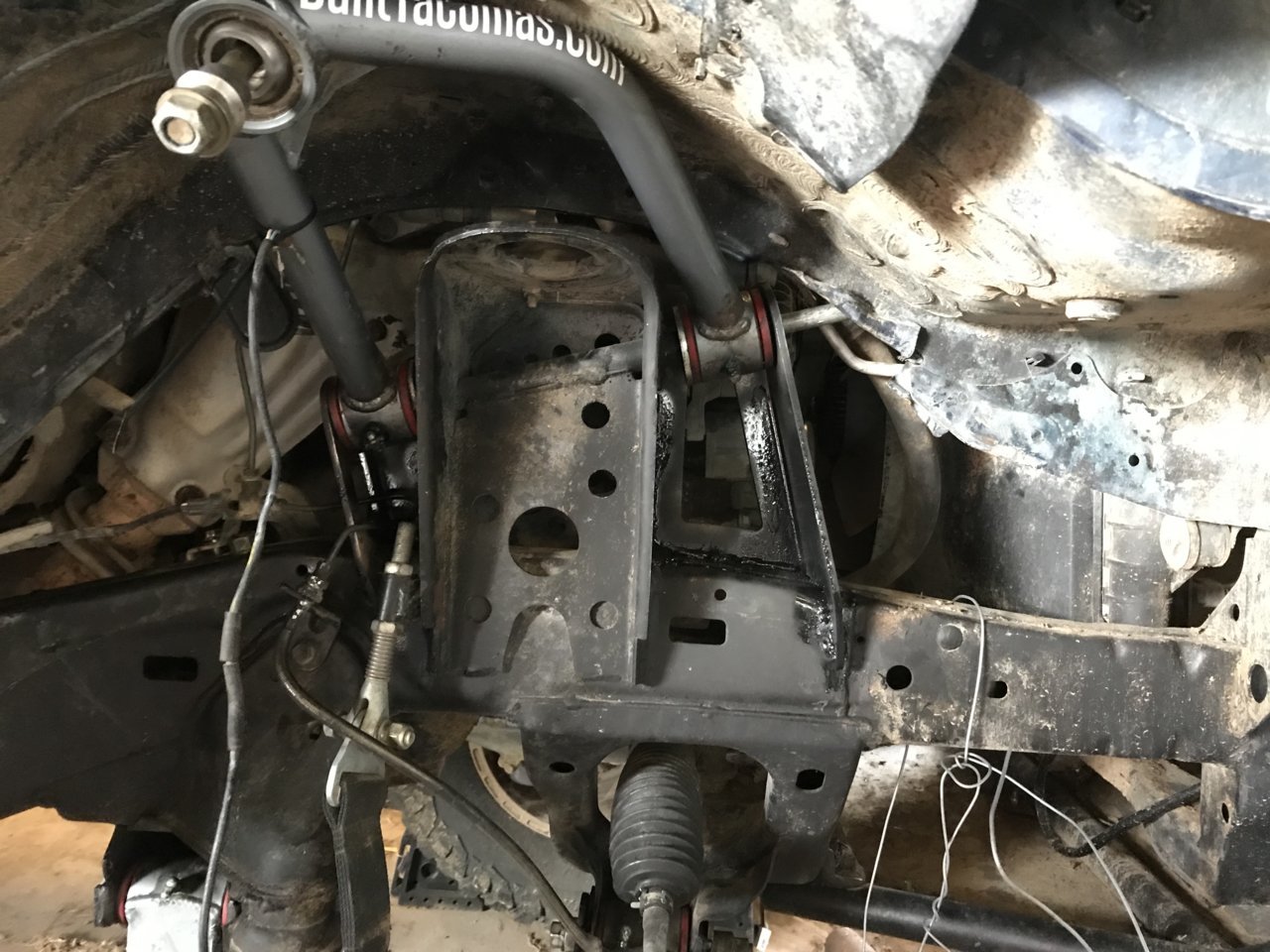

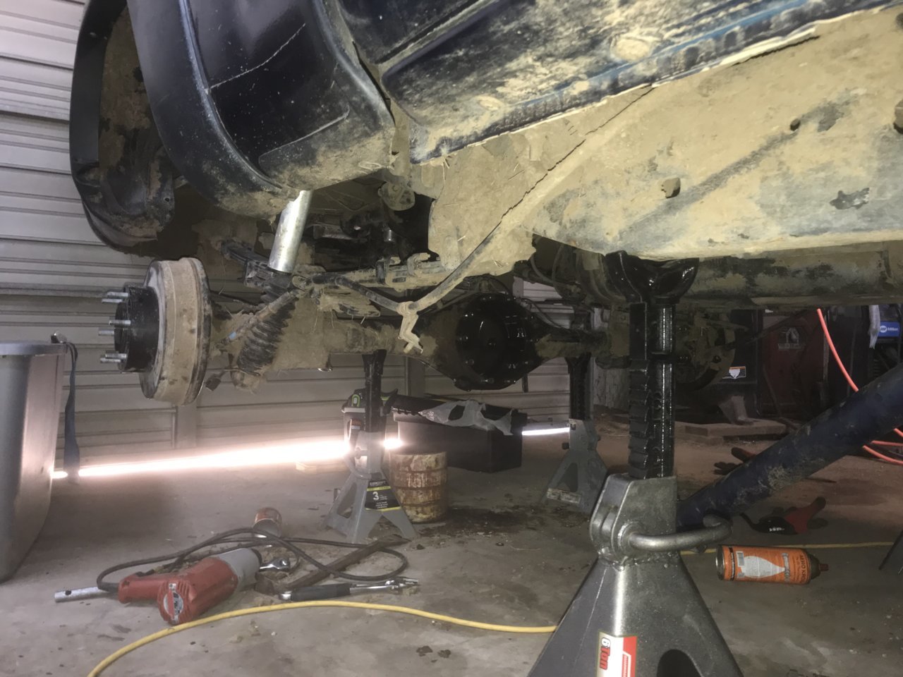

    Pulled an ABS line, lost my exhaust and spare tire, diff started leaking and bent an alignment tab a couple of weeks ago. Went ahead and pulled the differential out and sent it to @ECGS to get 5.29 and a Detroit locker installed since I had to pull it anyway to replace the seal. Turned a 15 dollar job into a 1500 dollar job. Also got cam tab gussets and coil bucket/UCA gussets from Total Chaos to weld on the front when I get the rear off jack stands
  18. Oct 15, 2018 at 8:42 PM
    #78
    TrapComa
    TrapComa [OP] Well-Known Member
    Dec 29, 2013
    #119396
    695
    Mason
    Cedar Park, TX
    07 Indigo Ink LT PreRunner
    Wannabe prerunner, wannabe overlander
    Got one side of gusseting done around midnight Friday night, didn’t have time to put it back together (the UCA bolt was the major hold up and I didn’t feel like messing with it all night). My diff is coming in tomorrow so hopefully this weekend I get this side back together, the other side gusseted and my differential in.
