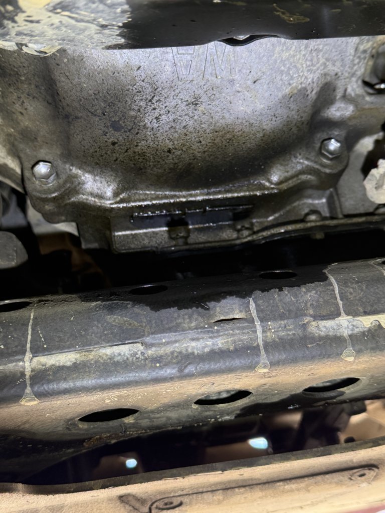

    Looking to see if anyone has seen this on their tacos? When I wiped it off, the oil did not appear red.
    additionally, there is no puddle of oil in the driveway to report, just noticed it today. Any advice or Next steps?

    Looks like rear main seal. Not common but not uncommon. Usually shows up around 175k. Local shop should be able to drop the tranny and replace it for about $1000-1500 depending on demographics. If you are mechanically inclined, it can be done in a weekend with a pony keg and a friend.

    Darn, just my luck. Is this something that can be babied or put off for a bit? This is just a daily and sees little to no off-road use, unfortunately…

    It wont hurt anything as long as you don't park in your in-laws' driveway and check your level regularly.

    Notes: only noticed it today and I’m under the truck often (due to CV axle troubles) and the last time I was under was about two or three weeks ago. assuming this happened between now and then AND keep oil levels good, I might be able to get away with not having to replace it within the next few months, right?

    Oh I've seen people go years with a seeping rear main. Its messy but will keep corrosion away...haha

    Also, might be a dumb question, but is there any kind of stop leak for this? I definitely will be paying very close attention to this, but thought I’d ask anyway

    Stay away from any stop-leak materials. The 0W-20 oil is very thin and runs through very tight oil journals and the stop-leak additive can just as easily clog a journal as it can a seeping seal.

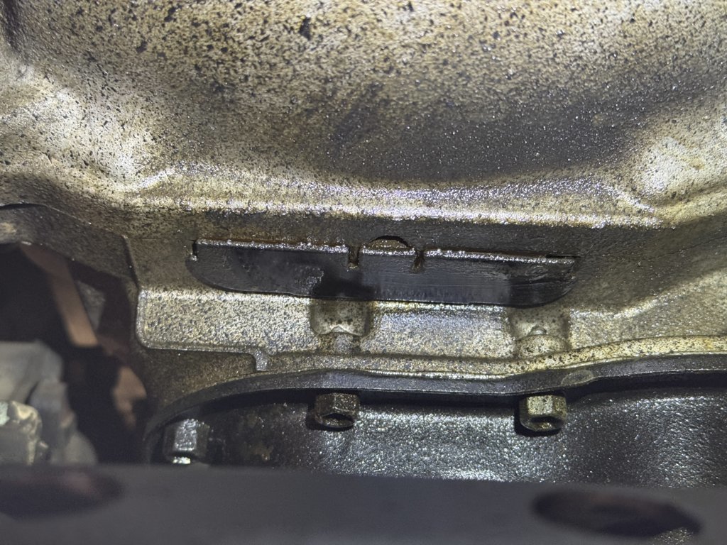

    Remaining question. That just came to Me: what is the plastic tab located at the bell end? I was wiping that down too and noticed oil beginning to accumulate there specifically

    I believe you are talking about the "inspection plate" which is how you access the torque converter bolts. Not sure what other plastic tabs are under there...been a minute since I've dropped a trans.

    Wipe everything clean with brake cleaner then check every 4 or 5 days to see how fast it is accumulating.

    It's manageable, but it's going to get worse. I had a rear seal leak on my F150. It started out with me only needing to add one quart of oil between oil changes to needing to add a quart every week.
