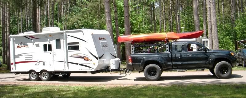

    I tow a Coachmen Apex 22qbs which is about 3700 dry with 2500 cargo capacity with a lifted 2006 tacoma extended cab prerunner all over the state so far.

    Can you tell me about your truck what lift and tires yours looks amazing are those sliders or just steps Thanks AWESOME taco

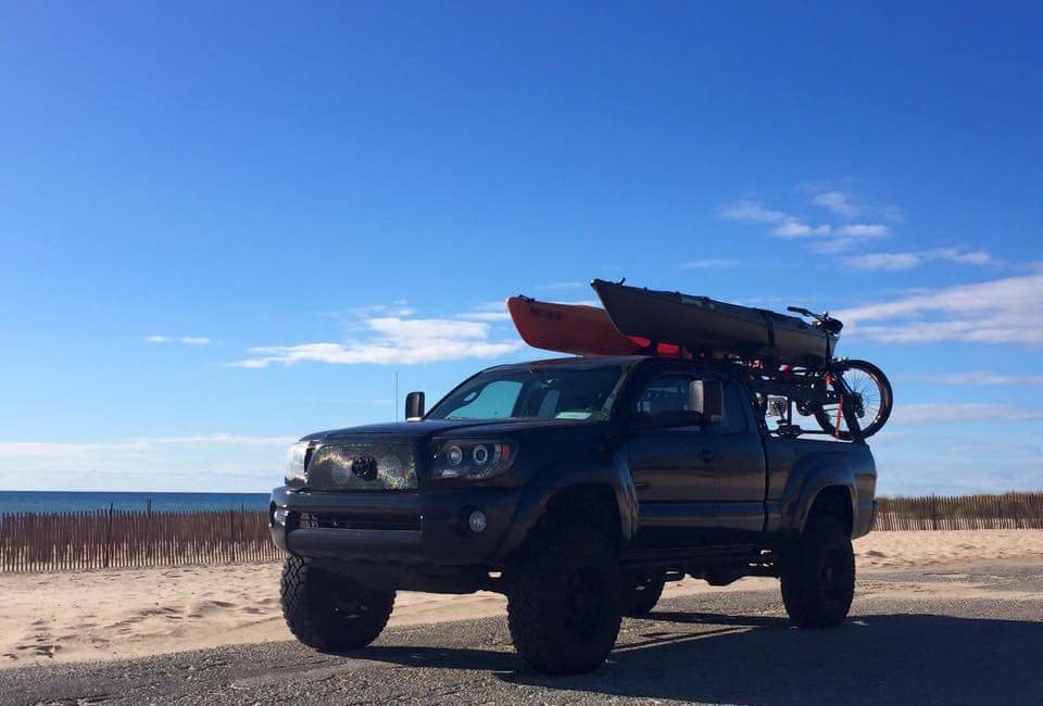

    That is an old picture, in that pic it has a 3" spacer lift with block in the back...here is an updated pic....
    this has a 4" spindle lift, light racing upper a arms, and bilsteins at 1.5" and All Pro Expo leafs in the back with a 1" block....rides 10 times better than the spacer lift...also have dodge tow mirrors, n-fab side steps,
    go rhino bed rack, and a custom bike rack that i made...tires are goodyear duratracs, 285/75/16, i had nitto terra grapler before...same size...and since i tow allot i installed a set of 4:56s in the diff...
