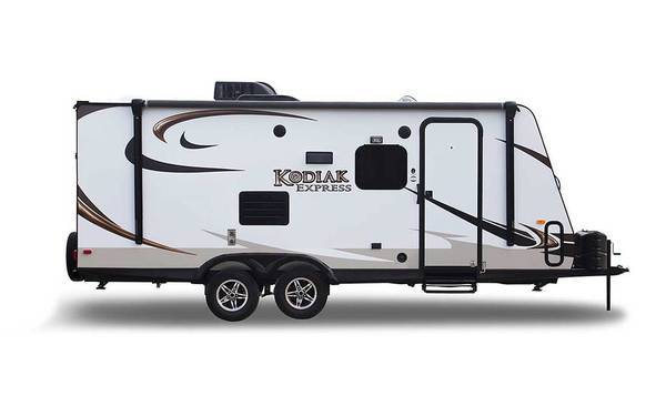

    I'm thinking of purchasing a 24' travel trailer but I'm not much for making sense of the trailer weights or if can/should be towing this with the tacoma.
    Here is what I have :
    2011 TRD sport tow package, short box.
    Here is what I want to buy:
    specs:
    Unloaded Weight 4,182
    Cargo Capacity 1,318
    Hitch 460
    Length 23' 8"
    Height 10'
    Width 8
    Am I crazy to think that the tacoma can tow this easily? Any thoughts?
    Any help will be appreciated.
    Oh, and merry Christmas everyone! !

    Lots of variables to consider. Where are you going, how much weight will you be adding to the truck and trailer, what do you expect or would be comfortable with regarding driving dynamics.
    My Tacoma is an 07 Prerunner DC SB V6 auto with Firestone RideRite air bags. I have a 24' HiLo at 3700 empty, we don't load much in it, throw a 300lb MC in the bed and head for Texas from Iowa. I keep the speed in the 50 to 60 mph range, no big altitude changes, drive conservatively and it's a pretty comfortable two day trip to Corpus Christi. Have averaged as hi as 14.5 for the trip and as low as 12 if you catch the wind against you.
    My big concern about the TT you are looking at is the profile. As P.Steve says I think your going to catch a lot of bow wake off the big rigs and be buffeted around with the short wheel base of your Tacoma. My HiLo collapses to around 6' hi so presents a lot less surface area for the buffeting air to act on and a lot less drag going down the highway. Pulling with the Tacoma is the reason I looked at and purchased the HiLo.
    If your not going far, not on the "interstates" much, travel light, don't mind working the truck, pay attention to the transmission by keeping it in the correct gear you'll be ok. If your traveling distances, going through the mountains.... Find a HiLo or a bigger tow vehicle. Just my free advice.

    I was always told to take the max tow number from the factory (6400#) and multiply it by .75 and you are close. Things like how far and where figure into this. Never use fifth gear, and take it easy and you'll be fine. Throw it in overdrive, and try to go 70 with the cruise on... You get the picture. Make sure you have the electric brake controller fully functional. My pops always says "any asshole can launch one, but can you bring it back safe?"

    Nice choice of trailer. The Kodiak has the huge 52 gallon fresh water tank which nobody else does. Also larger grey and black tanks than similar trailers.
    From my experience towing a loaded Kodiak 166E and loaded truck bed if you want to hold 75mph you have to drop down to 3rd gear and fourth on level roads and slight inclines, and you'll get about 8-10 mpg. Kick it down to 60-65 with the same load and you'll get about 11-12 mpg and won't have to go into 3rd gear often.
    It's the wind resistance from that wedge. The faster you go the more the wind resistance.
    For hill climbing on the steepest grades like 6% plus, with loads say about 6000 lbs total weight trailer and truck cargo, you'll be screaming that V6 near redline in 2nd gear to hold 50 mph.

    I Believe forest river makes this trailer its called the wolf pup or something around those lines its a bit smaller it looks like, but lighter as well. I don't know if something like this would work for your needs http://www.ebay.com/itm/2015-Forest...em5416de5859&item=361160923225&pt=RVs_Campers but I figured I would post it up here incase it helps anyone out. I hopefully will be purchasing one of these next year sometime for snowboarding and atv trips.
