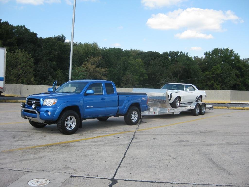

    I used to tow my open car trailer and car with my '06 Speedway AC Sport. Due to the low profile, I never had a lot of sway induced by wind or passing rigs. However, the truck was under-powered on steep grades.

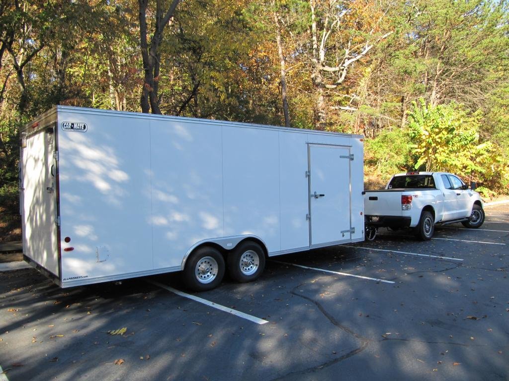

    When I bought my enclosed trailer, it was a completely different story. I towed it home from the dealer (around 75 miles) and parked it. Towing that box, even empty, was a very scary experience for me on the Interstates. Maybe going slowly on back roads would have been different.

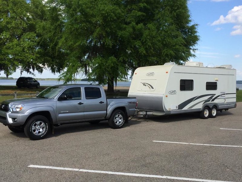

    My trailer weighs 3870 dry and I use a equalizer weight distribution hitch. Transmission temps averages about 163f. I drive about 55mpg and I am very impressed with the way my 2015 tacoma 4x4 Off Road tows. I traded a 2008 Tundra crewmax for this truck.
