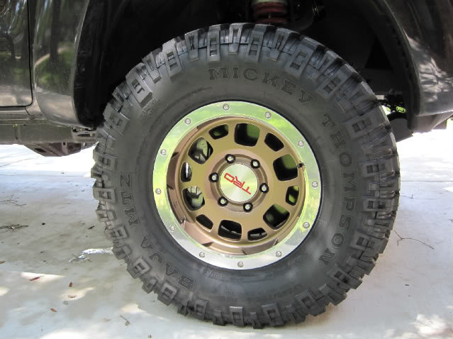

    #36105
    798
    This is with light racing UCA's, Toytec ULK, and 285/75 Mickey Thompson MTZ's
    TXpro4X4 and Cmurder like this.

    Brandon, did you have to cut the cab mount or do any real triming? I've got LR UCAs and want to run 285/75Rs on my OME 886 setup. Thanks!

    798
    No cab mount chop and no trimming. I wheeled quite a few places and never rubbed, not once. I think part of the key is the alignment. You need plenty of caster.

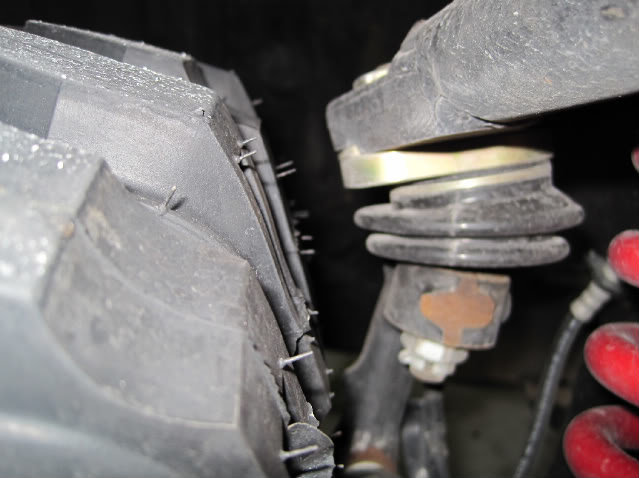

    Maybe it's just the angle or shadowing but on the second pic it looks as if the weld is a bit separated from the tube on your UCA?

    It's a shadow. I have not had any issues with the LR UCA's yet on either of the 2 vehicles I've installed them on.

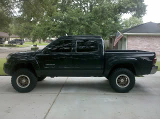

    Just got my second set of these wheels and the new 285 75 r16 bfg's ta ko2's, 3". Leveling kit, no spacers and it does not rub a single bit, went wheeling and no rubbing. I'm so happy with the set up!
