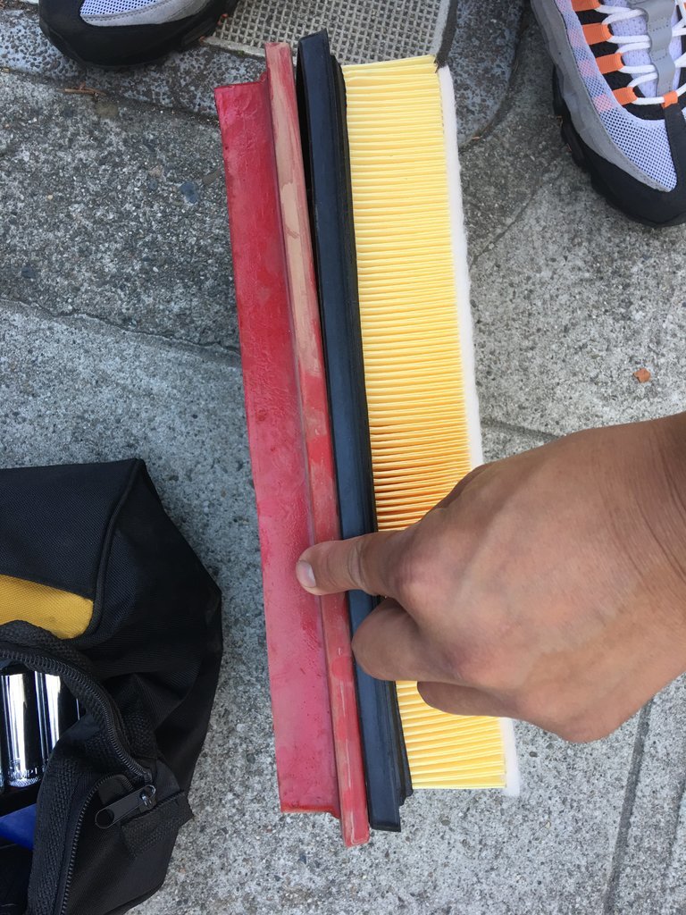

    I have a later version so it's the flat squared one.

    That AFE is listed as drop-in replacement for the 2010-14 FJ (Toyota paper filter p/n#17801-38051).
    If there's a dealership close enough, or hell even a parts store - take your TRD filter in with you and compare it to a stock paper replacement for the FJ. If the dimensions are the same, you'll know right then.

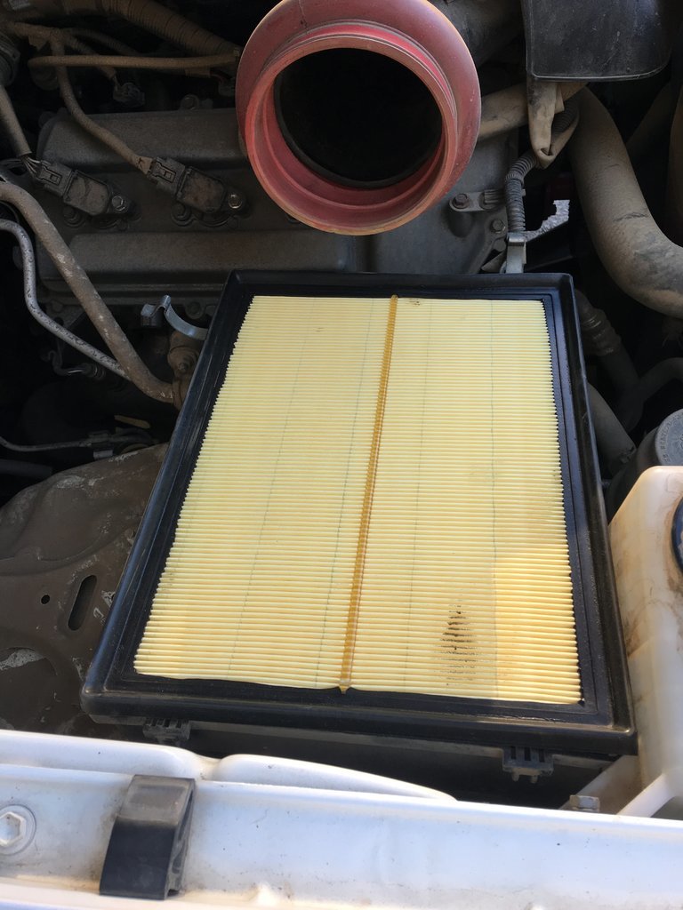

    Cool so I got the filter today and can confirm that it does work

    Yay just going to switch to a regular filter for everytime I go off roading. This is a picture of it sitting in the box.

    Quick question: with the paper air filter being quite a bit larger in depth, is there any problem with it fitting down in the TRD air box? Mine appears to have a small ledge around the right hand side of the box (facing the truck) and was wondering if it'll take some maneuvering in order for the paper filter to fit correctly. Thanks n advance.

    Airbox is deep so it fits perfect.
