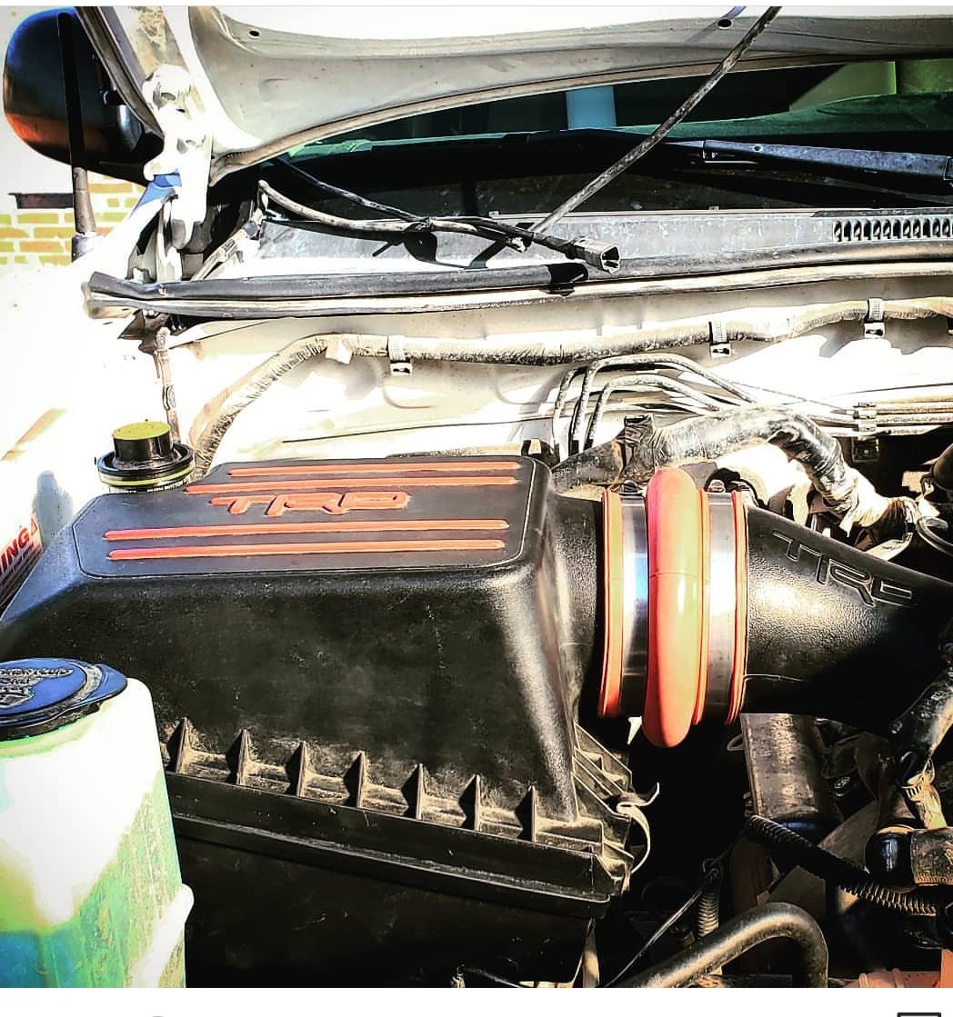

    That's a good idea, that intake is flawed and makes the truck run lean.

    Toyota and trd do not MAKE performance intakes. They pay real intake manufacturers to make them. You can buy one from AFE which has an aluminum cover and is super loud but runs fine, it's not CARB legal tho. This company used to make intakes for Toyota and stamp them "trd" for a few years.
    U can also buy the "TRD" one that's all plastic and black/red and uses a panel filter, but it's made by aem/k&n and makes the truck run lean.
    Those are the closest to "trd" ur gunna get.

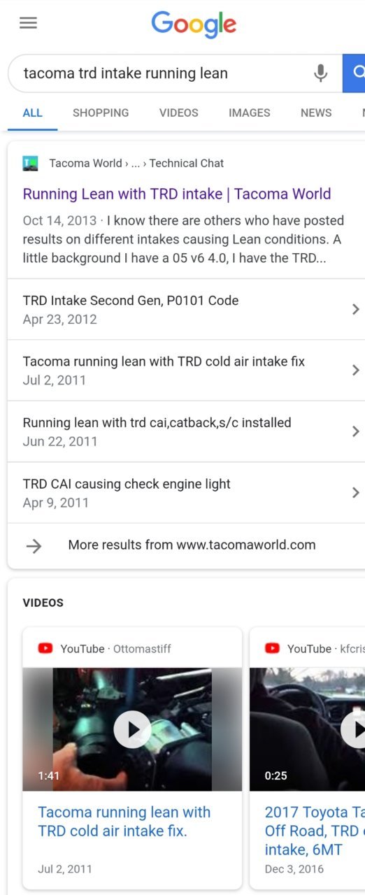

    Years of comments on here, comments on xru, gadget testing and developing a new map to fix it, comments on YouTube and just now a simple google search.
    K&n/aem rushed the job to win the contract after the afe made "trd" intake made years before was found to not be CARB legal. Somehow k&n/aem used the wrong size tubing and it causes the maf sensor to read incorrectly.
    It's actually nothing new
