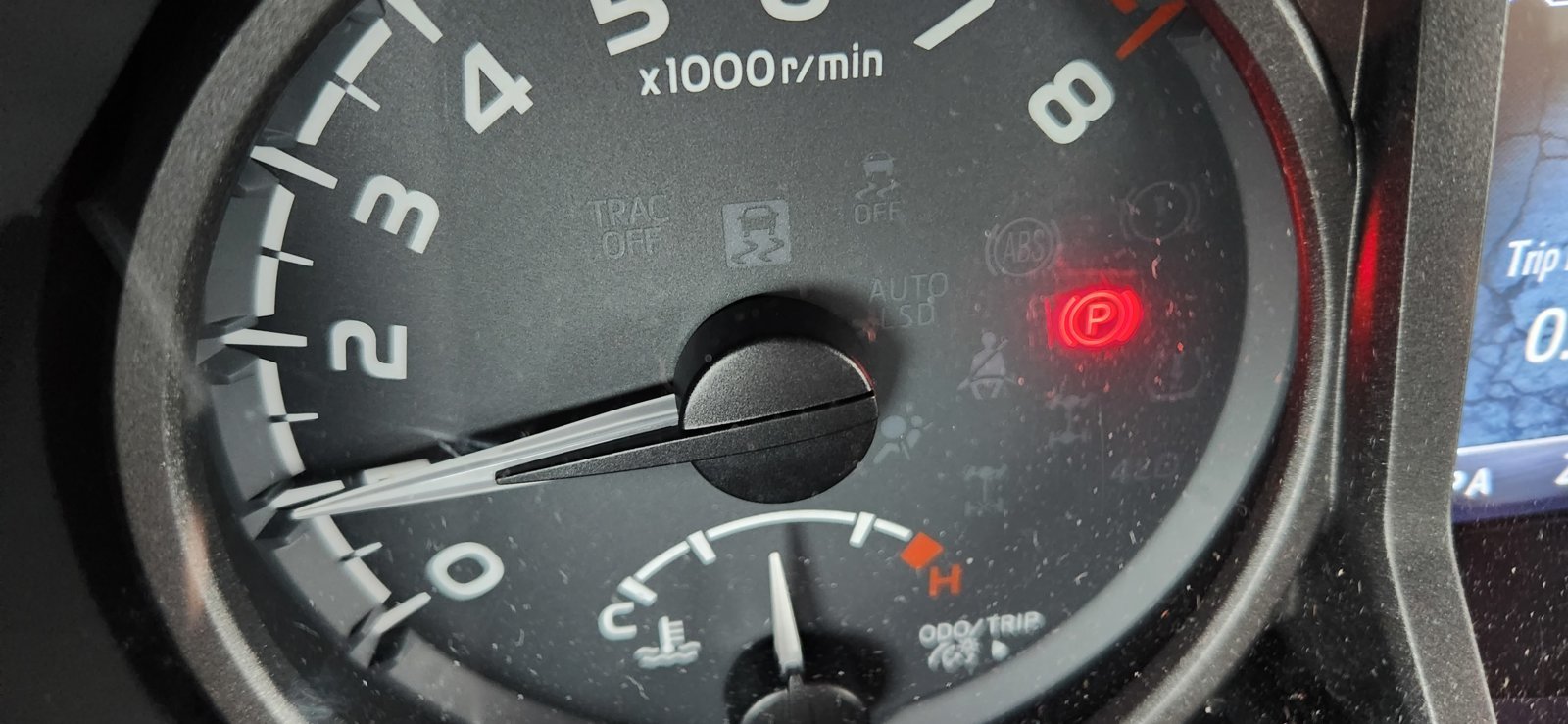

    Here is a picture of my tachometer... I don't see a diff lock there... where is it normally? 20231214_115225.jpg
    Nevermind, I see it now. Just above the H of the temp gauge. The picture helped me see it.

    The advantage of AutoLSD mode over the default TRAC+VSC mode is that it does not reduce throttle. It works decent for getting out of icy parking spots. I’ve experimented with the mode and made some posts in the traction control thread.

    Down and to the left of the 4wd I believe. (close to H)

    Yeah, you got it. My guess is most combo meter differences are km vs mph, auto vs manual, stuff like that. There are a bunch of different part numbers and I can’t come up with reasons for why there would be so many. It doesn’t help that the descriptions on the parts sites are not very good.
