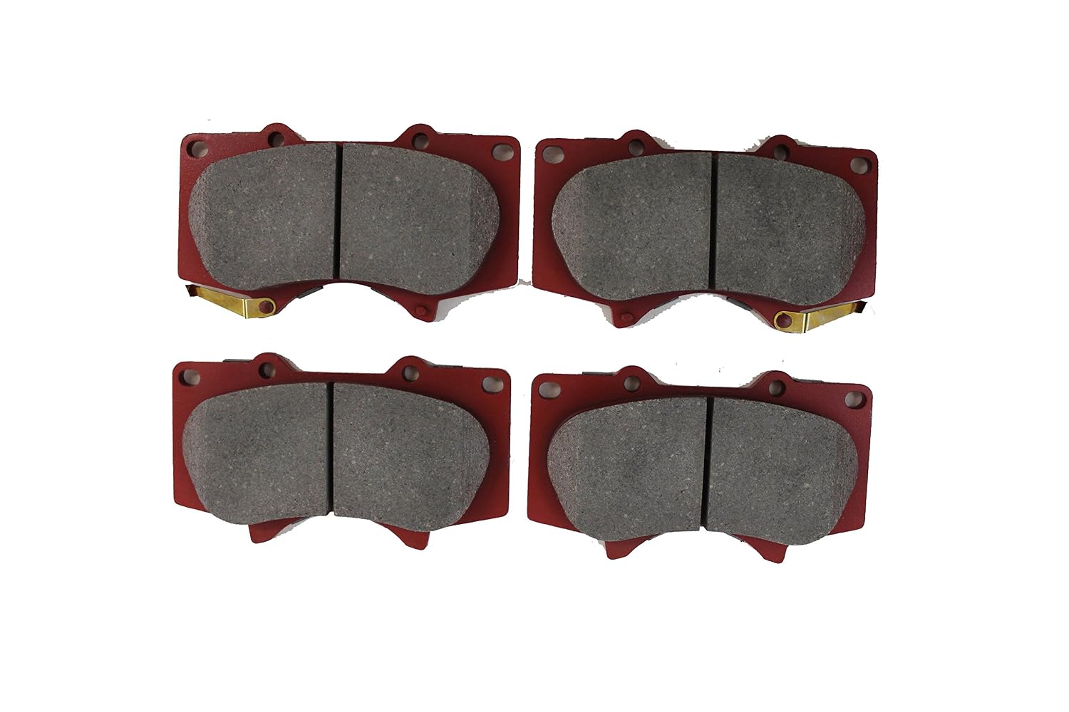

    Decided to go with TRD Brake Pad (PTR09-89111) and Centric High Carbon Plain 125 Series Cryo-Treated Rotors (125.44129CRY). About $100 for pads at dealer and $200 for rotors from Tire Rack. The pads look like brake pads, nothing too special about them, although I feel their magic is in the pad compound. The rotors do seem better than rotors that were on there. Glad that these won't rust right away. After bedding in the pads, the brakes are now much grippier. I planned on installing SS lines and flushing the brake fluid but I didn't have time. I'm sure after that it will be even better.
    [​IMG] [​IMG]
