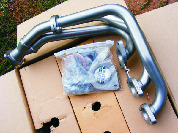

    Read up on that deal some more. Said that it comes with and unopened parts bag. I'm guessing that's where my gaskets would be, right?
    Someone let me know about these things please!

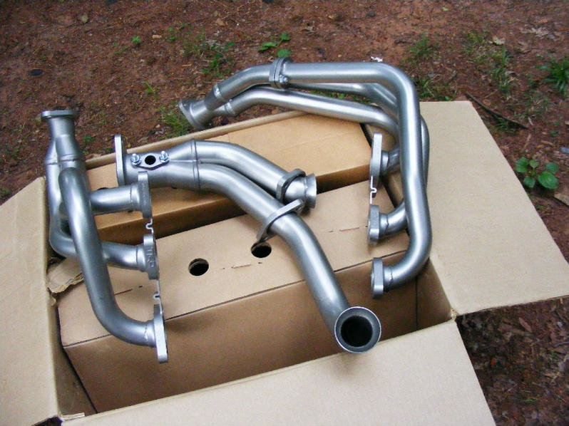

    Okay, here is the full set of headers. I finally got the picture.
    Now, is there anyone out there who can tell me if these will fit? I really need to know if this set of TRD headers from a T100 will fit in the Tacoma engine bay. Does anyone know?

    Thats a good price to find on those headers. They are hard to find. They give good gains, and are easy to install. Not sure what the difference is between the T100 and tacoma though.

    I dont see why they wouldnt fit but buy em and if they dont then just resell them!

    I'm thinking about doing that. I've been comparing pictures and they look very close. I'll wait a little to see if any one else out there knows about this.
