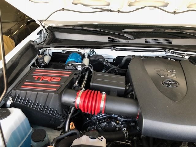

  8. Feb 27, 2019 at 3:49 PM
    geekhouse23
    geekhouse23 The "Liftman" - @DrFunker
    Jul 14, 2013
    #108251
    15,709
    2GMGMDCSB4WDTRDFTMFW!! TL;DR
    mostly stock, grocery gettin' Prius

    Looks sexy man. So did you actually feel a bit of power increase without the pedal commander? The reason im skeptical is cuz i read some tacoma owners had bad experience with pedal commander. They said they had a bunch of lights come up in the dash and truck ran like crap after few months of using it. Would be really nice to have more throttle response with my manual tho. My ranger was a cable and was instant response, quite nice.
    Dammit Evie[QUOTED] likes this.
