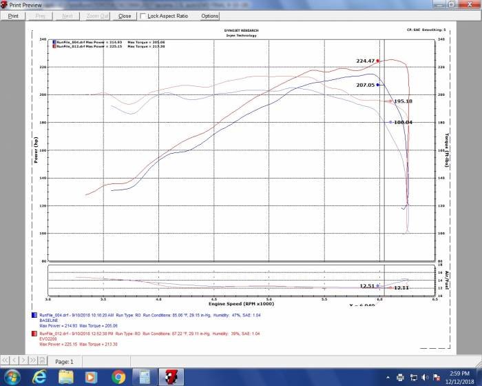

    Based on that claim of 17 rwhp and look at that graph I wouldn't trust anything they say.

    right. the factory intake isnt even restrictive when its way down at 3500 rpm and its showing a 5whp increase.

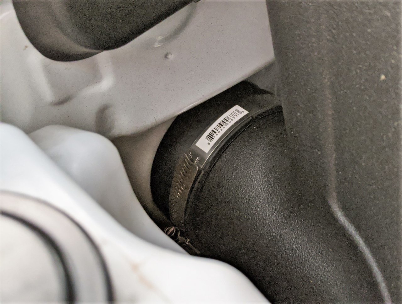

    The Injen intake was an easy install with good instructions. The only thing I didn't like was the way the filter box intake tube mated to the fender (just a rubber piece that butts up against). I chose to use the rubber flange from the TRD kit instead, since it actually goes through the fender opening and seals against the outside. It's the same diameter and mates to the Injen box nicely with a 4-5" SS hose clamp.

    Until someone provides dyno data for the TRD kit, I'm convinced it's just a nice-looking and louder OEM intake with a longer-lasting filter. Those may be benefits, but the price is steep. For $400 I'd like a performance bump too. And if all you want is a longer-lasting filter, just buy the TRD filter individually and install it in the OE intake box. It's the same size.
