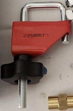

    The kit definitely comes flared and, IIRC, the line pictured does too. To be safe, recommend putting eyes on it at your local O'Reilly/Autozone/Pep Boys.
    Can't remember what they're called, though it's apparently NOT "hose clamps," but I bought a set of these at Harbor Freight...

    Fluid Line Clamp Set - I have them as well

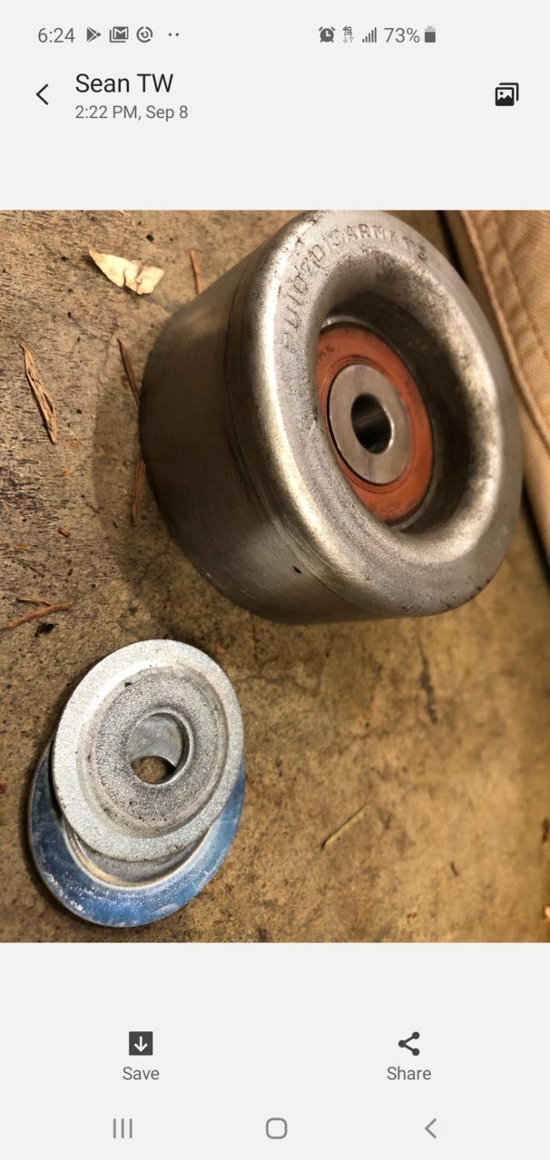

    be sure to check your idle pulleys while youre in there. i changed all mine. one was sick.

    You know I wasn’t going to let you do that in a parking lot in the pouring rain.

    well, at least one of us is thinking things through!

    big thanks to @crashnburn80 this weekend helping me sort this out! #best lit garage ever
