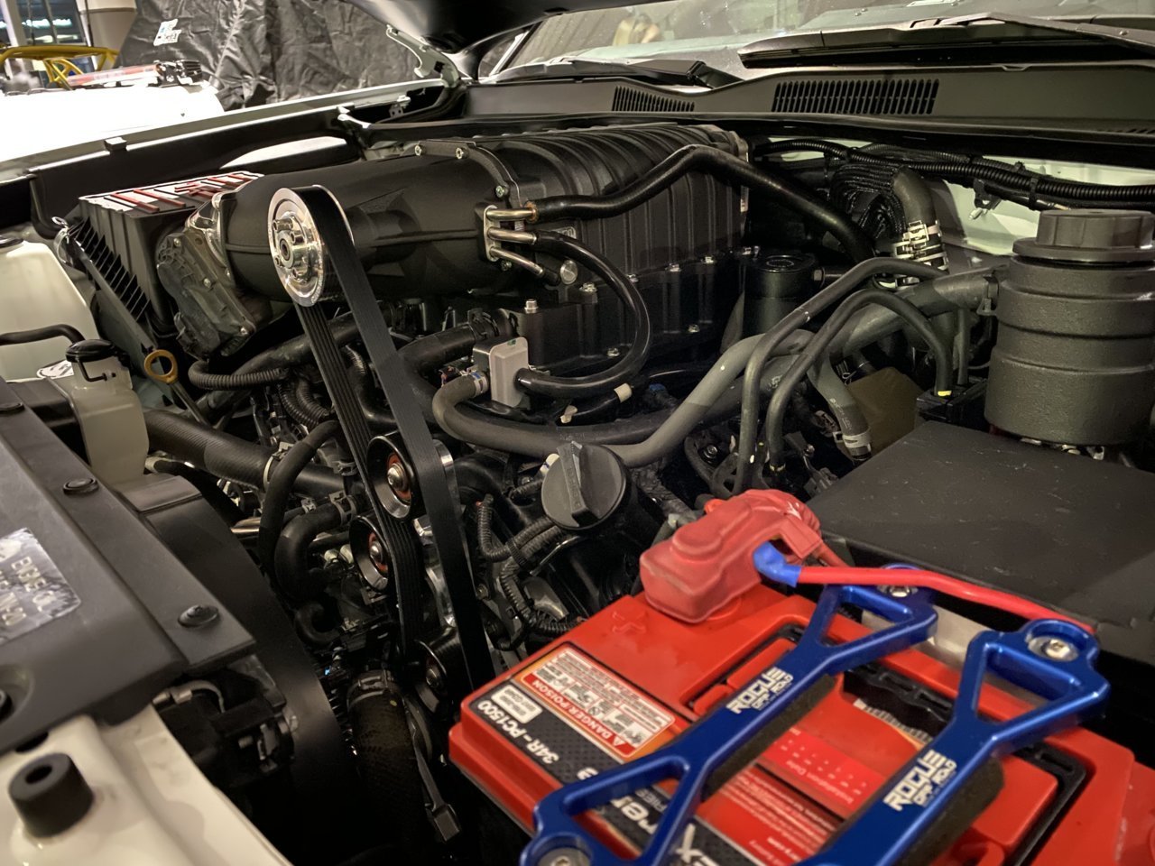

    Also got this in today.........me and @ThomasMore66 against the world. :crapstorm:
