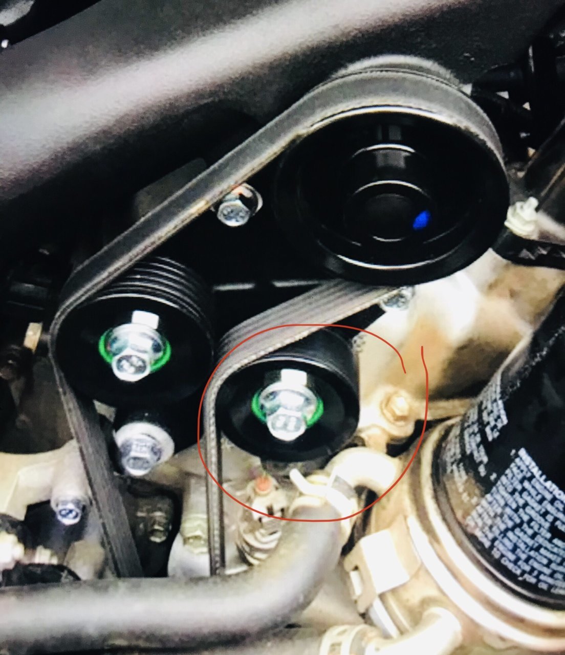

    E22844B3-D2AE-418F-91D4-EEDCE36936B7.jpg Anyone know the part # one that has circle in red?

    This is from page 1:
    Supercharger Drive Bearing Replacements:
    (big thanks to @DocME for doing the legwork on this):
    Location............................OE Part Number Upper Grooved Idler ..........NSK B17-102DG3 Upper Smooth Idler ...........NSK B17-102DG3 Mid Idler ..........................China 6203-2RS Tensioner .........................NSK B17-102DG3 Lower Idler .......................NSK B17-102DG3 So if you're ordering a full replacement kit: Quantity (4) 6303 bearings - common replacement for NSK B17-102DG3 - 17mm Bore, 47mm OD, 14mm Width Quantity (1) 6203 bearing - 17mm Bore, 40mm OD, 12mm Width After looking at the on the shelf options for high speed bearings, I came across these Timkens: 63032RSC3 - https://www.qualitybearingsonline.com/63032rsc3-timken-deep-groove-radial-ball-bearings-17x47x14mm/ 62032RSC3 - https://www.qualitybearingsonline.com/62032rsc3-timken-deep-groove-radial-ball-bearings-17x40x12mm/ They have some of the highest limiting speed and reference speed ratings that I could find in an on the shelf bearing. I've been a Timken fan for OEMreplacements, I put them up there with Koyos for my preference. All in, these cost $70 delivered from Leeds. 2 day delivery time. We'll see how theylast.
