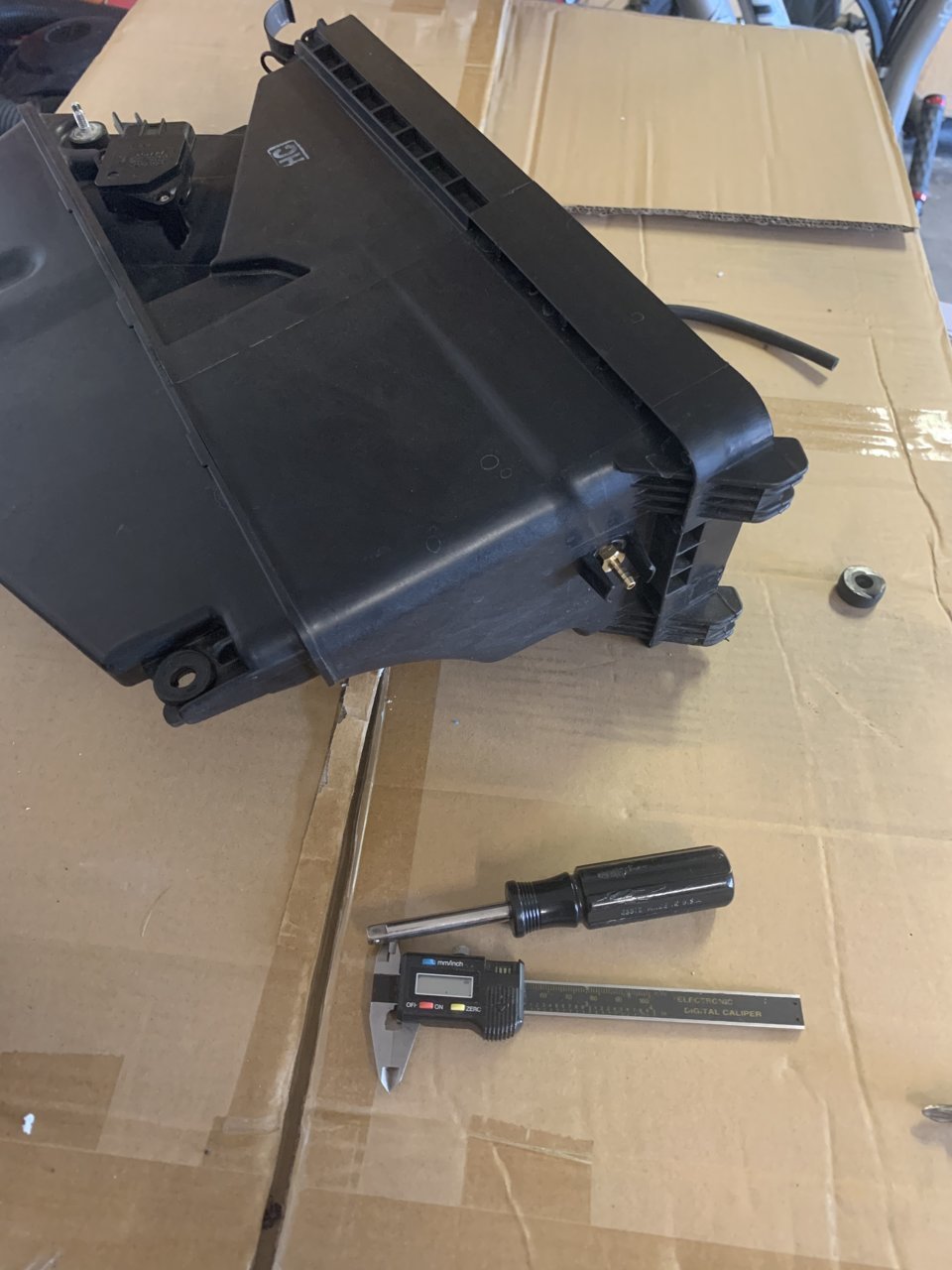

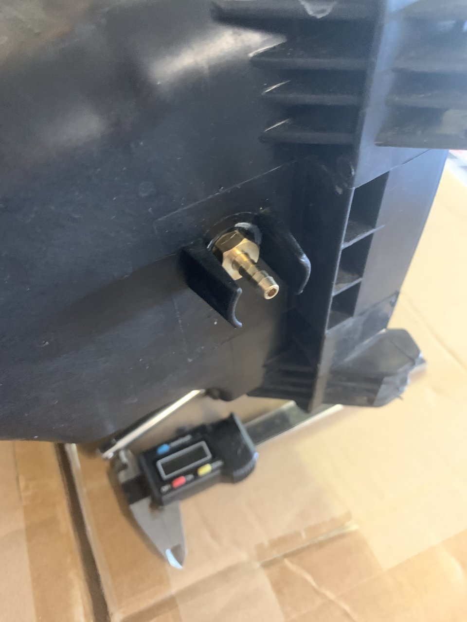

    i think the serp was rpm. no trimming needed.

    Have a part number for that one sir?

    i dont. i went to o'reillys in a hurry. in stock fwiw.

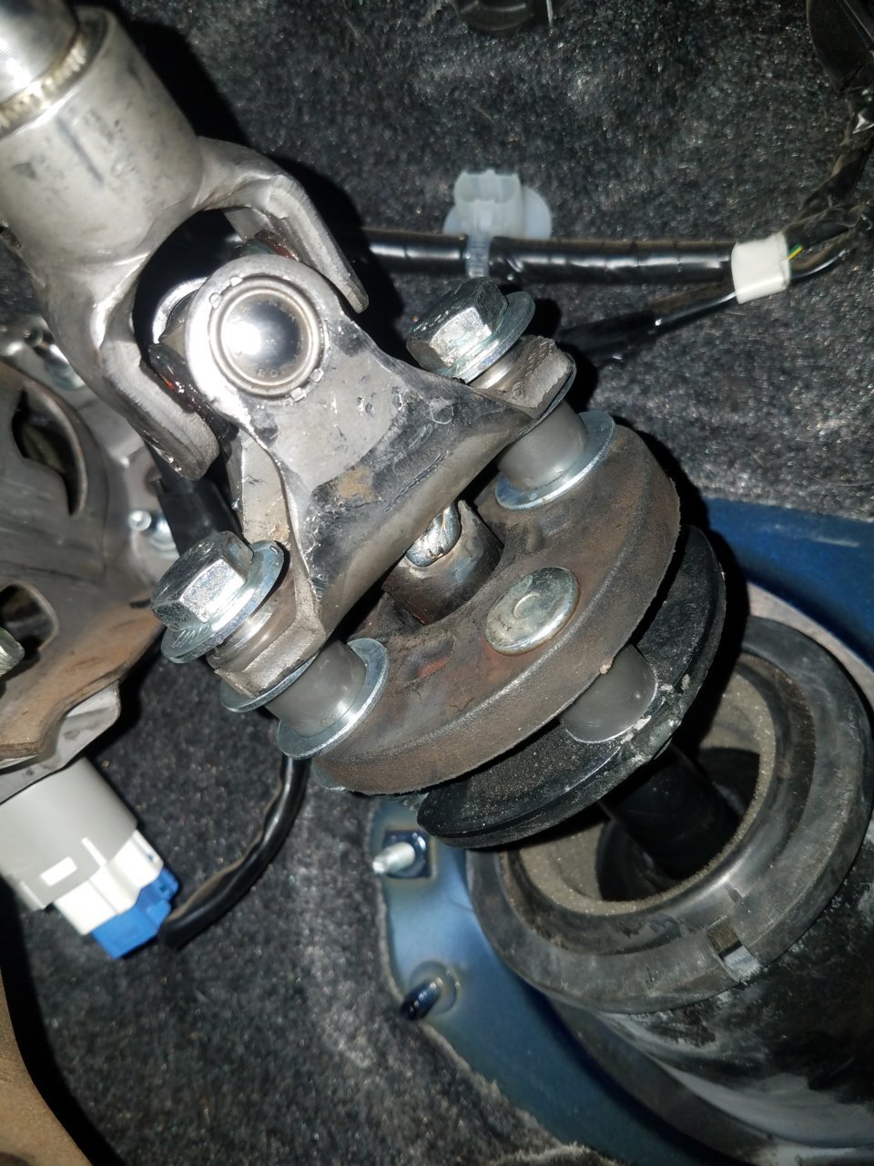

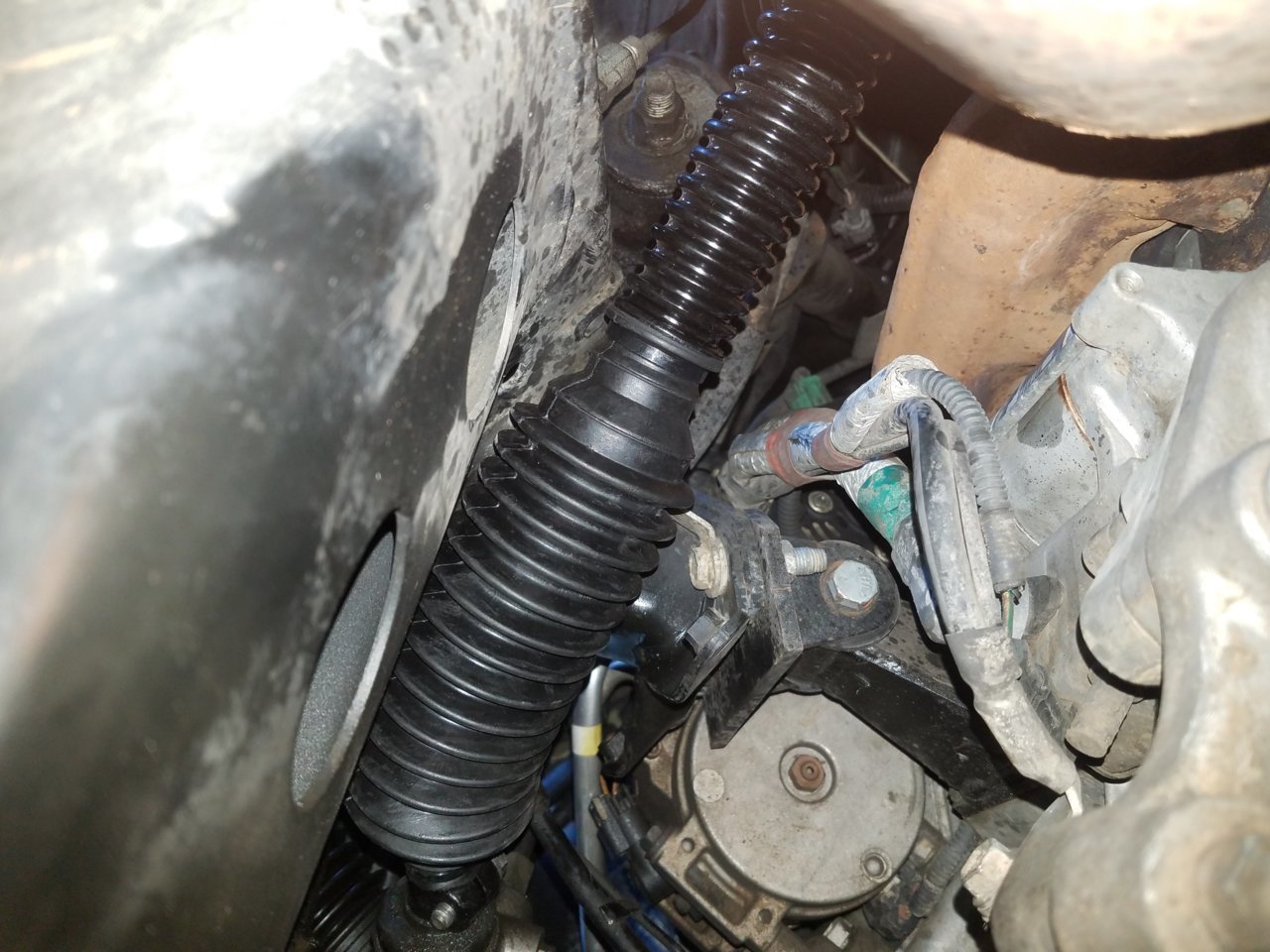

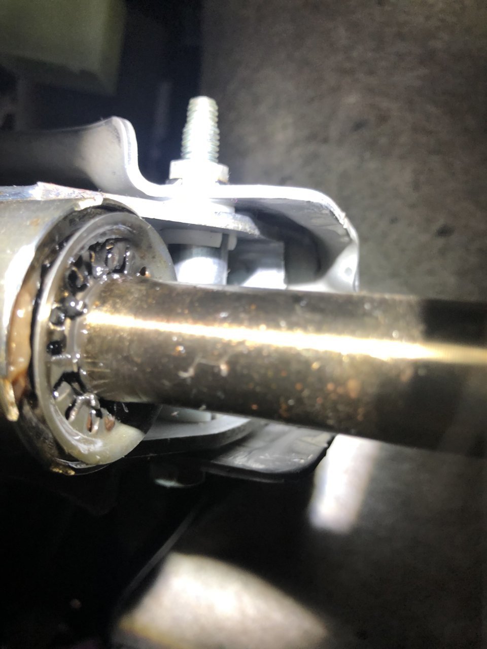

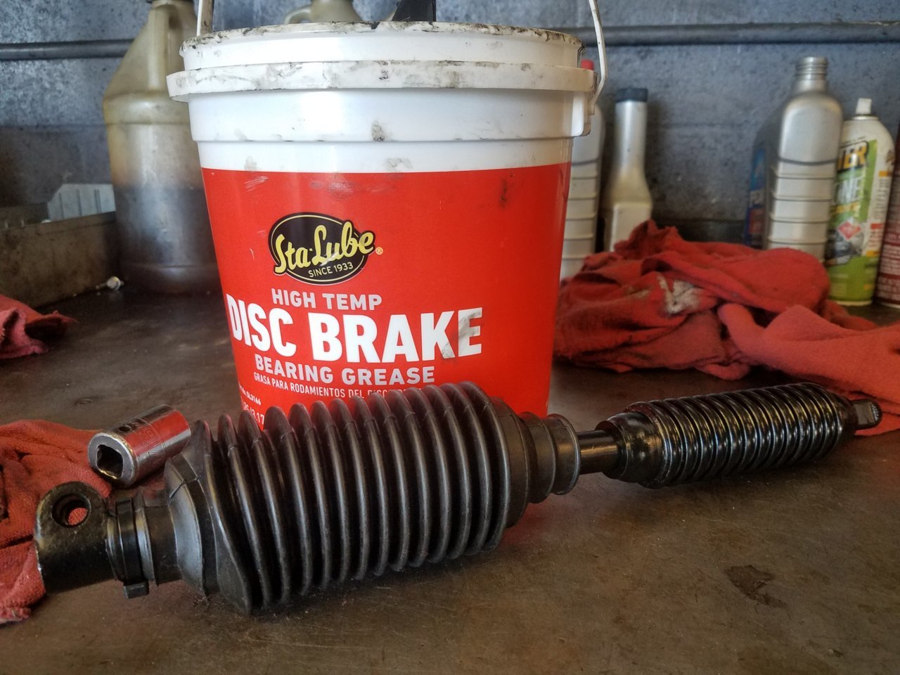

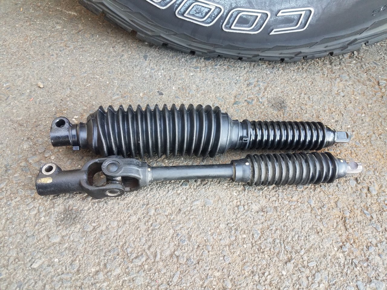

    Okay. I have owned this truck for nearly 8 years now... In all that time the truck NEVER tracked straight, and has been plagued with a myriad of steering issues all related to the steering shaft, the upper, and lower intermediate shaft. After finally soldifying all tracking issues and isolating it due to tires, lateral play in the rack because of loose bushings, and slop in the tie rods, it came time to address all the issues the shafts were plagued with. The soft bushing in between the rag joint on the upper shaft was an issue and the lower shaft was binding like crazy and causing clunks while driving. I also eliminated the soft bushing after it was all said and done by welding the shaft and the U joint portion of it together. I should had been good right? Everything is solid? Wrong.
    The steering wheel splined shaft which connects to both of the shafts beneath it was missing a locking clip which allowed the shaft to bounce around and slip ever so slightly in a in and outward fashion allowing some very mild clunks over bumps as well as odd sensations while at full lock left or right.
    I installed the clip today, and ALL issues have ceased to exist. The truck has never driven as nice and straight and quiet as it did tonight on the way home.
    Bliss achieved at last. :)
    Pictures below to show my mods of the shafts.
    (This is not my own shaft clip just a picture of what it was missing to secure it in one spot)
    (To prevent binding and to eliminate the chance of rusting/ and seizing due to its inherently open nature to the elements)
    (To alleviate slop and eliminate unwanted wandering going down the road)

    I like the boot idea! I would chuck that boot full of grease or fluid film too for whats its worth. The steering shaft is one part I'll be replacing during the engine swap next weekend.

    Thats exactly what I did before I tied I all up. ;)
    Cheap insurance after all right?

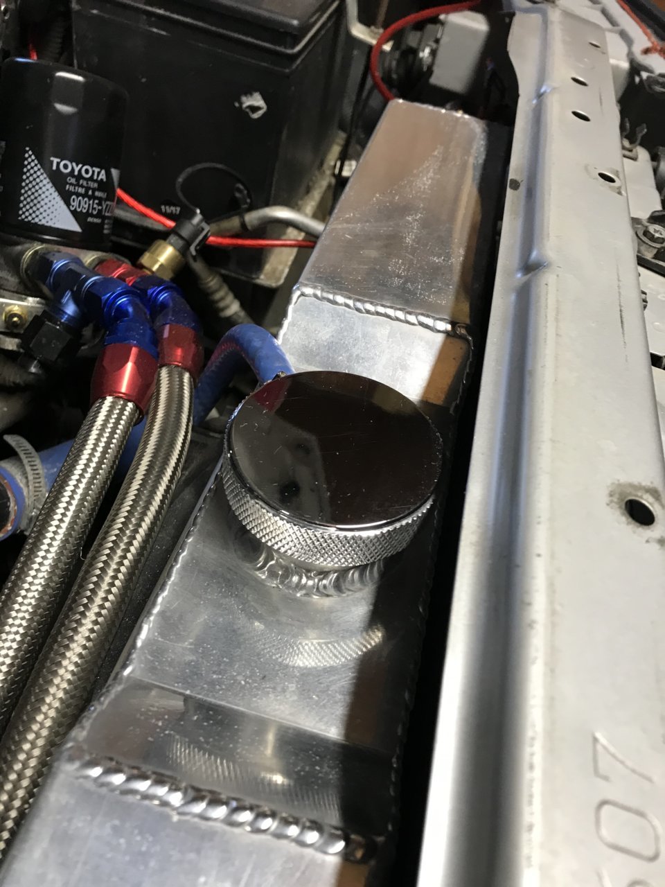

    Here's a picture of the one I bought to replace the leaky one that came with it. I'm pretty sure I got it straight from championcooling.com but now I can't find it there. It wasn't cheap, but I really like the clean look. You just have to make sure you order the right size like you say. Hopefully you are able to find it.

    Ok. Yeah that's the 2-5/8 cap. You mind measuring the cap and also the filler opening? That'll confirm for sure.
