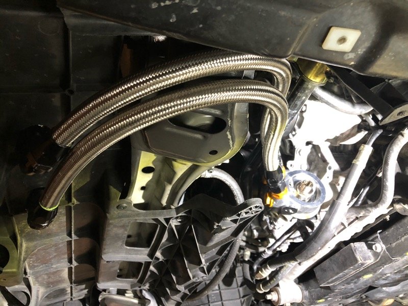

  2. Jan 4, 2020 at 3:53 PM
    Kelvin
    Kelvin Wheeeeee

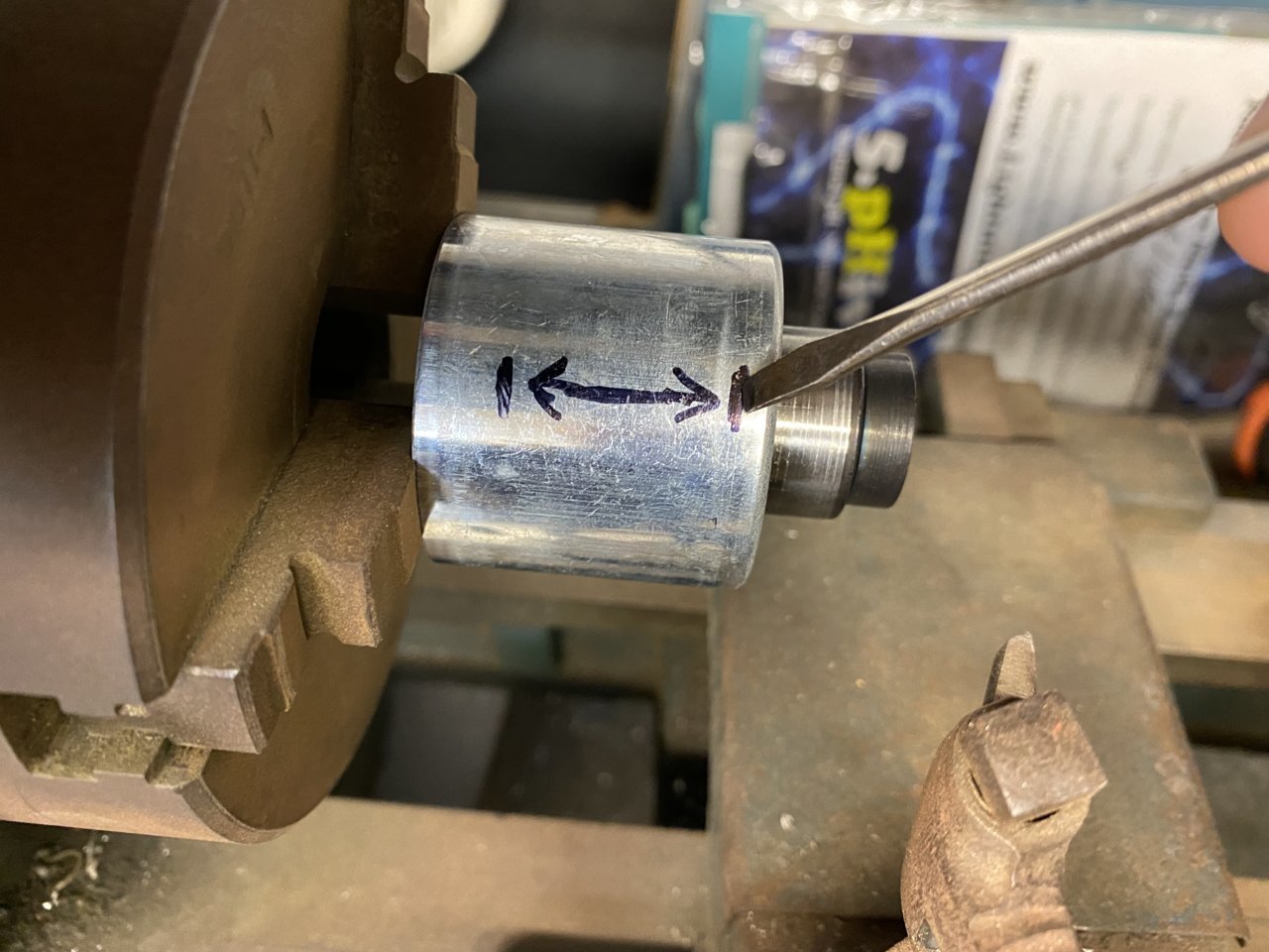

    I was trying to understand the original post you made for yours and hope I got it right. I was hoping to lessen the work my friend had to do cutting the base. Glad I'm on the right track. I was nervous when I started pressing the bearing. Just a $15 part I know! But first time doing this and I don't want to mess up the belt drive as you mentioned.
    That's what we were afraid of. We linked two together but was very unsteady. Holding the wrench steady and making sure not to slip and strip was on my mind. I have a longer double box end wrench coming tomorrow that I can slip a jack handle over, hopefully the leverage is more steady.

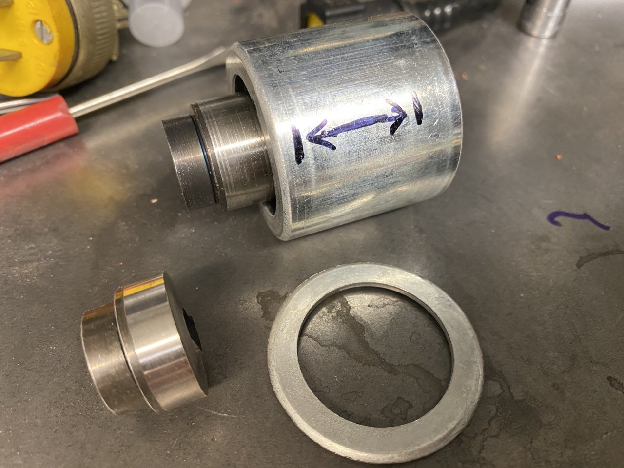

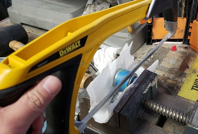

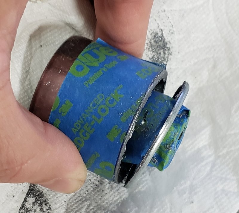

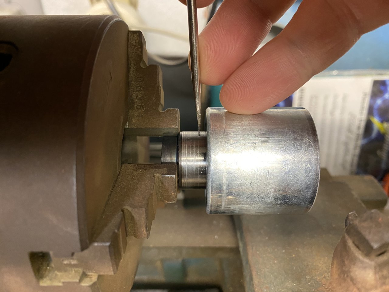

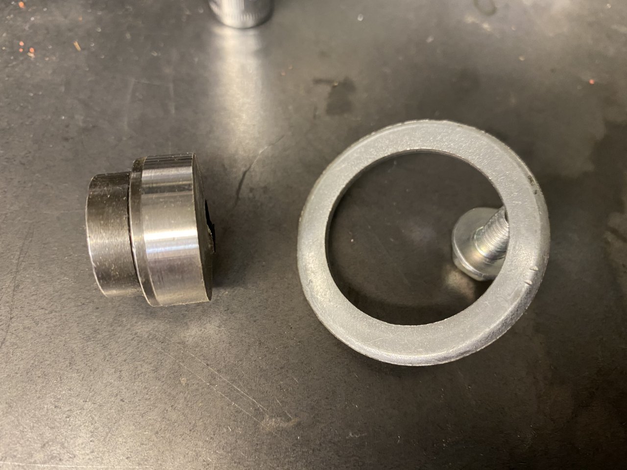

    I’m not sure what you’re pressing.
    I just trimmed the sleeve at the back of the bearing and then shortened the thick cast iron base so that the bearing was lined up with the belt.

    Maybe these will help

    I’d also considered that it may be possible to pull this off with a long 8mm stud chucked into a drill press and a cutting disk on a die grinder.

    You did a better job on those hose ends than I did. I mangled the heck out of the first pair.
    Oh well. They’re under the car anyway.

    Those are classy fittings, in finish.

    Temps were always well controlled with the oil cooler. Under 240f, 25 mins wot x4-5 heats, 100+ ambient temps.

    I took a 20 mile drive and my cooler was just mildly warm. I’ve held hot pockets that were hotter than this. I’ll try adding some harder throttle pulls tomorrow and try again.
