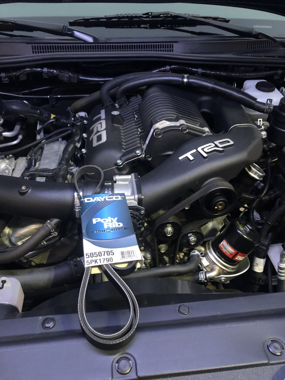

    Bought this today, I should be all set. Thanks for the help guys. Question, is there a speed shop in the Southern California that specializes in our trucks and getting the most out of our Superchargers?

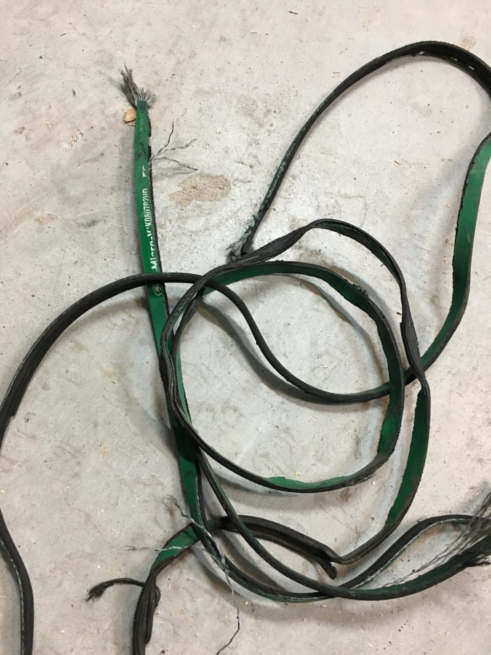

    I was off 1 rib on the water pump and it shredded like this. It bird nested behind the crank pulley. It was really hard to see. I heard a pop which was the one rib snapping off. I only saw it when looking through the fender well down the side of the pulley. I now manually spin the engine over a couple times because of this. I know this isn’t the same belt as mine since this is the SC and mine was the main. Sucks man hopefully it didn’t shear anything else along the way.

    That’s why I’ve never been to keen on slicing a belt.

    brother. if im reading this correct why did you cut off 3 ribs?? i cut one. could be the reason. glad it didnt wreck things.

    he bought the K8, eight ribs. You probably bought the K6.

    ahh. i figured i misread.:hattip:

    unless you recently pressed on a new pulley or new tensioner then I doubt your pulleys are out of alignment. Double checking the alignment of the belt on the pulleys. I doubt cutting the belt caused this. The ribs run parallel and unless you were 12 beers deep with the razor blade it is not likely you cut a rib. Misaligned the belt, more likely.

    That is a CLEAN engine bay - very nice! :cheers:
