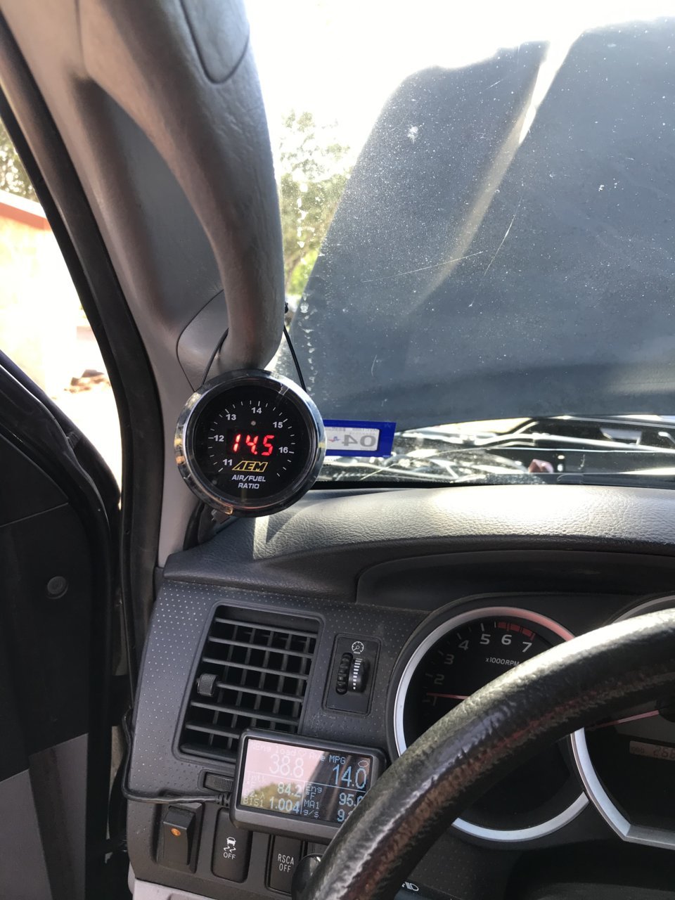

    Well hell. I somehow managed to get a faulty AEM gauge brand new out of the box. I swapped out o2 sensors with one I knew was good, still had the same incorrect AFR readings (showing 17:1 or leaner all the time), so I took a gauge out of my other truck that was exactly the same and it worked perfectly. So effectively that eliminates the o2 sensor and the new wiring as the issue.. Am I missing anything or does it sound like the gauge itself is the problem? Anyone ever heard of this with the digital AEM gauges?
