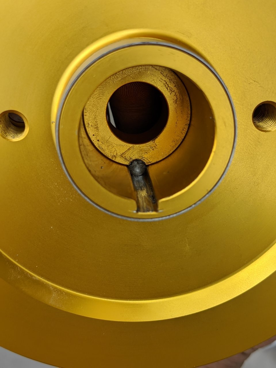

    Hmmm... S/C pulley isn't seating into the crank pulley. All I did was swap dowel pins. Did you guys install one at a time or press/assemble both together prior to installing in the truck

    Someone else, @12TRDTacoma I think, filed the inside edge of the hole slightly. I did that and tapped the pulleys together with a block of wood and hammer and it went alright.

    I reused the dowel pin and then pressed them together on the bench. I did this a couple of times to ensure a good matchup. I also applied ample multipurpose grease on the SC as well to help them mate up. I installed the crank pulley first then for the SC by hand and confirmed complete seating with a soft mallet before hand tightening the bolt with a ratchet prior to any power tools.

    Thanks. I've got both lubed up with GP grease already, and have the bolt just holding them together. Was thinking of trying some light taps with the mallet. Didn't want to have to take the crank pulley off again to file it. Lol

    I referenced install of the two pulleys in a post in the GB, but what these guys said is spot on. It requires install and separation a few times off of the truck. File the key hole ever so slightly if the fit is way too tight. You can always do the block of wood/ hammer technique, but that should be done once you have a line up and have them ever so slightly inserted into each other.

    Yeah had to pull the crank pulley to file it down. Having to take a lot off.. kinda disappointing tbh.. gotta keep up with those in-process inspection checks... :facepalm: this would not fly in our shop. Lol

    Got it. Has a little play but once bolted down it should be good.
