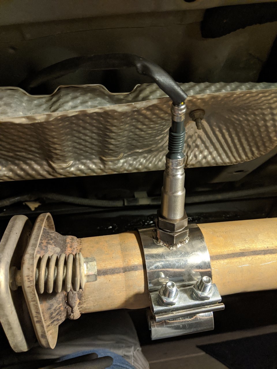

    @jpark4 not sure if you were still looking for this, sorry for the late reply. I used the no weld bung. Kind of a pain to drill with the exhaust still on the truck, but I made it work. Make sure you vaccum/magnet out all the debris when you're done. I did put wire loom on the harness after the pic was taken. IMG_20200425_005650.jpg

    I was reading instructions for drilling into a diesel exhaust, and they reccomend turning the truck on and letting it idle while drilling. The pressure will blow all the shavings out towards you.

    If you're doing it post cat, with that adapter, don't even worry about the shavings.
