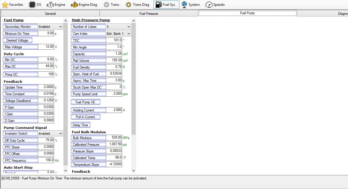

    Not that I disagree with you, as I've questioned the way the Coyote community does things at times.. However, I can say that the fuel system, being a return-less setup with a quite complex control algorithm is not simple to tune. Simply swapping a pump in these cars has to be adjusted for in the tune, as increased flow will result in pressure changes. That will throw off the entire fuel model since these cars are in closed loop all the time (even when in PE).
    What the idea is, as I understand it, is to keep the fuel system under "normal" conditions and in a "stock state" to reduce the need to have to dig into the tune the fuel pump. It's simply easier to adjust fueling under boost when the boost-a-pump is raising voltage to the pump than to compensate for a larger pump(s) to run properly.
    Here's a snapshot of just the tune parameters for the fuel pump in my Mustang. There's more tuning available for the fuel pump than for the entire 1GR calibration..

    The base kit is supplied on OE fueling it seems from what's been talked about openly thus far. They used OV's software, but their own in-house calibrators developed the tune.
