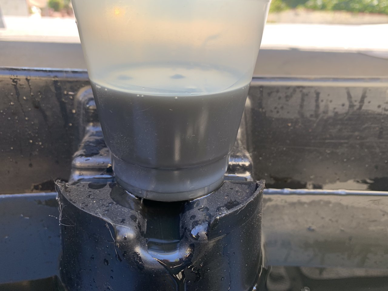

    My front diff was dirty like that from the break in period but after the second one it was as clean as the transfer case
