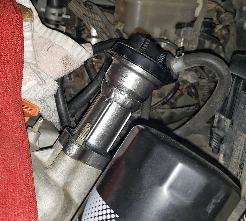

    Ready for the weekend. Shortened oil neck and and coolant ports in.

    If you welded that, :bowdown:

    (Un)fortunately (not my work), my friend's race shop did it. I only have a mig at home. Wish I had more space and time at the moment! 20201105_165302-02.jpg
