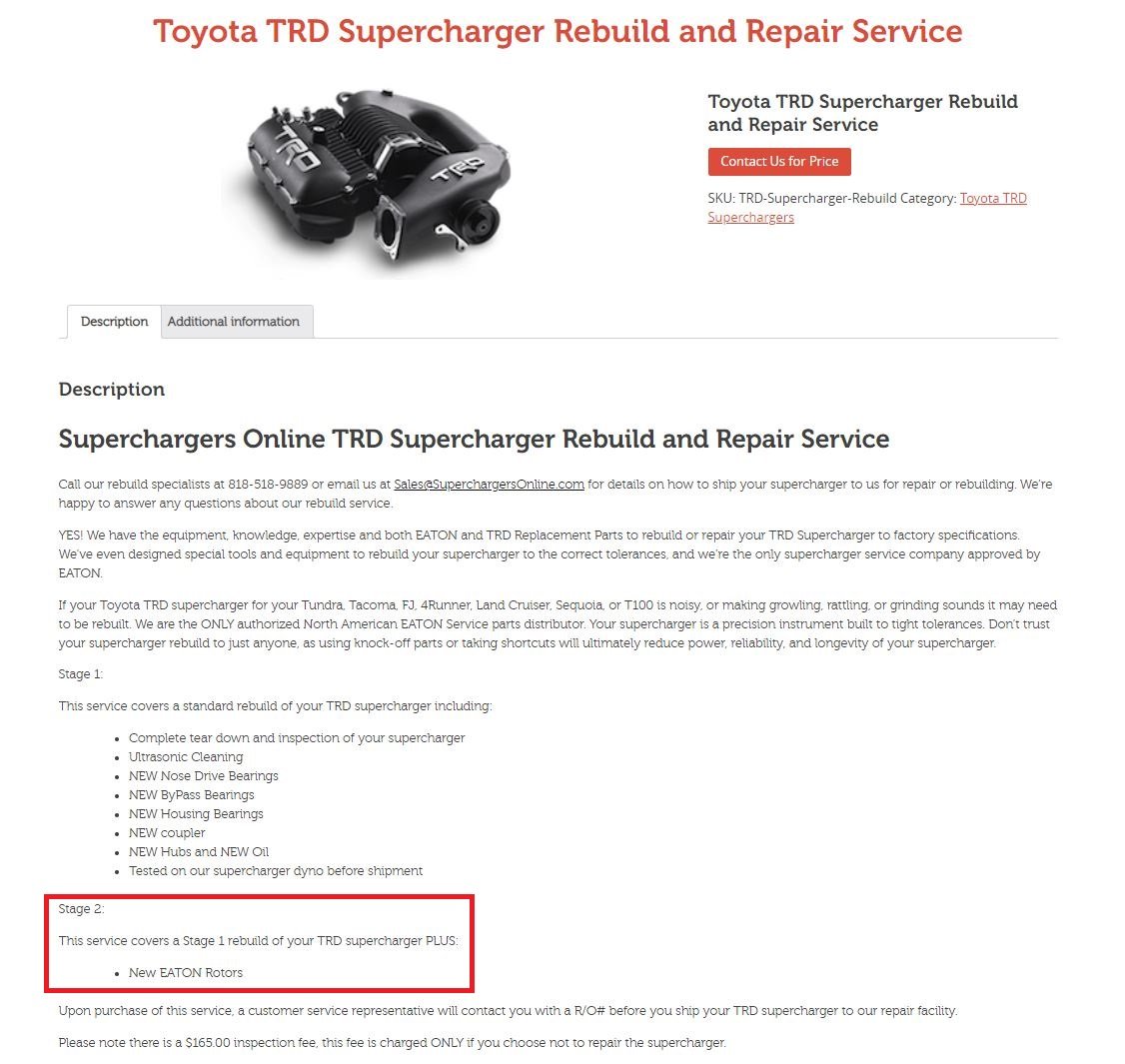

    Are they just new rotors that are the same but not worn down?
    Or are the New Eaton UPGRADED rotors? How are they different?

    Looks like it doesn't specify if it's TVS rotors or not.
    I emailed both Magnusson and Superchargers Online so we'll see what the response is. I referenced this thread and our rabid group here.
    A little research and I found that at least a few Mustangs had TVS rotors installed into their M90 superchargers and that post that @Athlaos made was a TVS rotor install on a Tundra charger so the possibility seems there.

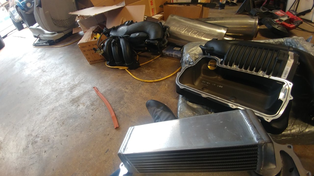

    The way this SC body is cast as a mostly one piece unit with thin wall thicknesses makes it so there is very little material that can be removed and it is difficult to do at that.
    I did some DIY mild porting and smoothing but when doing research on it I could find no pictures or much info on porting our blowers whatsoever. Check my build thread for more detail and pics.
    That said, Steigmeyer ports MP90's and I believe they actually weld material on parts of the body to allow them to remove material. You would have to contact them for info because the MP90 isn't listed on their site.
    http://stiegemeier.com/
    These other places might do it as well but you would have to contact them.
    https://www.jonbondperformance.com/product-category/supercharger-porting/
    https://zzperformance.com/products/ported-m90-supercharger
