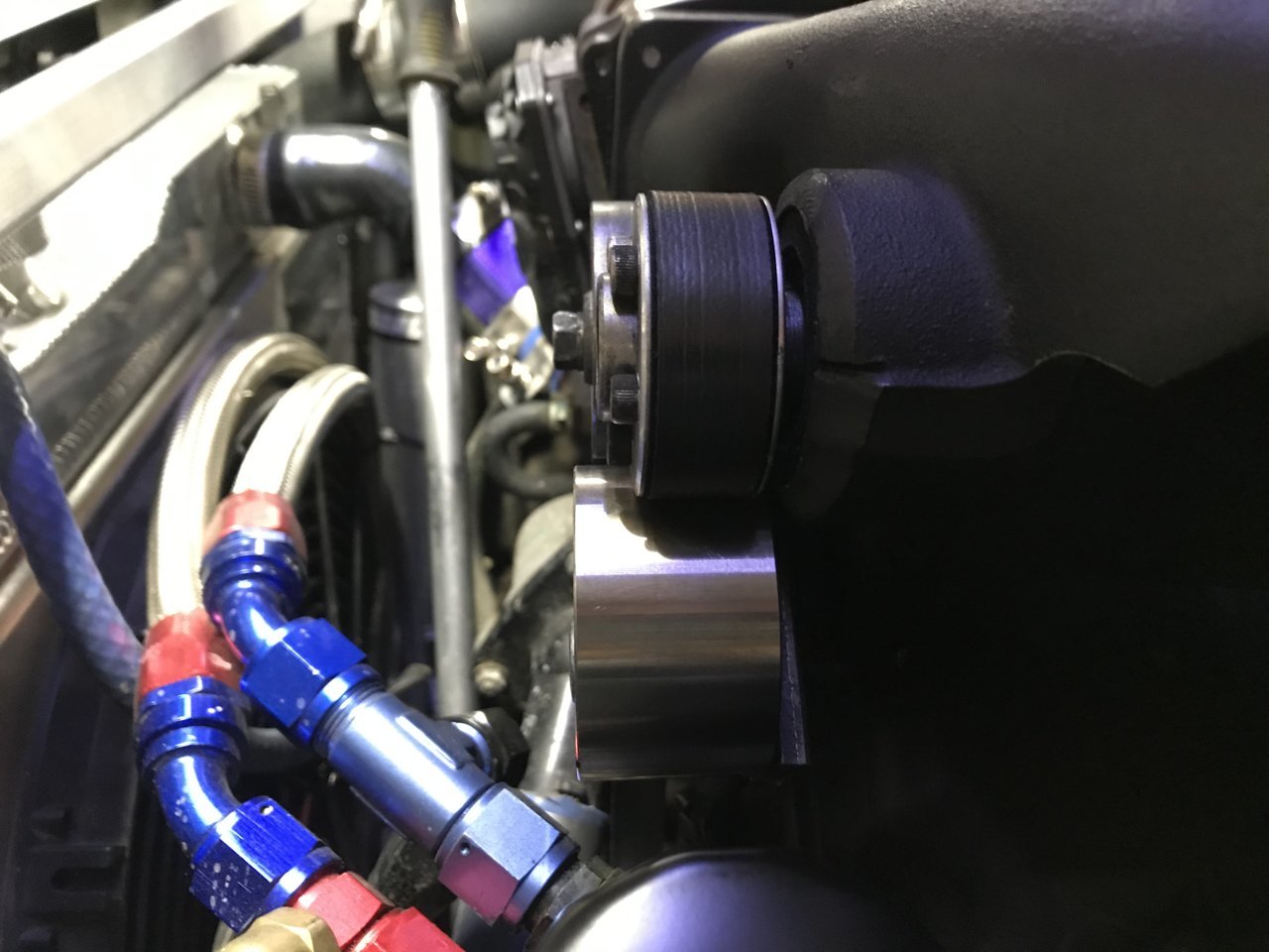

    thanks for that info. Very helpful. Very tempting to even just drop the pulley down to a 2”. Even that would make a difference. Question is, how much more can I cut back the snout? I’m worried if I cut that last 2mm off then I will do damage.

    I actually cut the snout way back - with an angle grinder - then filed it to look nice-ish and re-painted it. The problem is the snap ring underneath came out. But I haven't had any adverse effects from that happening. I did have to put about a 1/4" spacers on the idlers though to make everything line up - you'll notice in my picture the hub doesn't quite go all the way on (because you can't cut back the snout enough). I think the limit for snout cutting without totally hacking it off is around 2.2".

    Yeah that was my main concern was that snap ring.
    I cut mine back with a die grinder. Took a while but worked well. I’ll send you a picture of it soon to get your feed back on what I can do. My father in law is a metal turner and he made the 2.5” pulley for me. So if I can go smaller that’s what I’ll be doing. I’ll flick the photo over soon.

    Well considering I removed the snap ring and have been running for two years with no ill effects... I’m not even sure why it’s there. I don’t want to recommend you remove it... since I don’t know what the engineers wanted it there for, but maybe you can.

    That seal is pressed in pretty good. Guess that snap ring is just secondary protection from the seal popping out.
    As for the snout being cut down completely. I don’t see a problem since the bearings are actually supporting the shaft.
