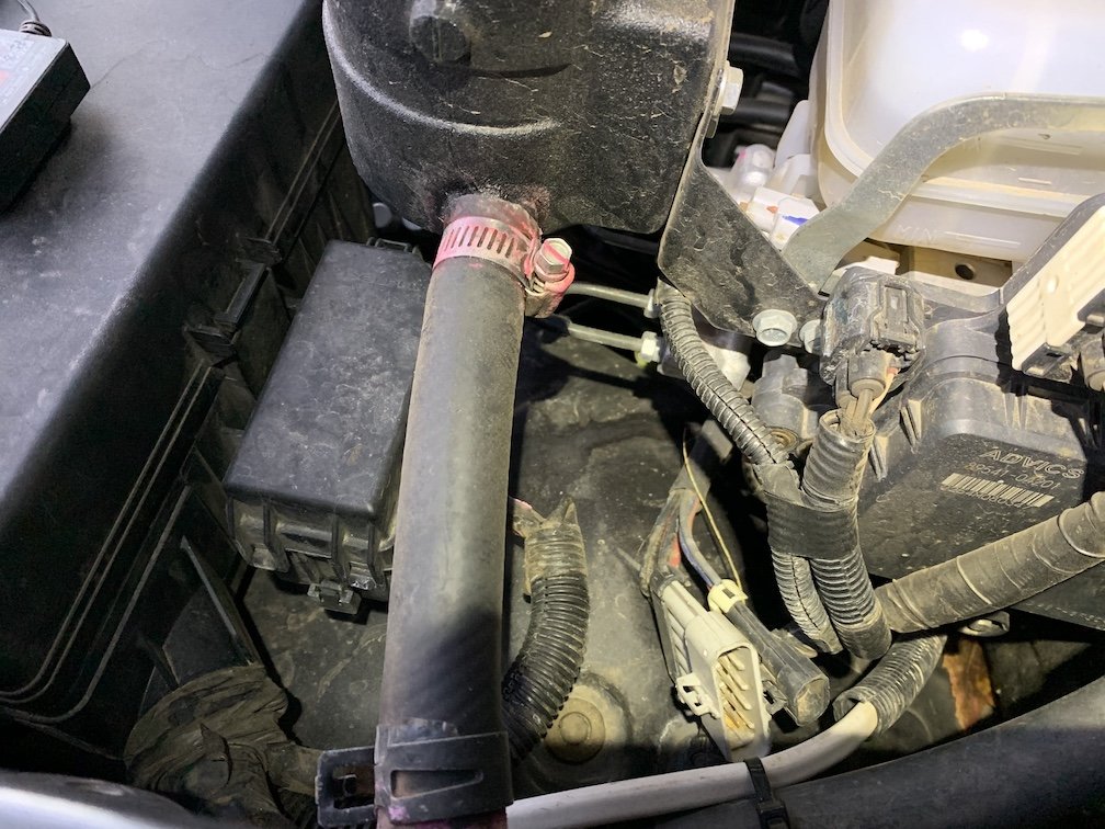

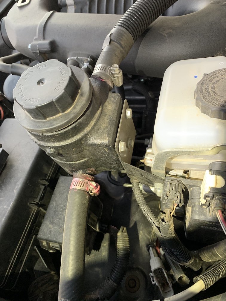

    Dang it. I did the "fix" for this where you cut a section of hose out and put on the correct size I.D. hose on the coolant tank and a brass coupler to reconnect to the larger I.D. supplied hose. Yesterday when I was changing the oil, I noticed that it is leaking again. When my @mightytacoman coolant overflow tank shows up, I'll be putting in all new hoses and rewiring the 12V power for the pump to a circuit that isn't the emissions pump.

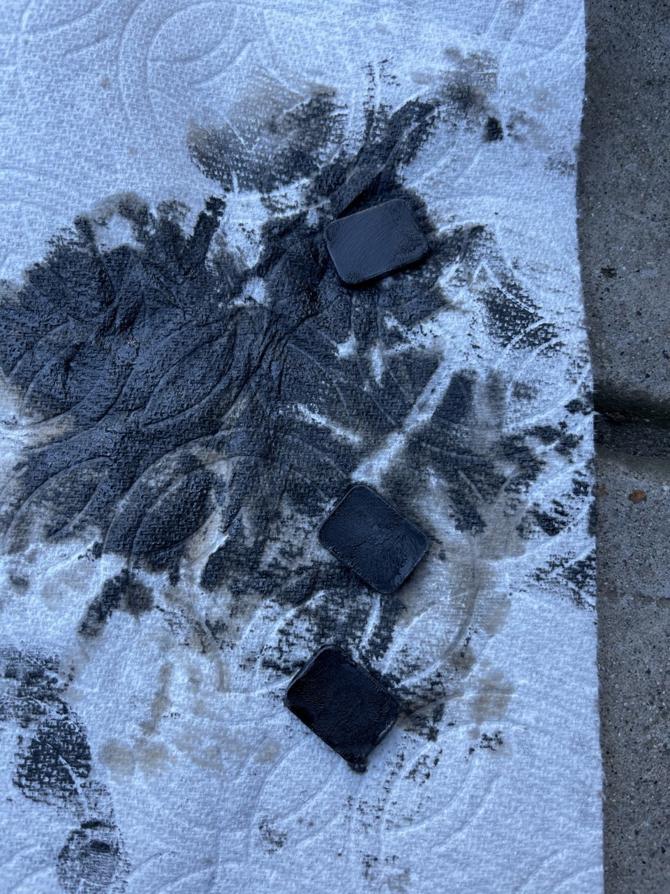

    Sanity check. First time pulling the trans pan. These sit in the bottom right? Just making sure. Not a fan of semi loose parts when you drop a pan. 3 magnets which make sense.

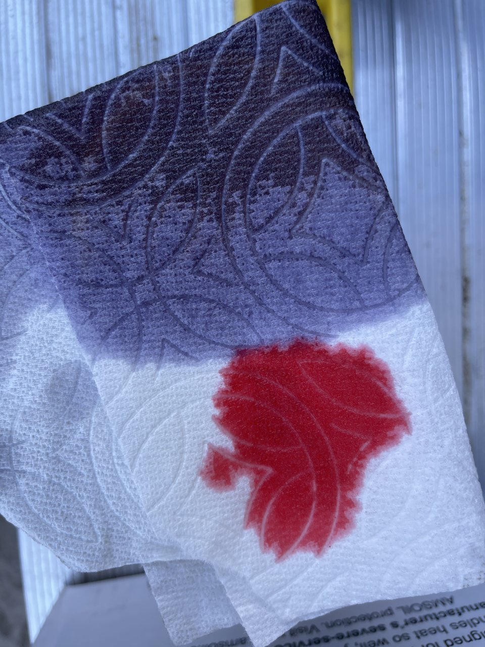

    Def needed a drain. Old vs new (from the bottle) Amsoil signature.
