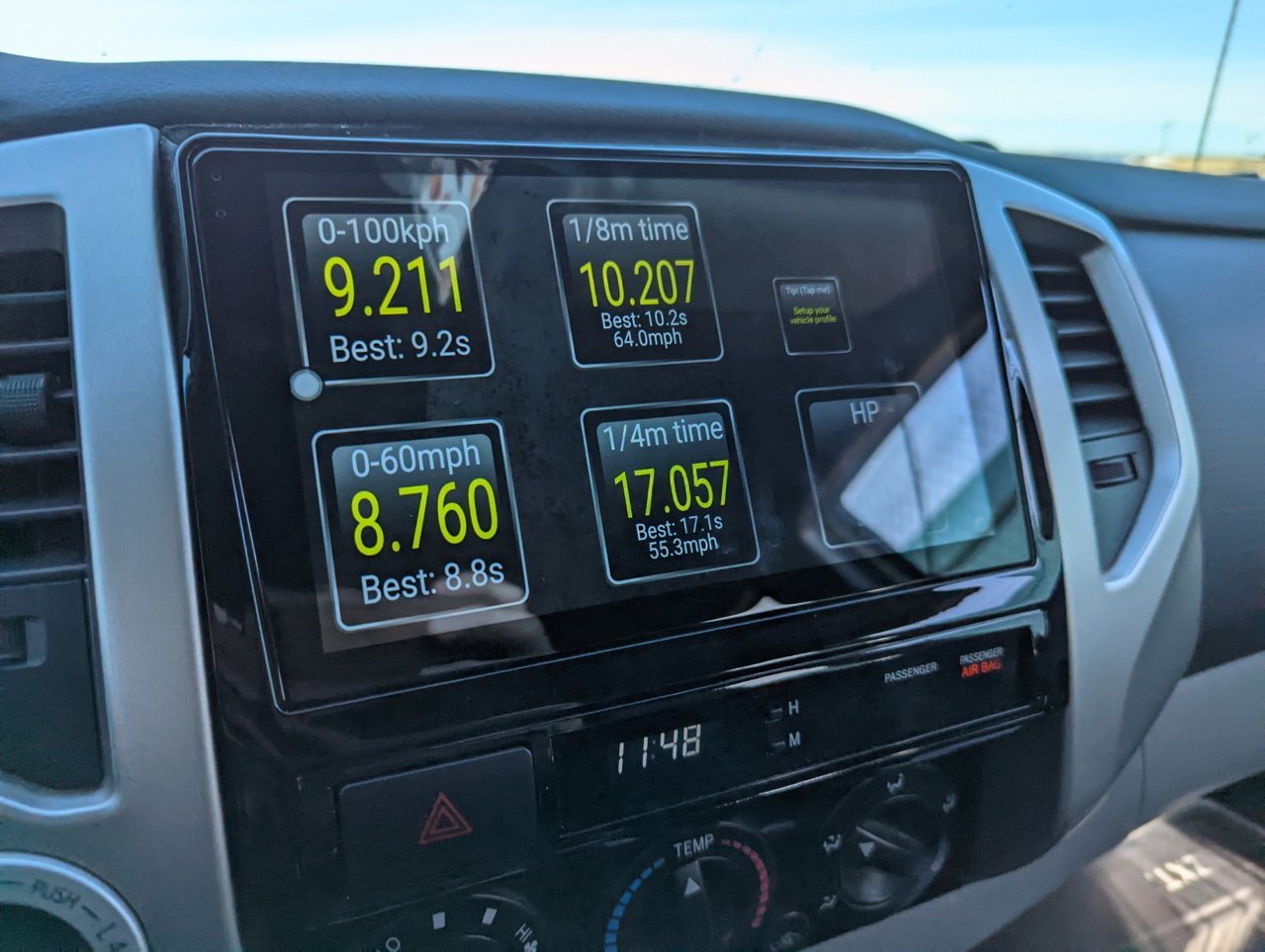

    Tried a 0-60 run. Haven't inputted vehicle profile yet so not sure how accurate, but close enough. 8.7 seconds sound right?

    What’s your tire setup look like? At least profile pic doesn’t look too heavy. You do need to adjust the speed offset if your running larger tires. I would expect that a little faster. I’m prob aliens that and my trucks grossly overweight.

    285/75/16's. I used hptuners to change it but I think it is still off. Getting those street side radars is maybe 1-2 mph off, but 60+ is 5-6 mph off. Not hauling any weight, just the hidden winch bumper up front and a few steel skid plates

    Gotcha I was referring more to the BT module. Odbfusion there is a vehicle speed offset. I played and with it until gps and speed was similar but if you changed it may be similar. I thought we couldn’t change it with HP. Interesting.
