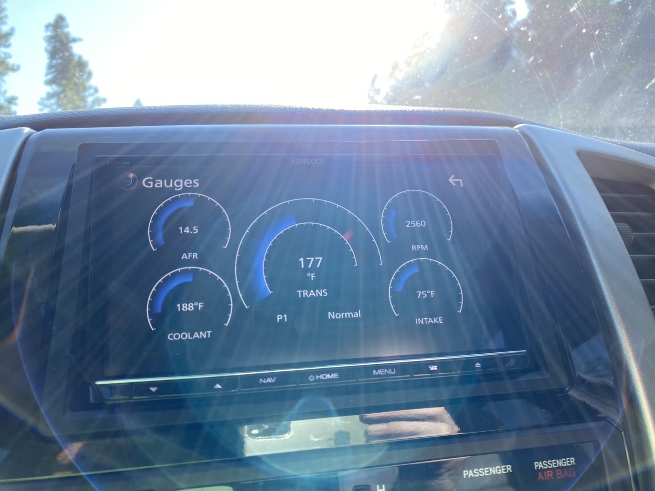

    I went ahead and ordered the 2.8 quick change as a starting point.
    Is the OBD data for AFR sufficient (I assume that comes off the O2 sensors) or should I look for a different solution to monitor it?

    You wont be able to see the lower AFR number you will want to monitor for the S/C. Plan to get a boost gauge and additional AFR or 2 Sensors. I think the stock ones wont read below a certain point but forgot what that was.

    12.9 AFR if I remember correctly.
