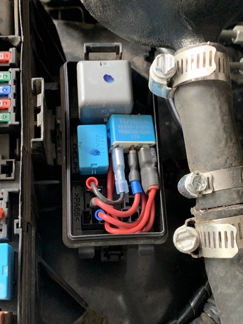

    AFE stage II intake, APR X1, URD 70mm Throttle Valve (ported and knife edged), NST intake manifold spacer, URD spec U headers, Denso IKH20, URD fuel pump, APR fuel rail, URD Y pipe, URD spec u catback, lightweight water pump pulley, Greddy sandwich cooler plate, Earls oil cooler, IPT valve body, FJ TRD shocks, Cusco front and rear sway bars, Energy Suspension rear track rod bushings and rear link bushings, Carbotech pads, Stoptech ss brake lines, Stoptech slotted rotors, Motul 600 rbf, Limited Grill, Painted hatch cover by me, Painted valve covers by me, Cobra CB, TRD rad and oil cap, Escort 8500, Autometer oil psi and temp gauges, AEM wideband afr gauge, Flexpod, Pioneer 400w speakers.
    Put mine here for a cleaner look

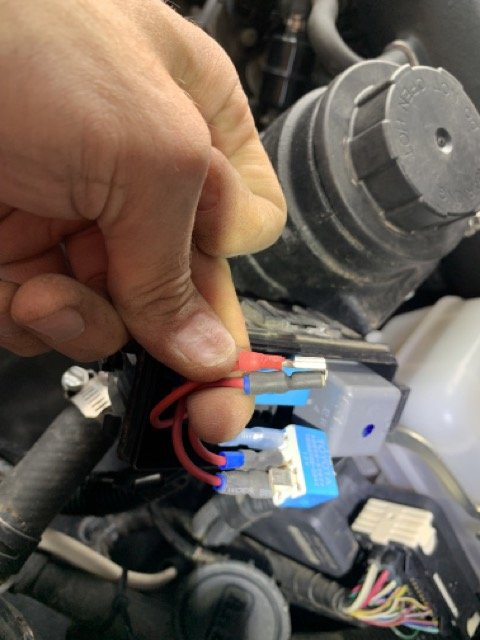

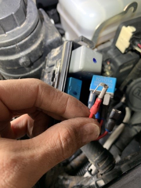

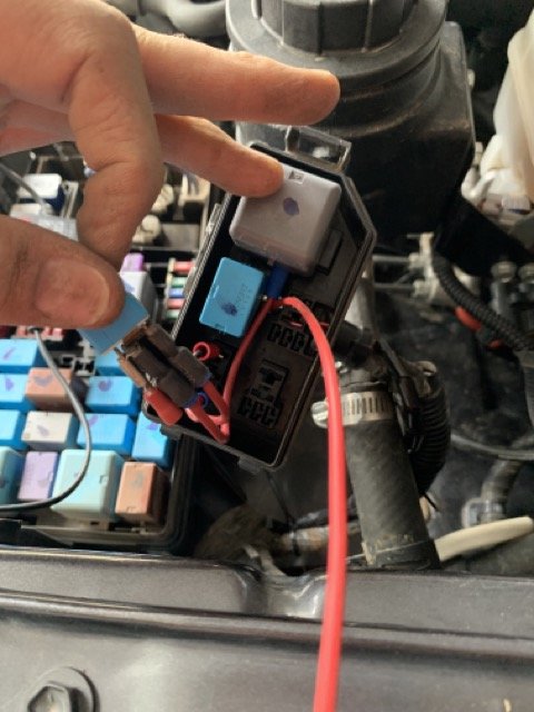

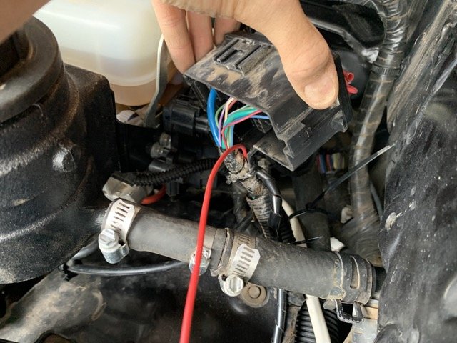

    Alright, I finally moved my supercharger tap off of the 10A EFI fuse as shown in the install manual to the output also tapped for the @nd4spdbh 's anytime fog light mod.
    Tested with a few key OFF>IGN cycles and everything tests out fine. I'll be happy to not hear this kick on dozens of times in the middle of the night when camping and drawing my battery down even more. I have a single 27F AGM powering my fridge when the truck is off and I don't need to be wasting any extra power.
    Photos and instructions in my new "build" thread…

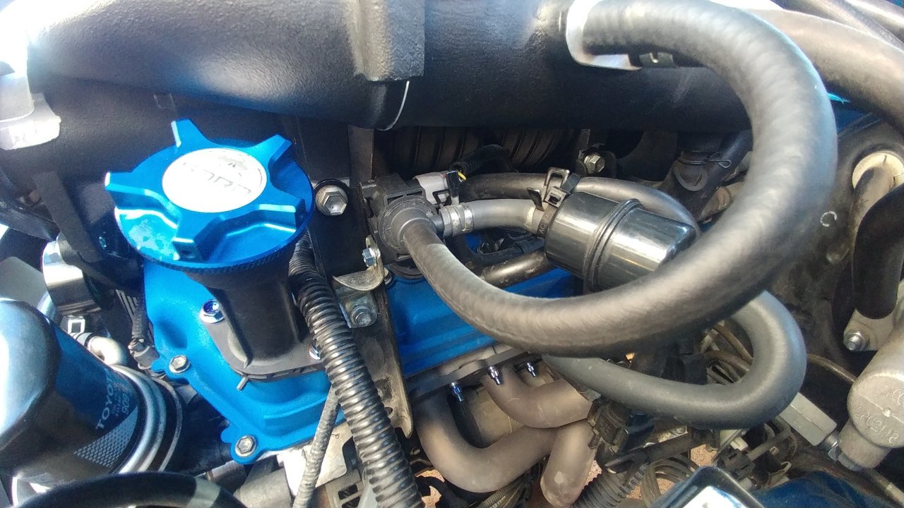

    Yea definitely cleaner and pretty much around the spot where mine is, except the purge valve is zipped tied on the fuel line. Is that the bracket that supposes to hold a harness that you bolted down too?

    Probably. Don't remember but I modified it by grinding it and rebending it to conform to the support bracket. It would go unnoticed to 99.9% of people but I like the cleaner look.

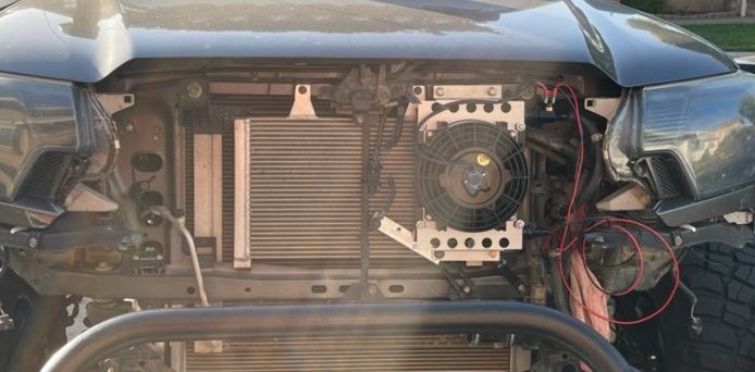

    So just thinking out loud here after doing some research.. hoping you guys can provide some feedback. Regarding my overheating issue, I'm starting to think it may be more to do with the Trans getting hot than anything... The Rad and HD Trans cooler from Mishi is looking pretty good right now.. but I havent had time to check anything else yet either. I plan to check the fan clutch this weekend real quick. I'm just trying to figure out where to start diagnosing before throwing money/parts at it.

    Head Gasket? I hate to recommend that, but its worth investigating if you're having an over heating issue. I would think the trans would have to be red hot for you to see it in the radiator.

    Taming the Trans def helped it big time. Now I am mainly getting heat at standstill but the Trans is feeling much better. Going wth a Cooler and Fan is first step I would go with. The Bigger Radiator for the engine is a nice to have but I would go with the trans cooler first as someone that suffered big heat issues. But if engine is overheating @DocME could be right. I never had the engine overheat.

    well, I guess that's kind of where I'm hung up at. Wouldnt high Trans temps show up in engine temps as well? Doesnt the trans cooler pass-through the Rad? I also have the towing package cooler, but I'm just thinking if that the Trans is overworked and getting hot, would it affect the engine temp readings and or not allow the engine to cool if it cant keep up? I definitely want to get the upgraded HD Trans cooler.. I'm also just trying to understand the entire system in general.
    I havent experienced any loss of power, smoke, loss of coolant, etc.. so headgasket isnt on the top of my list.. but yeah.. its always in the back of my mind.
