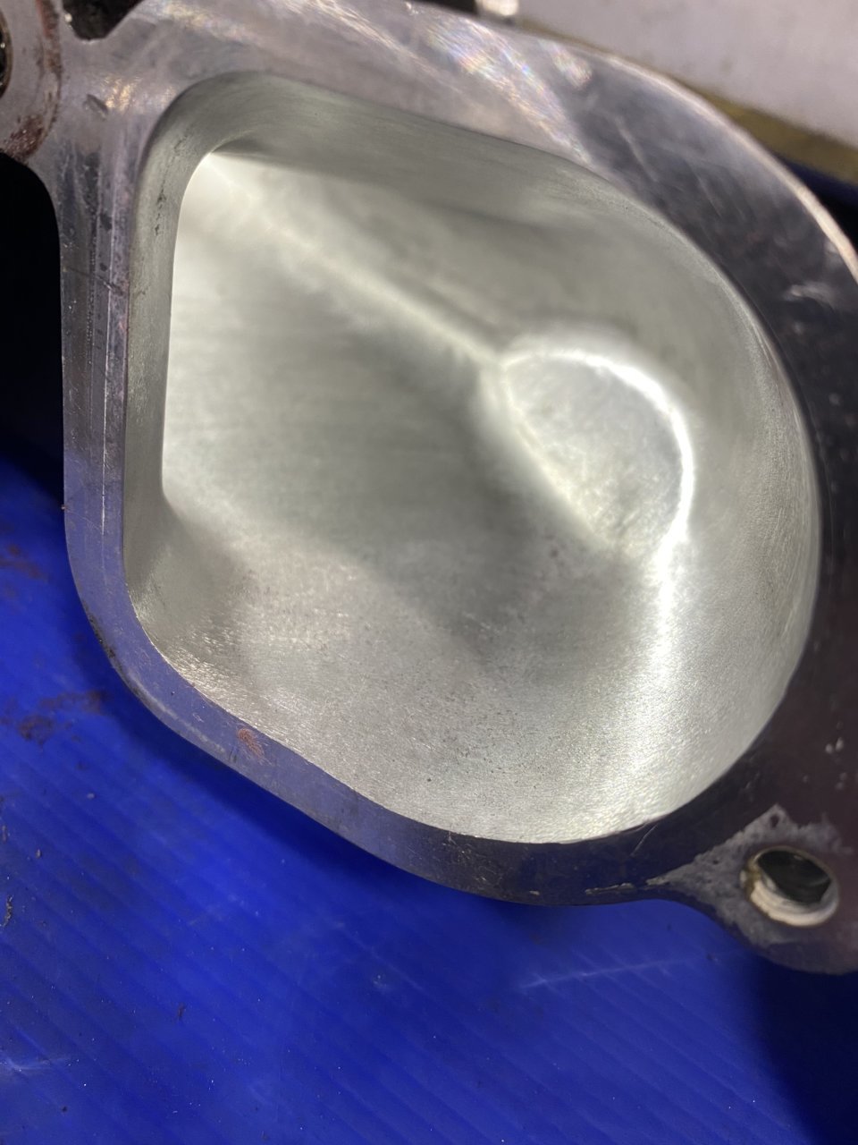

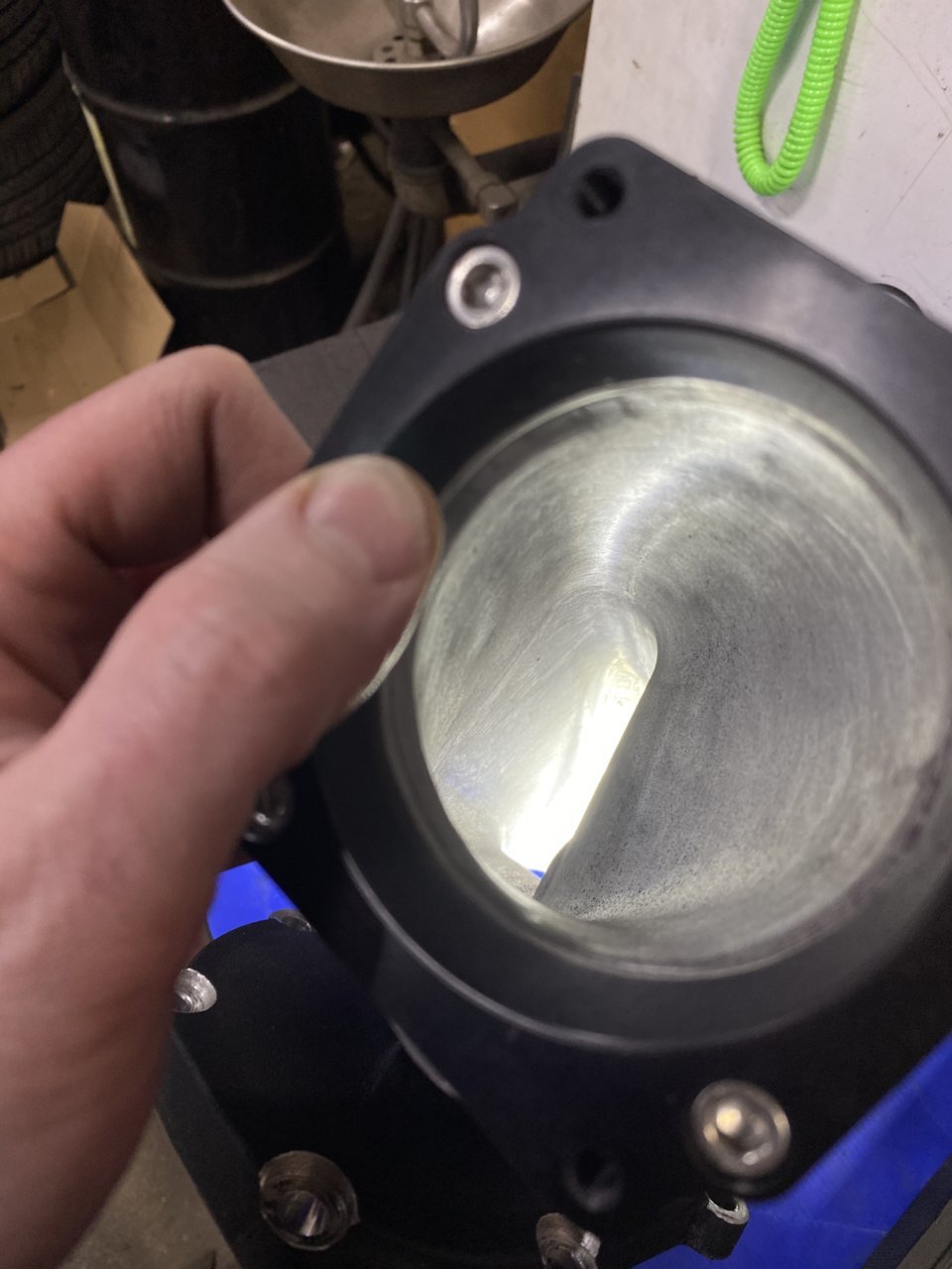

    Nice! yah seems obvious once its together. basically smooth the transition between the 2. The though of cutting the blower just a bit unsettling but prob not as bad as it seems.
    Totally I figured alone it is not much but tacked on with the rest its going to help. the 3 big things, Manifolds, Y, Fuel Pump are the ones prob holding me back right now. I mostly have it just need to get it done.
    Nice id like to see that. I guess the one thing I did not think about was needing a bigger connection at the intake to the TB. I Also have the T4R intake and MAF but we had issues before tuning it with @JustDSM but it was not really needed at the time. Likely getting to the extent were we would revisit that. I like the idea what your seeing it.
