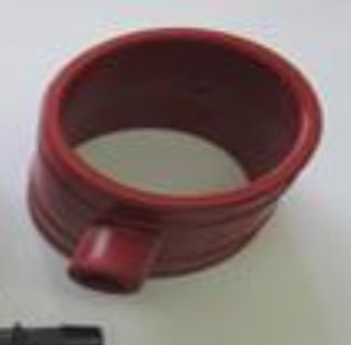

    Does anyone have a new coupler from the TRD 4runner that can measure and tell me how big it is and how flexible it is when new? Maybe someone that did not do the conversion yet? I have one on my truck now but its hardened and out of shape but I recall it being softer before. I was going to order another and give it a go but wanted to see before I do.
    upload_2022-10-27_16-48-49.jpg this would be the newer 4runner/FJ one, not the Tacoma one.

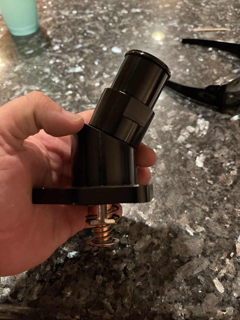

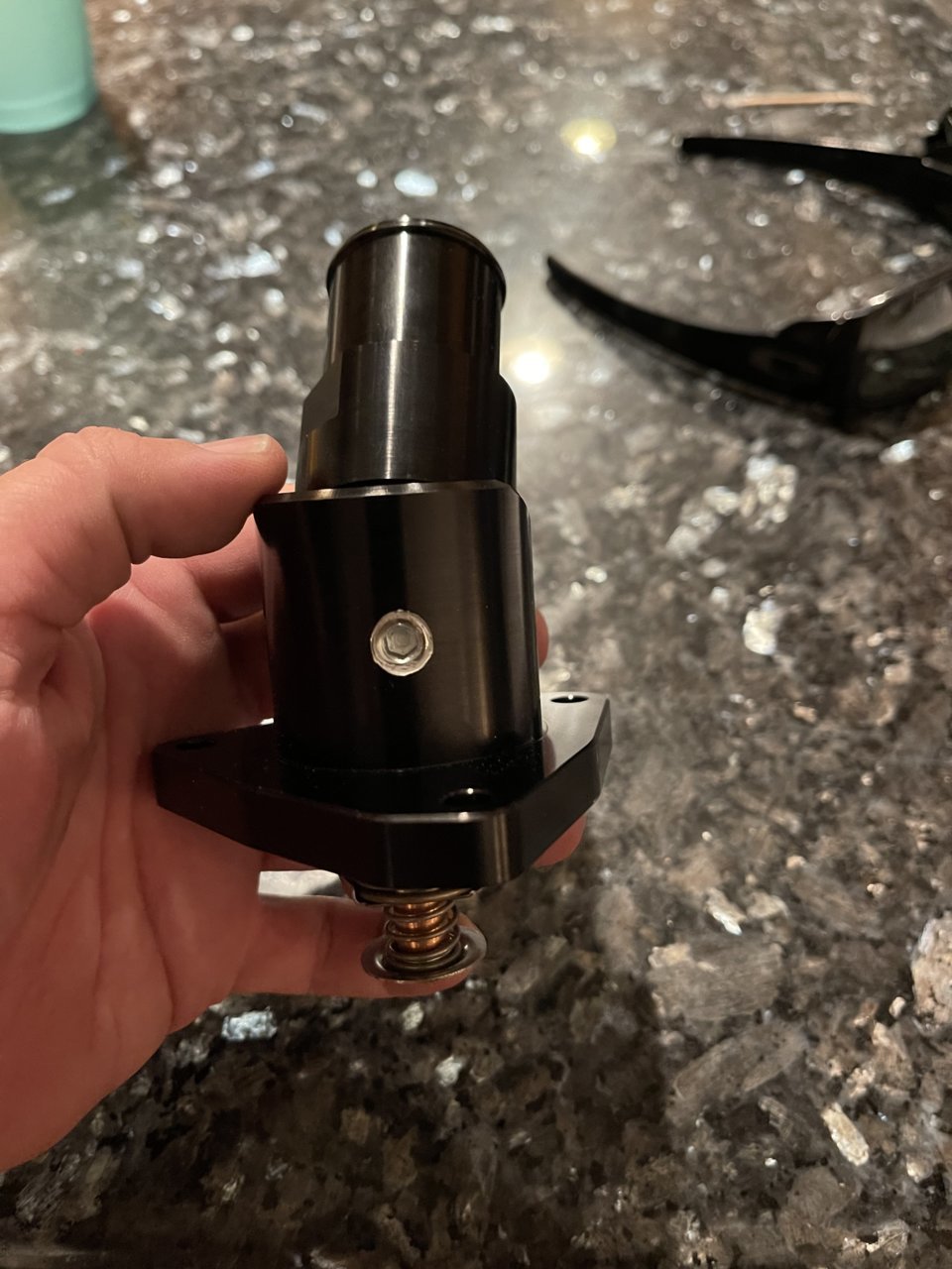

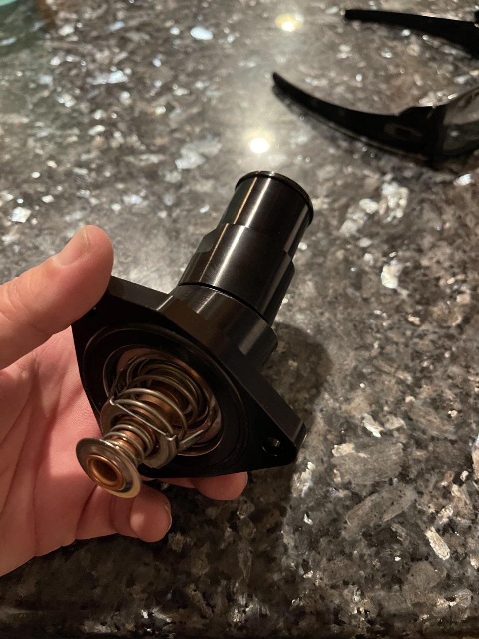

    Billet housing arrived. Maybe this will give me an excuse to finally install the rest of my HPS hoses.
    BCA5BDFD-1B90-4A08-8C9E-C72A27B3B707.jpg D8CFFD9F-9EDF-4F45-96E3-939F513D4D24.jpg E1204A4D-A837-481E-ADBF-64A0EFFB604A.jpg
    rheath08, Norton, jamesepoop and 2 others like this.

    Perfect time to freshen all of them up at the same time. Mine arrives tomorrow. :woot:

    i got mine yesterday. dont know if my urd 170* stat will fit. if not ill get the motorad 180.

    Might not as it's for a gm engine I think it's a 8100 vortec?

    believe youre correct on the 8.1
    i just dont want any guessing so 180 it is.

    I got both. Can also and cross reference the t stats too with the part number. Other brands might make 170°

    Did you not get a t stat with it? The one that comes is a 180 moto rad.

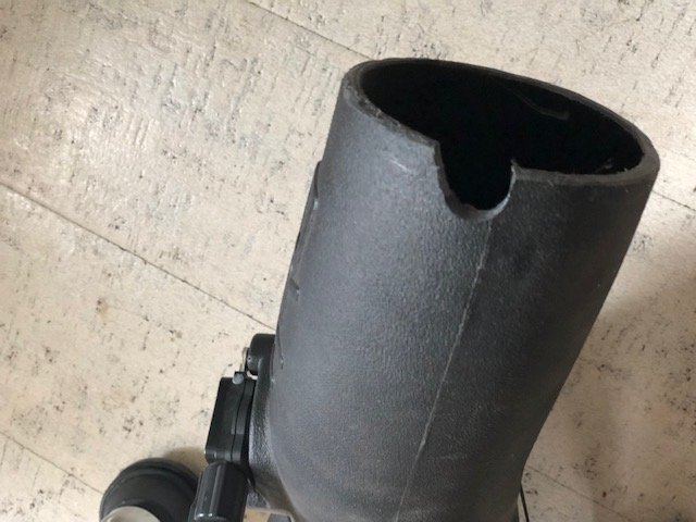

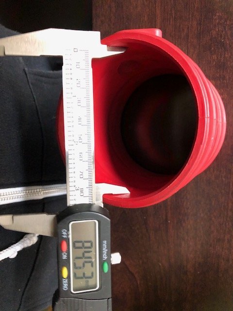

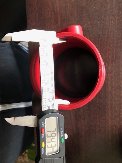

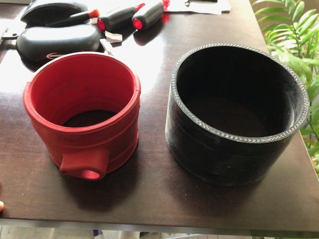

    Theres's a whole thread on this topic that had part numbers and measurements but I can't find it. Maybe it's just buried in this one.
    Here's the Tundra intake. If I had to guess its 79mm / 85mm. I did not try to find a matching replacement due to the vac line. You'll need a small extension tube as the Taco location is different.
    For the airbox side - 1 x 4.5" Silicone Straight Coupler, Black (SIL000353) from siliconeintakes.com. Was only $11 when I ordered.
    New MAF has different plug, of course. I bought a couple pigtails and made a new harness to keep stock harness in tact. I can't find part numbers but I'll keep looking.
    I trimmed my tube at both inner lines and then put a notch to get around the vac line in coupler. There wasn't really enough room to use the stock red hump connection with the S/C and the URD adapter.
