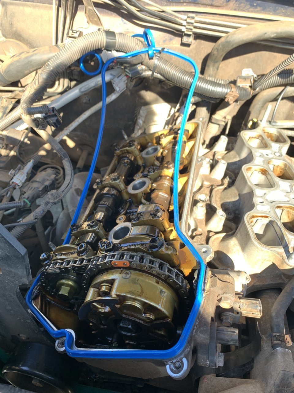

    Here's a pic of mine, idk if it helps. i don't remember if that was before or after install of cam gear, but I'm thinking maybe before

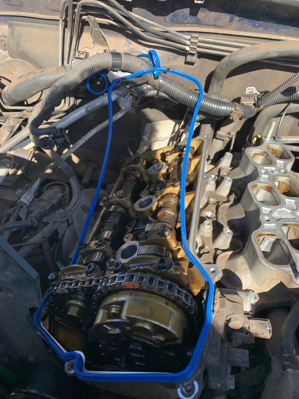

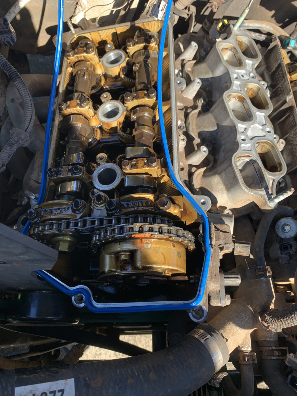

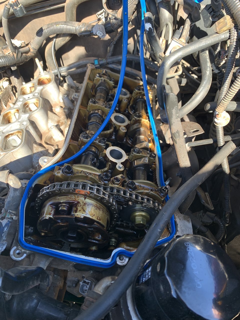

    Saw that thread before, realized pics were buried and was hoping someone could just see mine and send a nod lol
    But to close this out, page 45 or so on that thread finally had a good pic. I believe my pics show an engine in time (in the lucky link color lining up config).
    scootter82 likes this.

    Looks similar to mine. As long as you did one side at a time, I don't see the chain having any issues with slack. Just make sure you installed the exhaust cam gear with correct keyway orientation since it only goes in one way and the markings are straight forward.

    Thanks bro, yup, I put front in the front and it all seemed cherry to me, just wanted second eyes on to make damn sure it’s as good as it could be.
    much appreciated! Will button up tomorrow and see what fuel trims are with stock air/fuel compliments/stock ECU file loaded. Taking bets on whether my stubborn -20 FT readings from idle to 4K across multiple tunes with 2 different injector sets stick with the stock! Haha

    Everybody gets all caught up on the chain markers having to be all lined up for TDC on these exhaust cam gears. And that’s where the problems usually happen on these swaps cause you focus on the markings instead of TDC. As long as you are at TDC regardless of chain marking positions and swap that top key to the same chain link as the existing top key you are good to go. As for finding TDC there is a indicator at the crank to know. Far more simple this way.

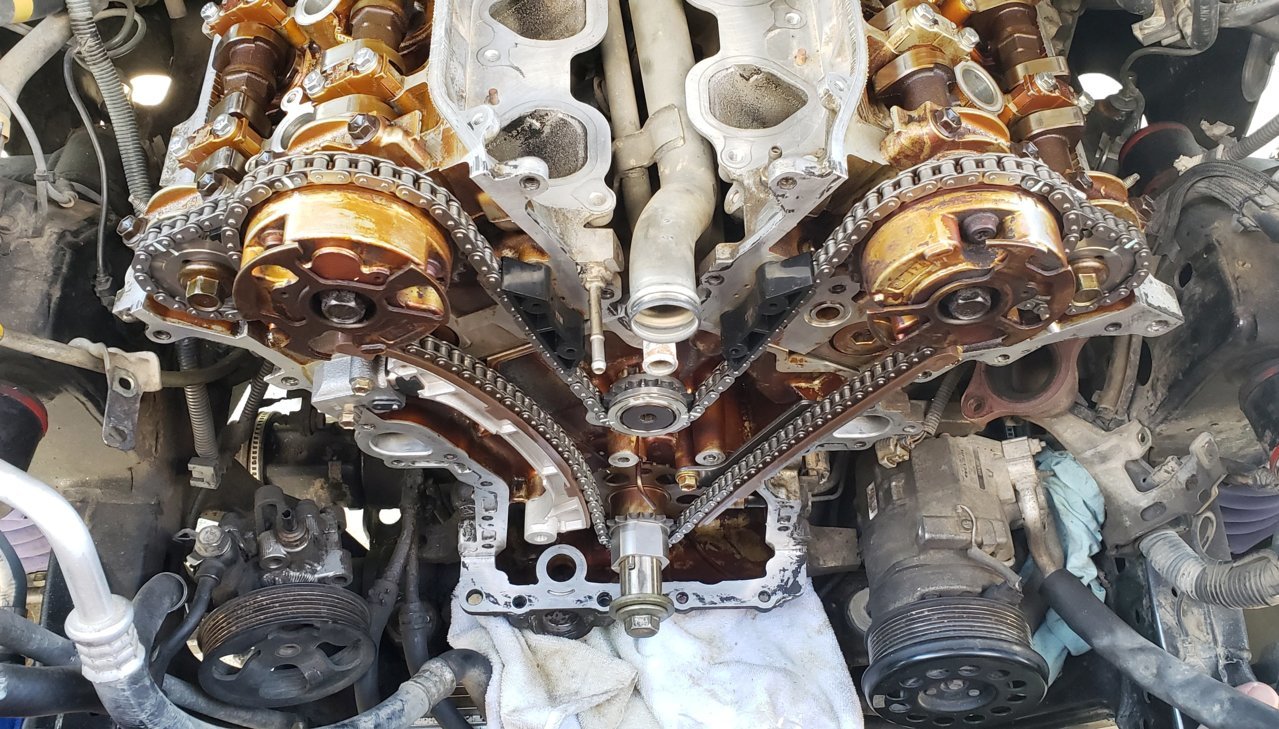

    I love pictures like this.

    My back thanks you! Anybody that has worked in the engine bay knows the pain.
