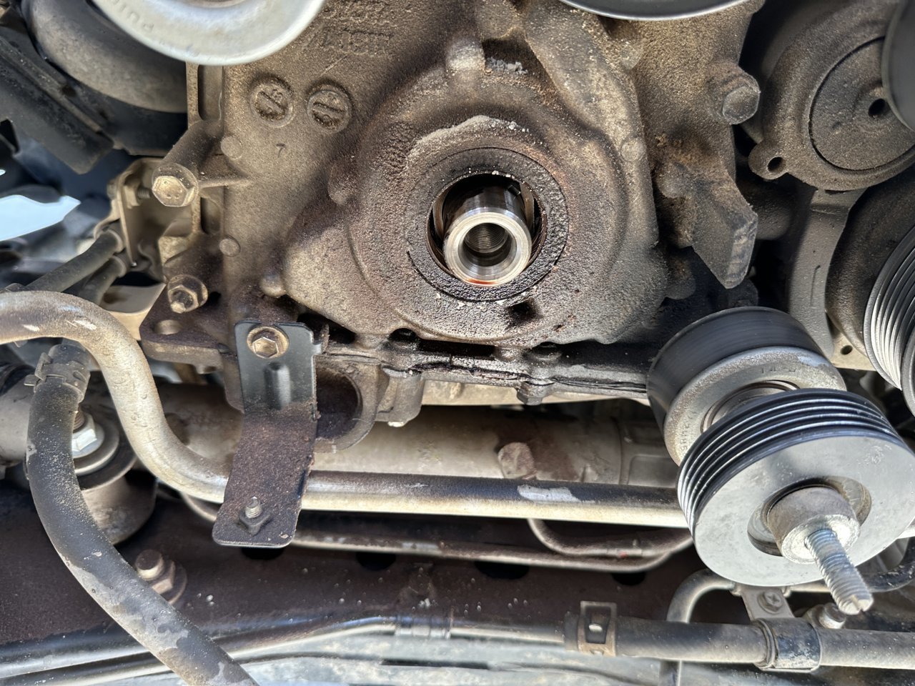

    Well I don't think it’s supposed to look like that. Do we trust any parts store crank seals or should I wait for toyota to open tomorrow?

    I can't remember who the hell made the seal. I think it was Beck Arnley, but I would go with that one vs the Toyota one. I ran that one on the front of mine and it's been smooth sailing ever since.

    Oooof. That probably made a funny noise.

    Nah Rods said bye bye.

    Actually wasn’t too bad. All I heard was just the pieces of metal hit the ground and the smoke bomb behind me

    New crank seal in. Seems to be holding up for now.
    Also for the breaking studs, is everyone breaking the bottom stud or the top? While I was on the floor contemplating life something made me try and wiggle my studs. My bottom one had a little play in it. Then I was able to loosen it by hand.. didn’t seem right to me. I pulled it out and inspected it but it seemed to look ok so I cleaned the threads and gave her a good 1/4-1/2 turn with the double nut method..
    I wonder if the studs can come loose when we take the tensioner off and cause issues down the line? No clue how tight it’s supposed to be in there but I didn’t feel comfortable applying any more torque than I did.

    The problem studs are the bottom ones mostly. You may want to replace that.

    I will look into buying a new one. I wonder where @Athlaos got his new stud at, it seems to be stronger
    video for reference. Sorry it’s vertical and youtube uploaded it as a short which is annoying.

    Did you retighten it? It looks loose as in it backed out.

    I did, and all seems ok for now. I wonder how long it’s been like that. I never thought to give them a little shake test.

    I usually always do that to my studs. The fact it's been loose may have compromised their longevity though so just a small heads up Murph.

    Interesting - hope it holds on, my bottom one broke recently. I had a local machine shop make some out of 4140. Here's the post for those interested in more pictures and stuff:
