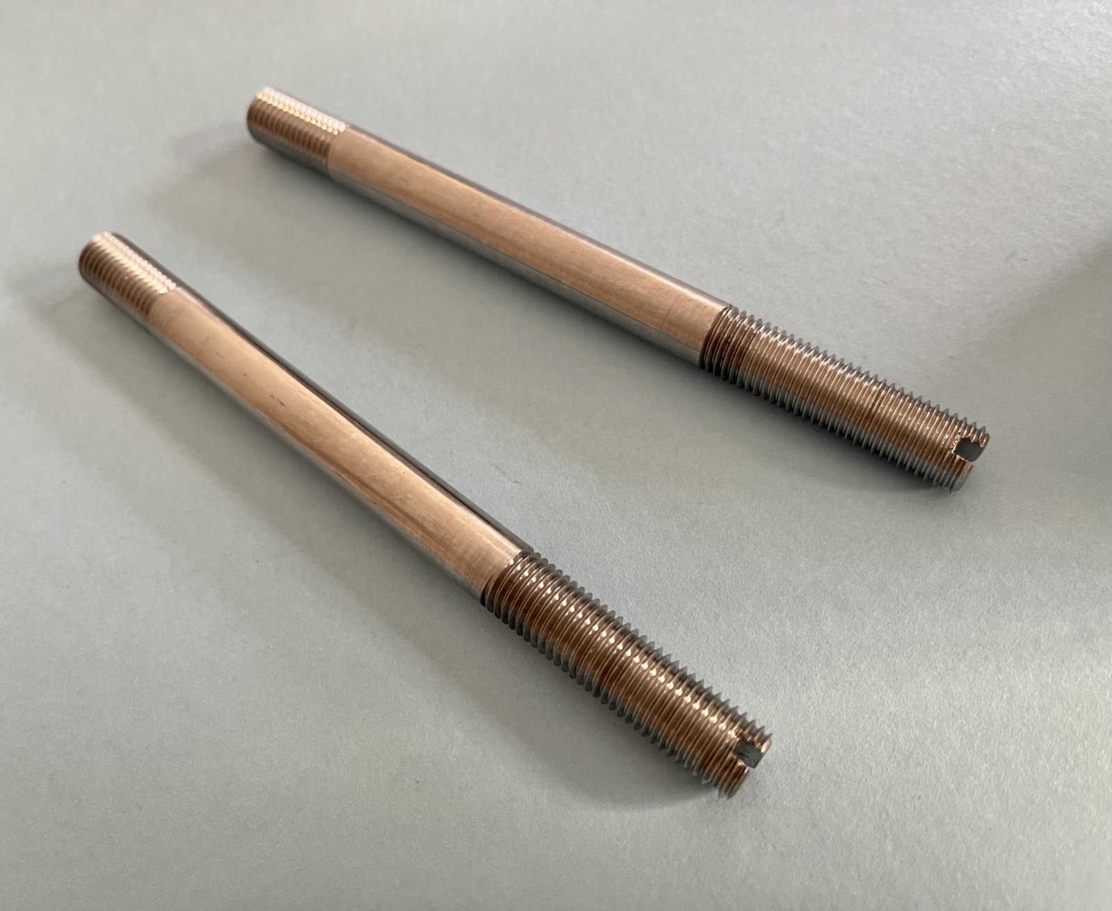

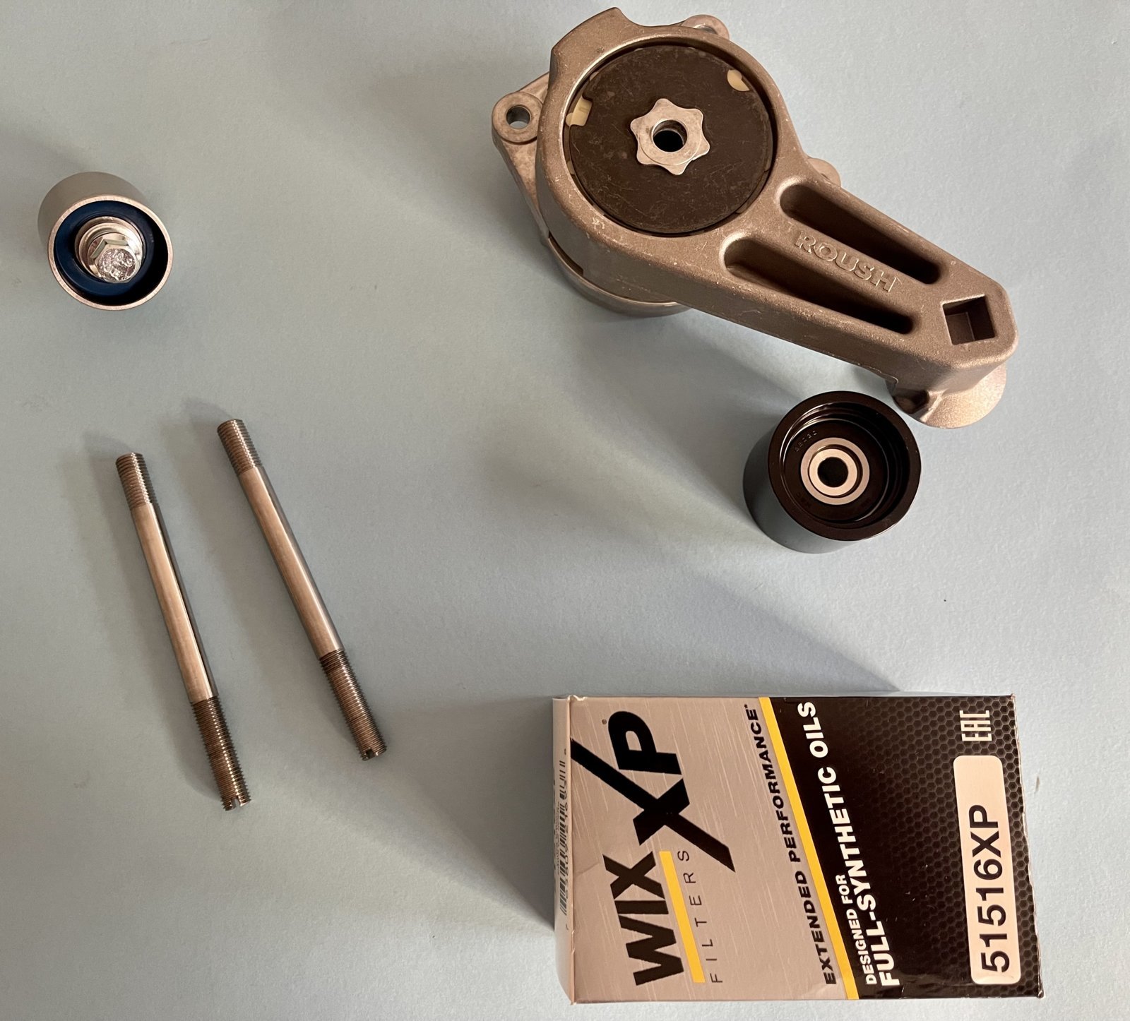

    Hey everyone, just wanted to do a shout out in thanks to a few guys here that helped me, and to ask maybe a couple questions still to the group.
    Some of you may recall a post I made a few months ago when I mentioned that I may move to a larger pulley size due to slippage.
    Little did I know (my bad, having been away from the forum almost 7 years), that this had already been figured out, and there was no need to change supercharger pulleys.
    I asked a few questions, and contacted some of the guys by PM. I contacted @BillDaCat8 , and he was super helpful getting me started in the right direction. I bought a VW oem pulley, and then contacted @XPOTRPR via PM to ask him if he wouldn’t mind machining the pulley for me. Not only did he offer to do the job, but then went out of his way to find the right bolt and washers so I could bolt it right up! Needless to say, I am very grateful.
    In my spare time, I tried to catch up on all the time I’ve been away from the forum by reading as much as I could from this thread.
    I found that some members had experienced the long studs snapping, and that @Athlaos had made some stronger ones last year. I contacted him and he hooked me up with a pair of newly made studs. Another big thank you .
    I went ahead and bought a Rousch tensioner, and the double bearing roller pulley for it.
    Here’s where I have a few questions:
    First, for those of you that have done this, will grinding the tensioner on a simple bench grinder work? Second, after grinding for clearance, will I need a washer between the tensioner and the pulley? Or just a washer on the outside? Does anyone remember what size/length bolt to get? I couldn’t find the post # where it might be discussed.
    Finally, the belt. When everything is done, I’ll have @BillDaCat8 ’s wrap mod, and a 2.55 pulley. I’m guessing the Gates K050705RPM?
    Thanks again for everyone who has helped, this is a great place! Here’s some pics.

    Some nice new studs:

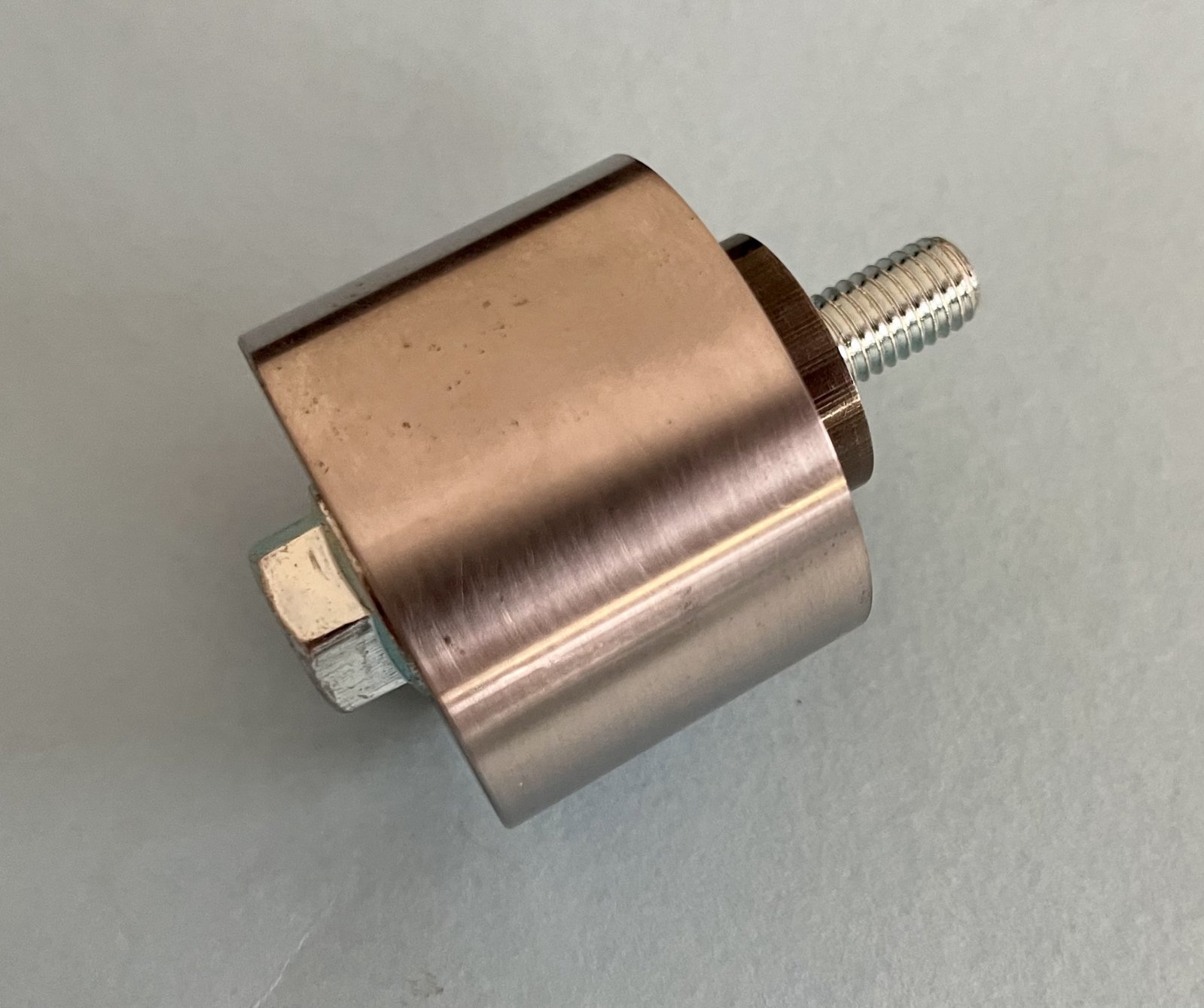

    @XPOTRPR ’s beautifully machined pulley:
    And finally the Roush tensioner and double bearing pulley:
    On a final note, if anyone can think of something I could upgrade “while I’m in there”, I’d certainly appreciate the suggestions. I do everything in the driveway, so it will be a while until I can work on it. Lol, winter sucks when you have an X-Runner!

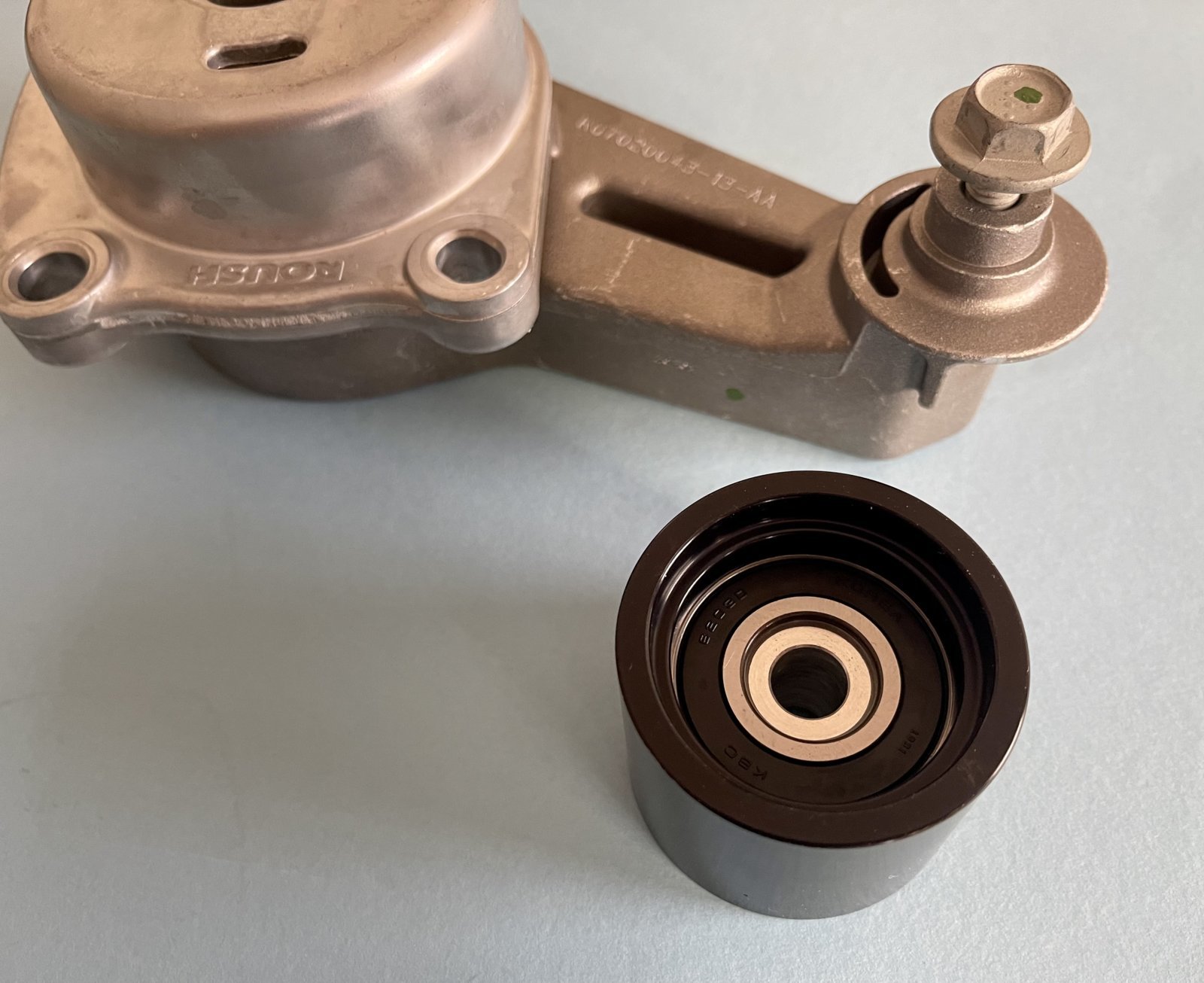

    please check page 1 for correctly mounting pulley on roush tensioner. its photos of mine as i thought i had it correct but didnt. i did a little sanding on the tensioner with an angle grinder and 80 grit paper so the pulley fits as needed. if you put the pulley on as it seems to fit it wont work out so well. hope that makes sense.

    Thanks for replying. I saw your pics on pg1, and know that I’ll have to mount the pulley with the clip facing out. What I was wondering is if a small washer needs to go between the cast tensioner and the pulley. I know one needs to go under the bolt head on the visible side.
    Do you remember what bolt size you needed?

    i dont remember changing anything. i just modified the roush to accept the spacing of said pulley to work. then stuff is good. if you bolt it together and it looks correct pre install its likely a no go. you will see when you align belt. a lil custom grinding and its been sweet like farm butter. you really need to check then see. ive had no issue of fiting since. pm me if you dont have it solved.
