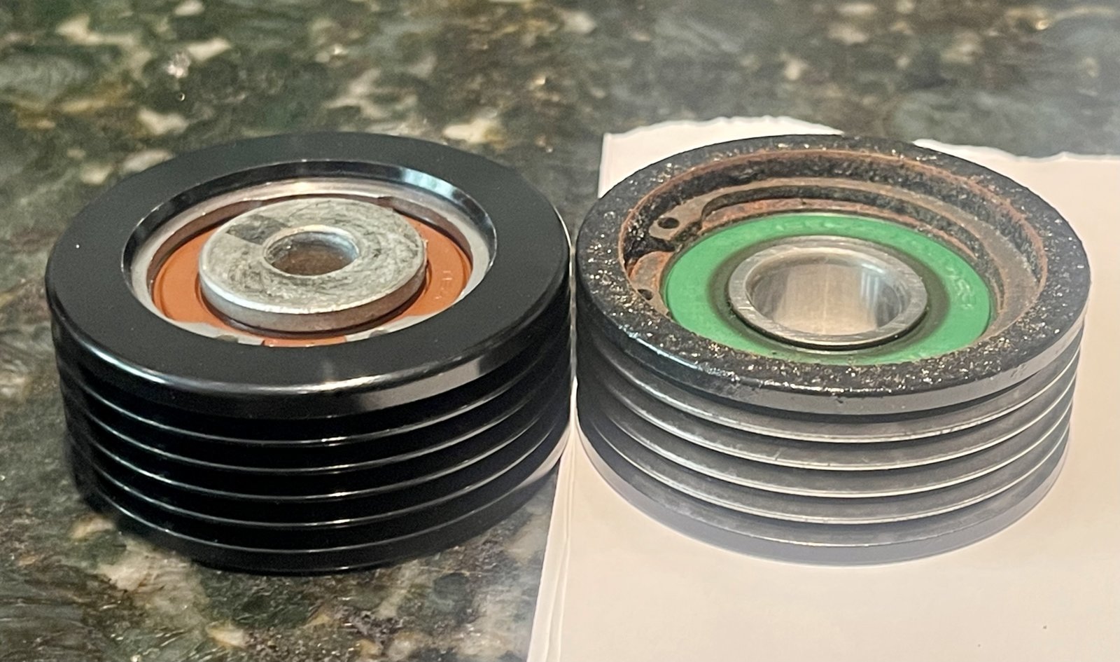

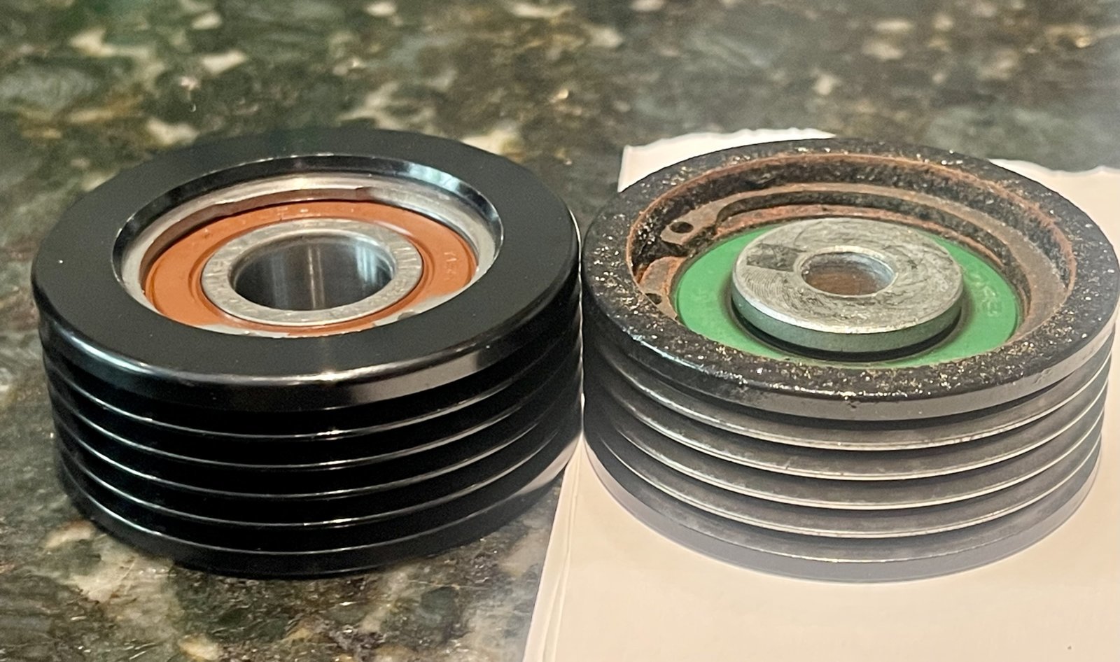

    Interesting details that I did not catch when I installed mine. If you want to purchase original bearings I believe these are them,
    https://rodavictoriausa.com/producto/nsk-alternator-japan-ball-bearing-fits-mercedes-benz-6303-17-x-47-x-14-6303-2rs/
    They are alternator bearings made for higher heat with different seals. I plan on ordering some so I can rebuild my original set of bearings that I will keep as a backup. I am still running the scol bearings with new everything else. If I snap a stud any time soon then I will be inclined to think the pulleys are an issue but I don’t think I am going to be having any stud issues anymore.

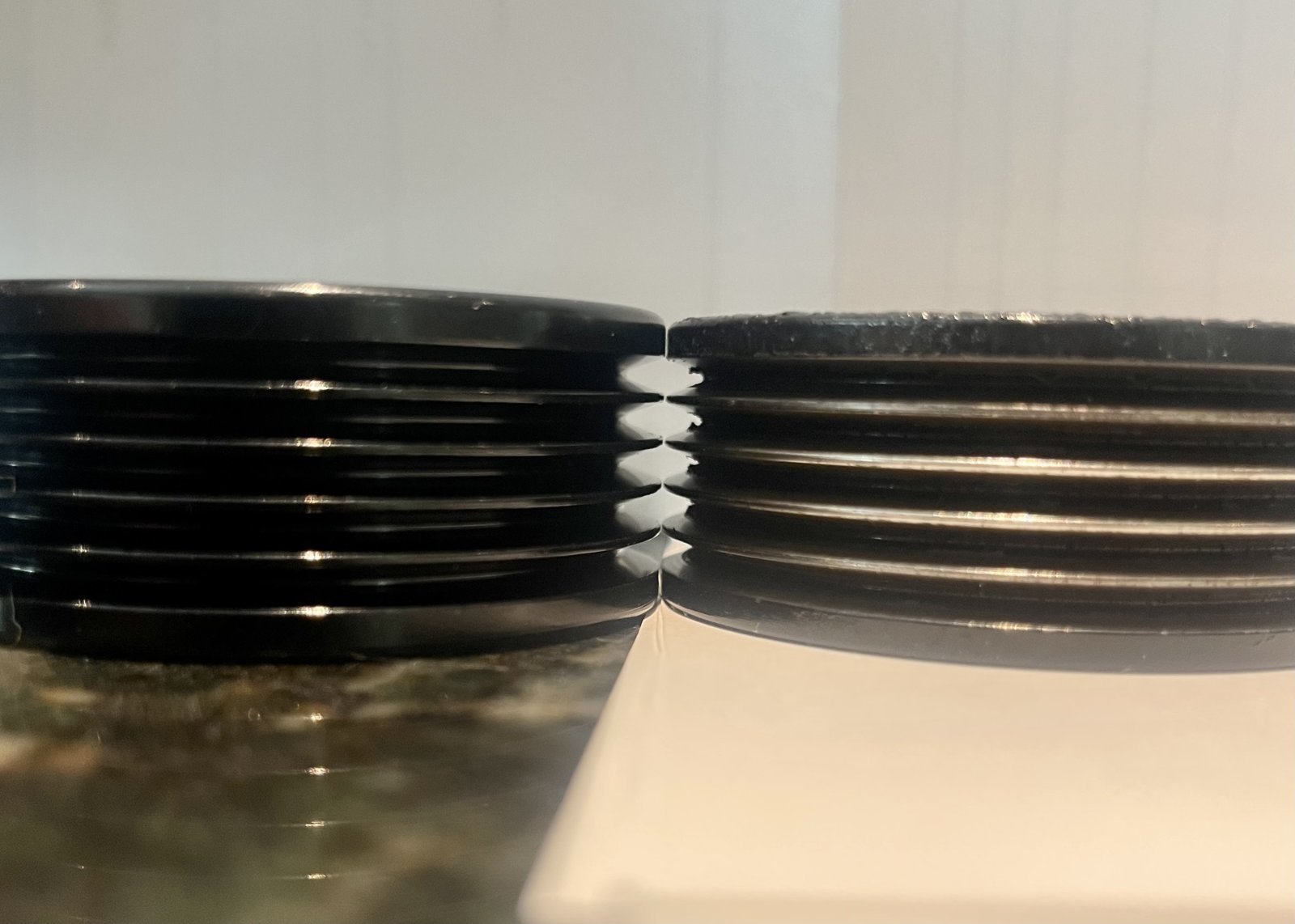

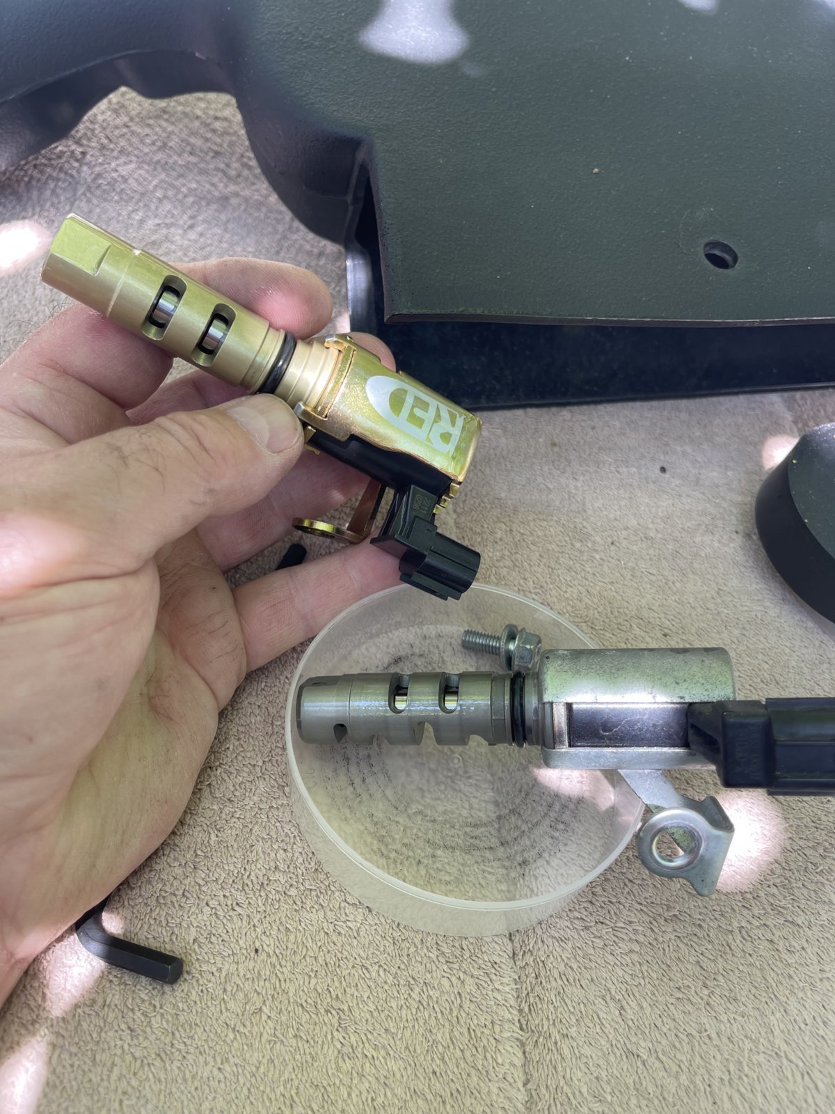

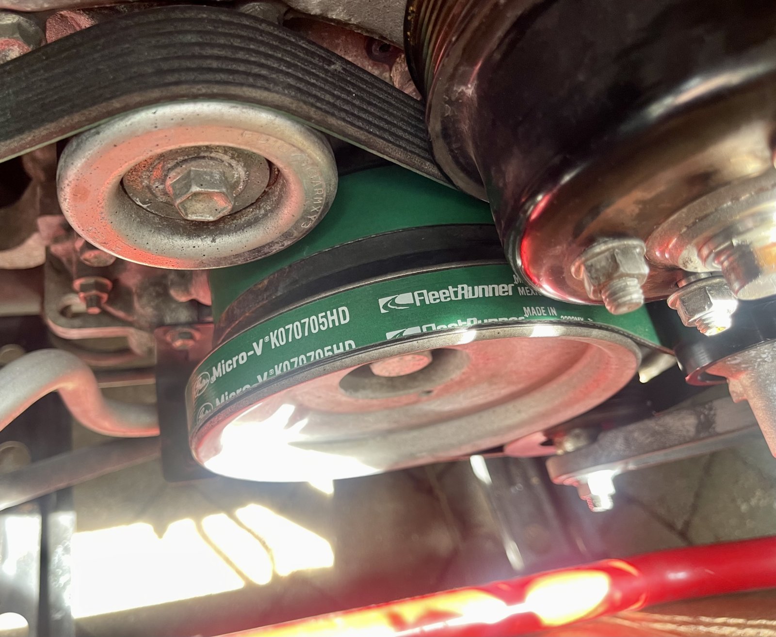

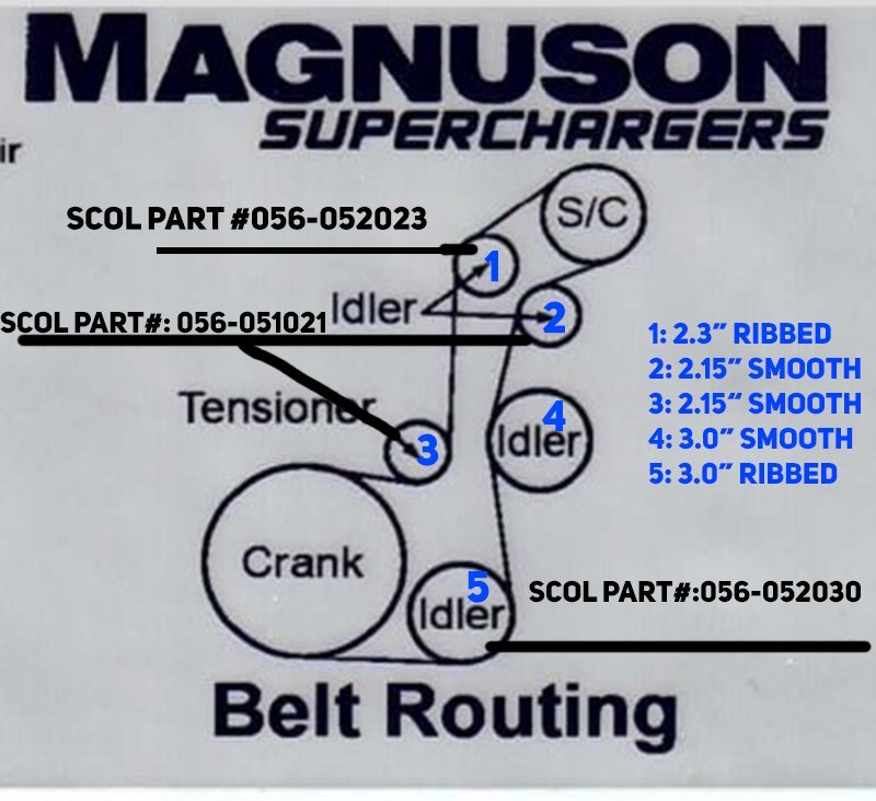

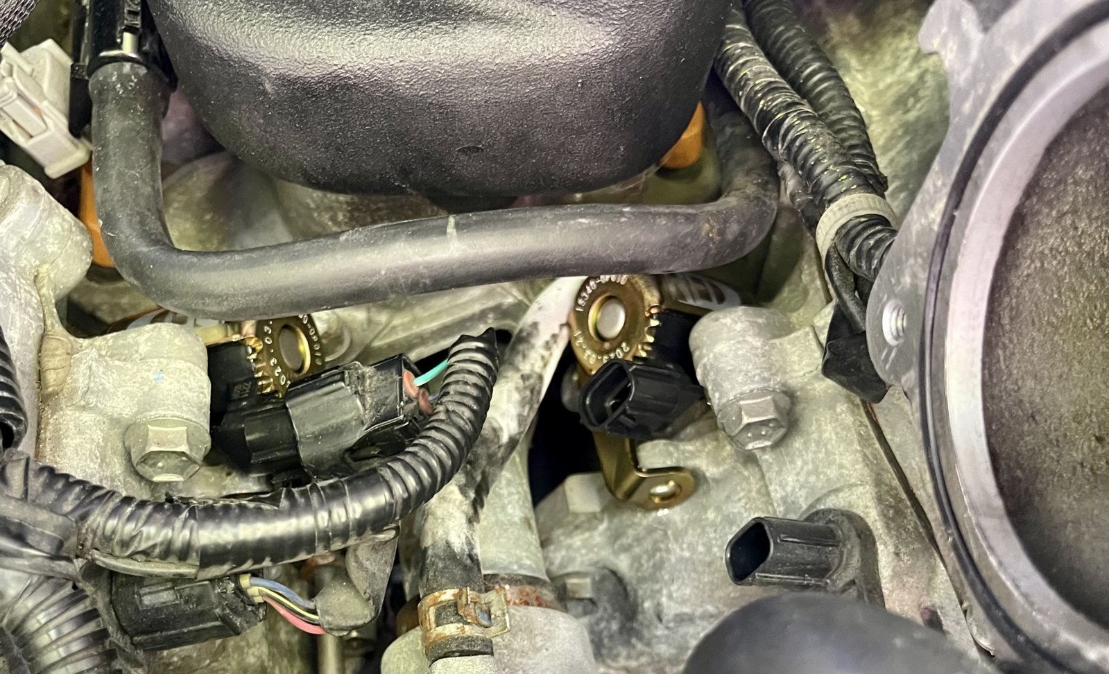

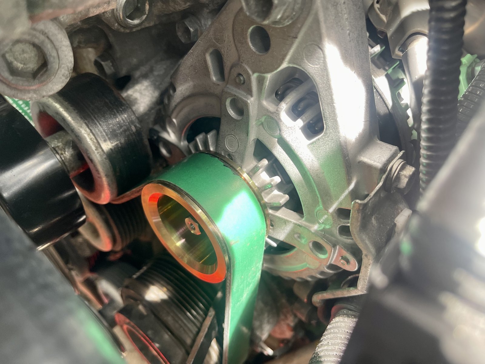

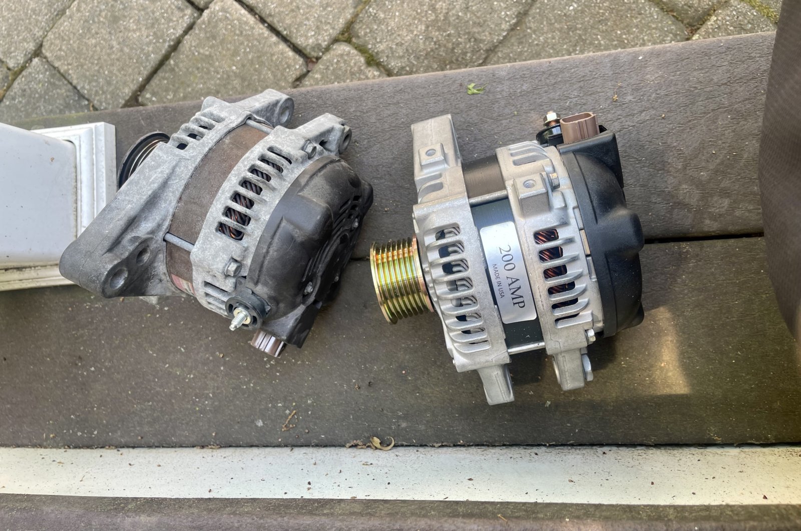

    Done for the day. Hopefully I can enjoy it for the summer without anything breaking. “Since I was in there”, I installed a new 200 amp alternator, overkill for what I need but still an improvement. Gates fleet runner belts for both accessories and supercharger. RB VVT solenoids, a new SCOL smooth #2 pulley, and a new Dayco 89007 3” smooth pulley.
    Take-off pulleys I’m keeping as spares.
    Regarding the SCOL pulley that I found doesn’t line up correctly, I refuse to install it and will be contacting SCOL regarding a return/refund. However, being the pessimist that I am, I’m betting I’ll get beat on it. I also bought a SCOL lower 3” ribbed pulley, but I don’t have access to a proper drill to hone it out, and I refuse to possibly compromise the @Athlaos stud by sanding it down, so I’ll just sit on that one for a while.
    On a side note (and not to flame anyone, this is just a hypothesis): I’ll take odds that @Murphinator ‘s belt was thrown due to the misalignment of the pulleys, and the belt got jammed up in the process and sent a shock load to the stud that instantly snapped it. It’s just a theory, I don’t mean to offend anyone, call me an ass if I’m totally wrong.
    On that note, I’m going to finish installing the fan and the battery back into the truck and call it a day. Enjoy the holiday weekend everyone, and stay safe :cheers:

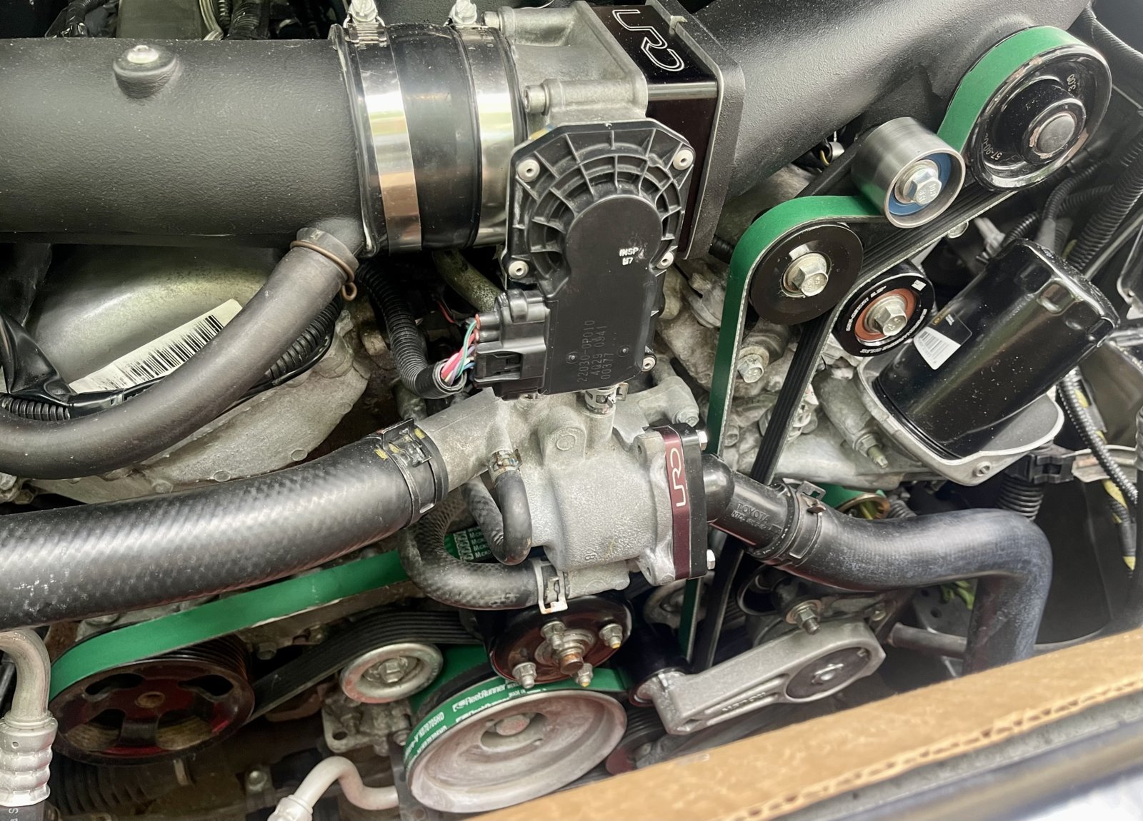

    Belt wrap mod - keep the belt from slipping - usually reserved for smaller diameter supercharger drive pulley sizes.

    1)it lessens the slack/deflection in the belt
    2) billdacat8 researched and DIYed it. One of the members machines them iirc. If not, I have a couple done up already by Gary from Design Craft Fab.
    3) You would only use it if you went down in pulley size or changed belt size due to the other series available and non-compliant sizes. You can help the belt and pulley deflection get in range.

    With a 2.8, not at all. I'm on a 2.7 with a Roush tensioner and the stock belt. When I went to a pulley wrap, it was too tight with little to no deflection. You don't want a case where it's on the verge of unnecessary stress since the tensioner should be doing the job.

    Btw, I never had slip when I had a 2.7 on. I went to a 2.55 and it slipped like hell.
    All in the past now, and all is good. The 2.55 is great for what I want out of the truck, and the @BillDaCat8 wrap plus Rousch tensioner was the perfect solution. Not only more top boost, but way better drivability and more boost and power throughout the range, which is exactly what I was looking for.

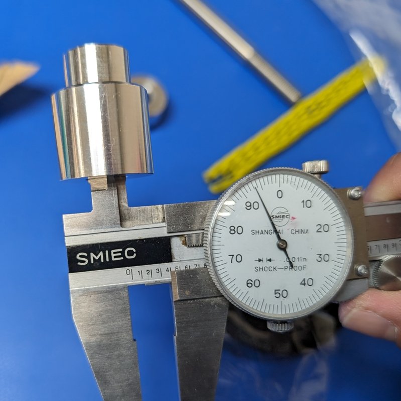

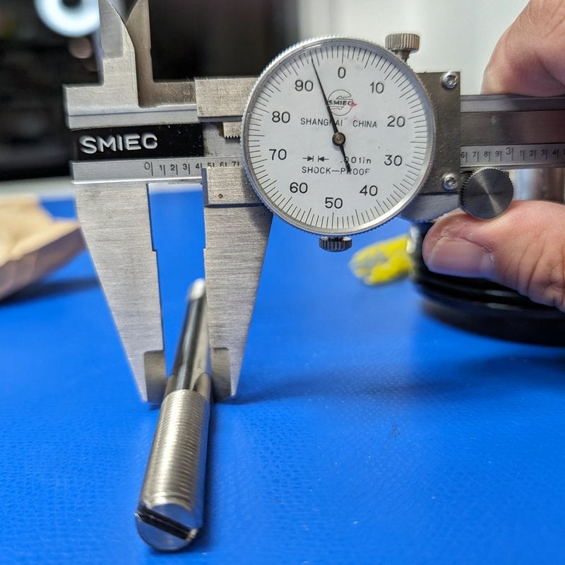

    I'm curious to know more about what sanding would be required on the stud to install the pulley?

    On the SCOL pulley, it's less than a hair too small on the diameter of your strengthened studs. More.of a SCOL problem seeing as very few are running their pulleys.
