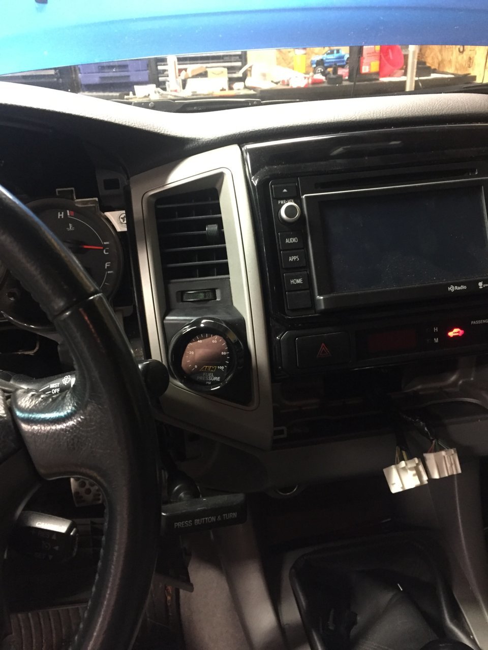

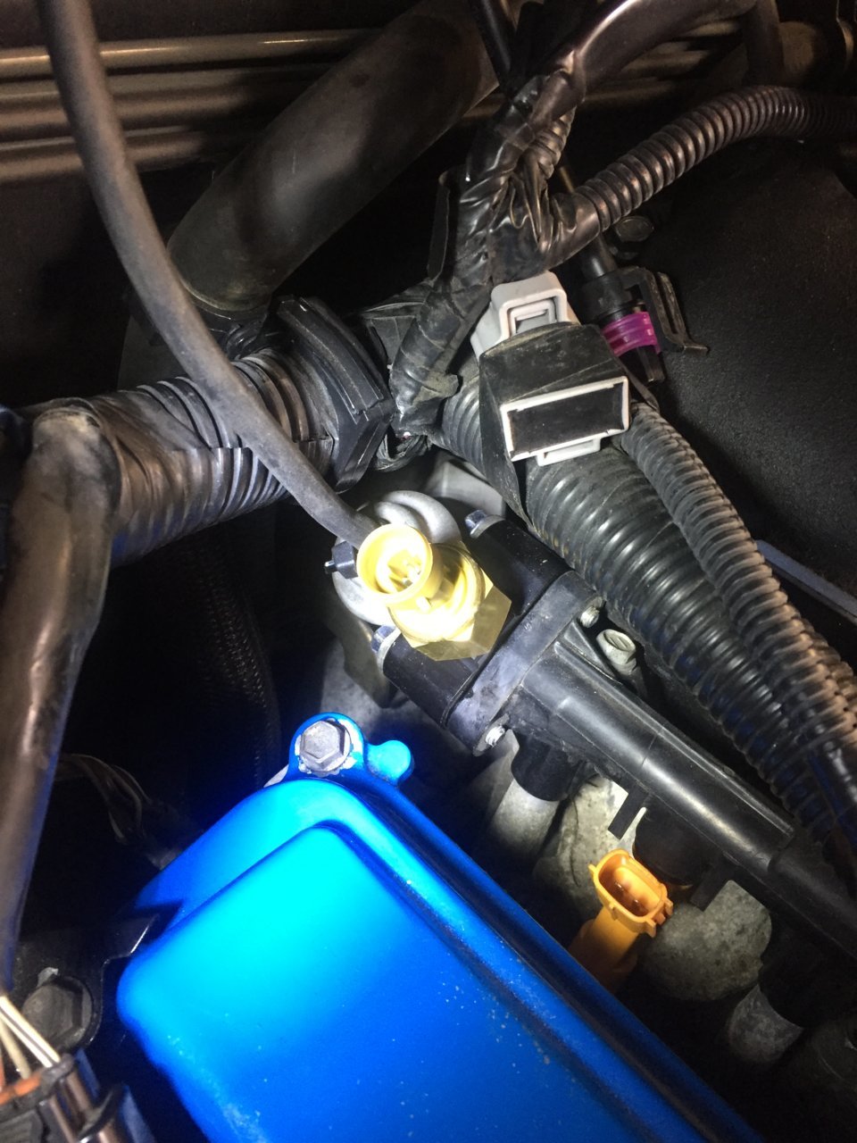

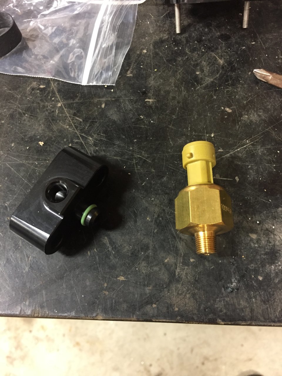

    974BB86E-6B80-4AC0-8EBB-8530D23BD04A.jpg BF7A34C6-AD93-42E5-84F1-2D052AC21AF3.jpg 29CEB5FF-F044-4ACC-98B7-062589F16DC9.jpg I have a aem fuel pressure gauge. Very simple and easy to install with fuel rail tap.

    It's interesting that it got better when you removed the restrictor jet. Have you felt the bypass valve actuator arm and moved it fully open and closed to make sure it is not binding?
    I agree a loose or kinked line at the pump could cause some weird and inconsistent issues especially because of the afr fluctuations. It's almost like the pump cavitates momentarily at high demand.
    You are not running the fpr mod correct?
    I would check the line that goes from the fpr ro the intake. Remove it and check for any cracks or holes.
    It would also be beneficial to actually see the bypass valve working. If you have a go pro or similar you could take video of the actuator to make sure its opening and closing correctly.

    Yeah, im going to wait and see what gadget has to say, and then go from there. Will go snag a fuel filter during lunch today and hope that it solves my issues, but im not expecting it to..
    Thanks for the pics and info, that seems pretty straight forward with the tap. Where did you get the brass fitting at that fits into the port? And do you basically just run a vacuum hose from the port to the gauge, or how does that work?
    I have not checked the bypass actuator, but will definitely do that later today.
