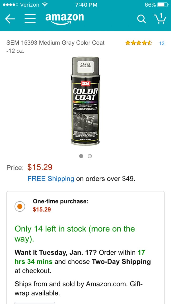

    Sure! I did I pretty good write up on it. I’ve sent it to a couple guys on how I did mine. I can send it to you too. You do need to do some very minor trimming with a dremmel tool but it’s all simple. As far as the grey. It matches close enough that you absolutely cannot tell the difference....and I’m picky about that kinda stuff...gimme a little bit and I’ll send you that write up :thumbsup:

    I painted my a pillar. Came out great. Sem paint is awesome
