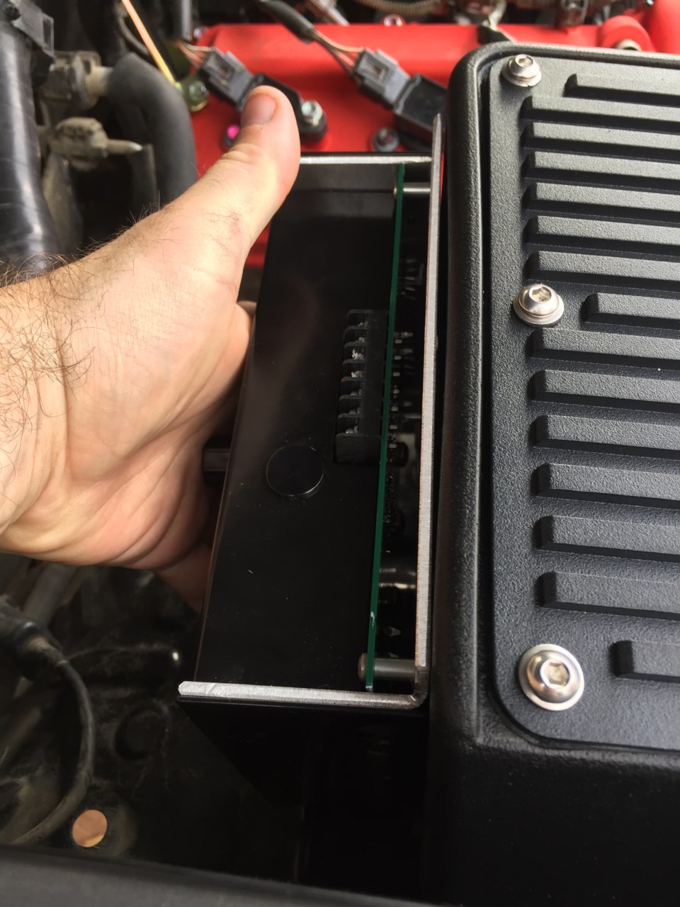

    Before I moved up to the twin, I had the small ARB compressor mounted to the side of an AFE. I used the little mounting plate that the ARB came with as a backer inside the box, but I doubt I needed it. The AFE is pretty sturdy.
    I think you’d be fine.

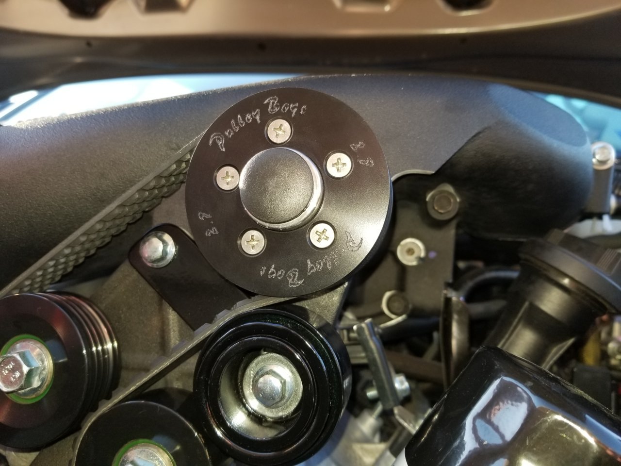

    There is a oil quantity check plug on the front. With the truck level pull the plug until oil is just oozing out.
    20180225_173422.jpg Its the allen bolt just to the right of the pulley.

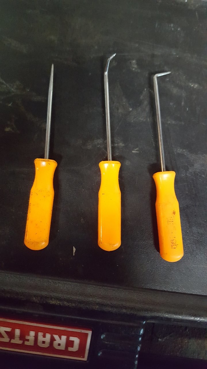

    That connection was definitely the worst part of the mod. I used these small picks to get in the connector and free up each side
