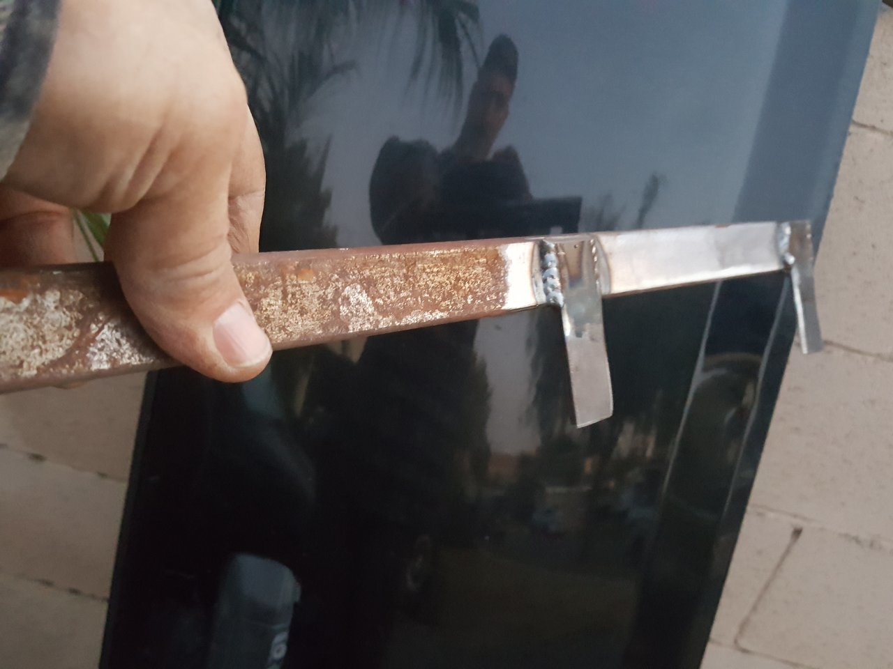

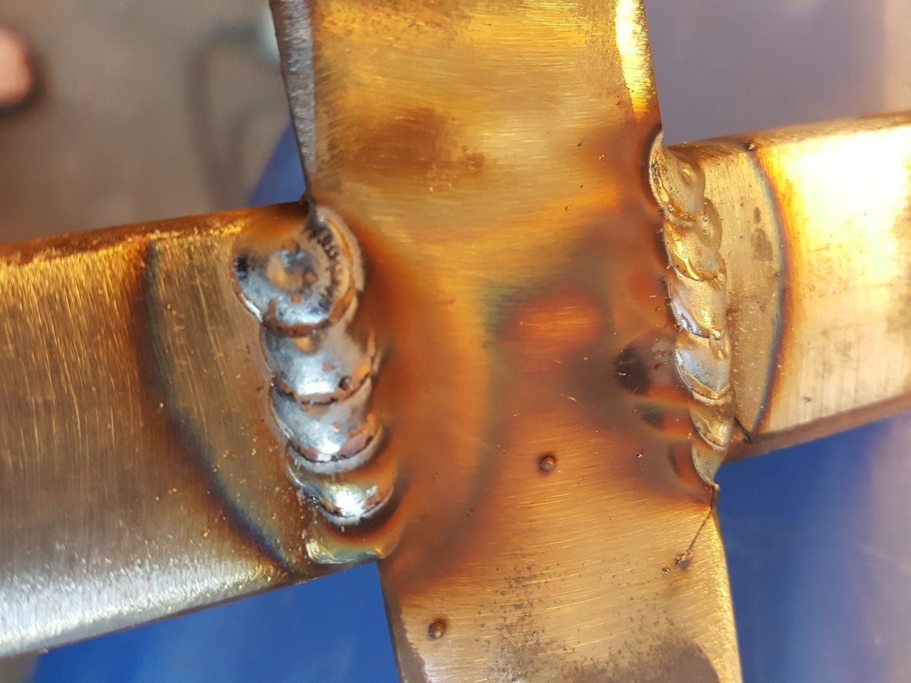

    I am sorry. I should have said that I was looking for a solution for opening the ring that holds the fuel pump enclosure. Something that would allow to open up the tank without having 'the SST" ;)
    15 minutes later I had this:
    Made from about 16" of 1" steel tube and some 1" strap. I shaped the inner edges of the 1" strap as to mimic the geometry of a mating tooth of the teeth on the circumference of the claping ring.
    This took it off, hasle free in seconds. Any local people wanting to use it, pm me.
    Each 1" strap welded in 3 places. On both sides of the strap and the horizontal seam closest to the teeth of the tool.

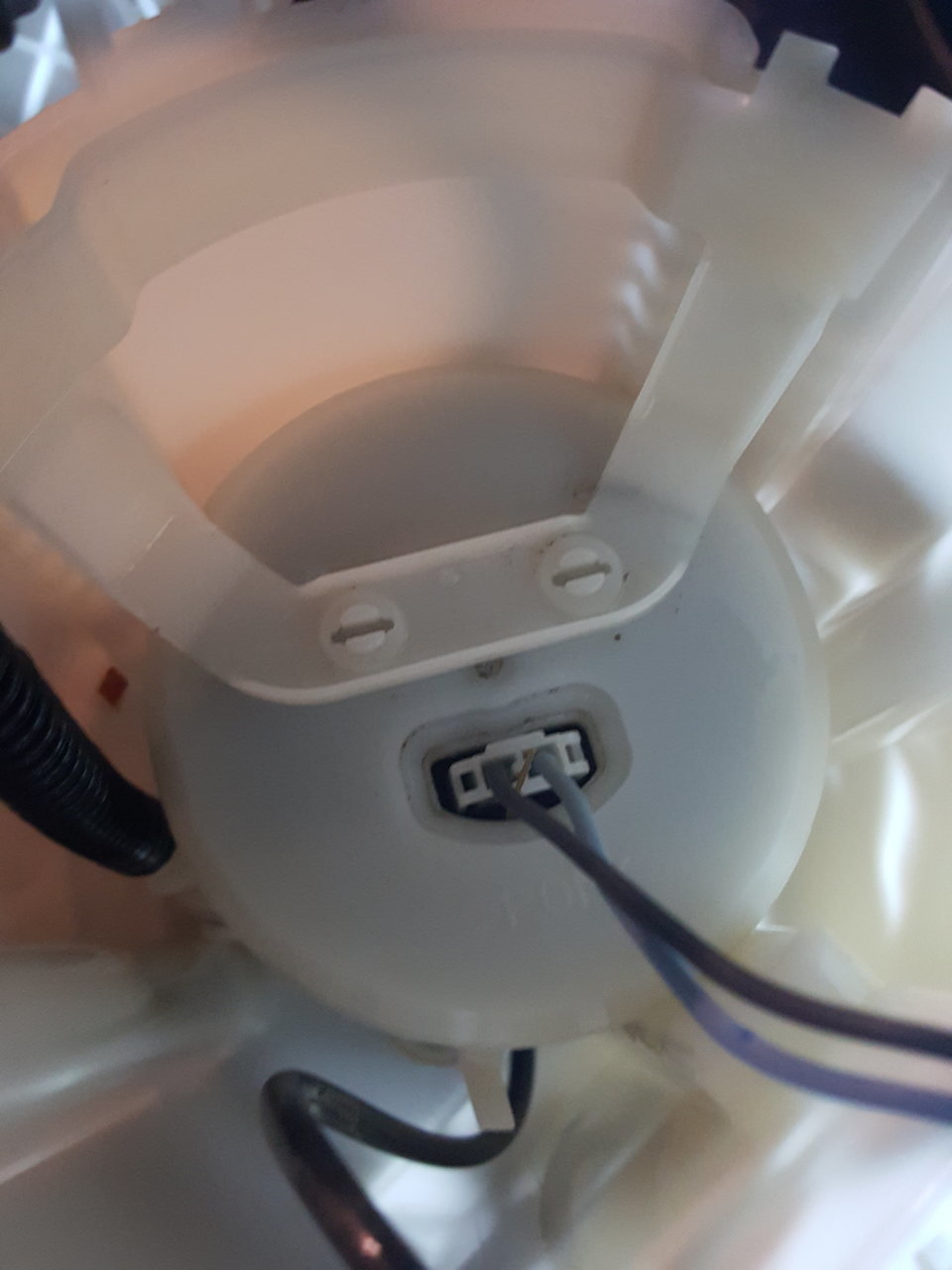

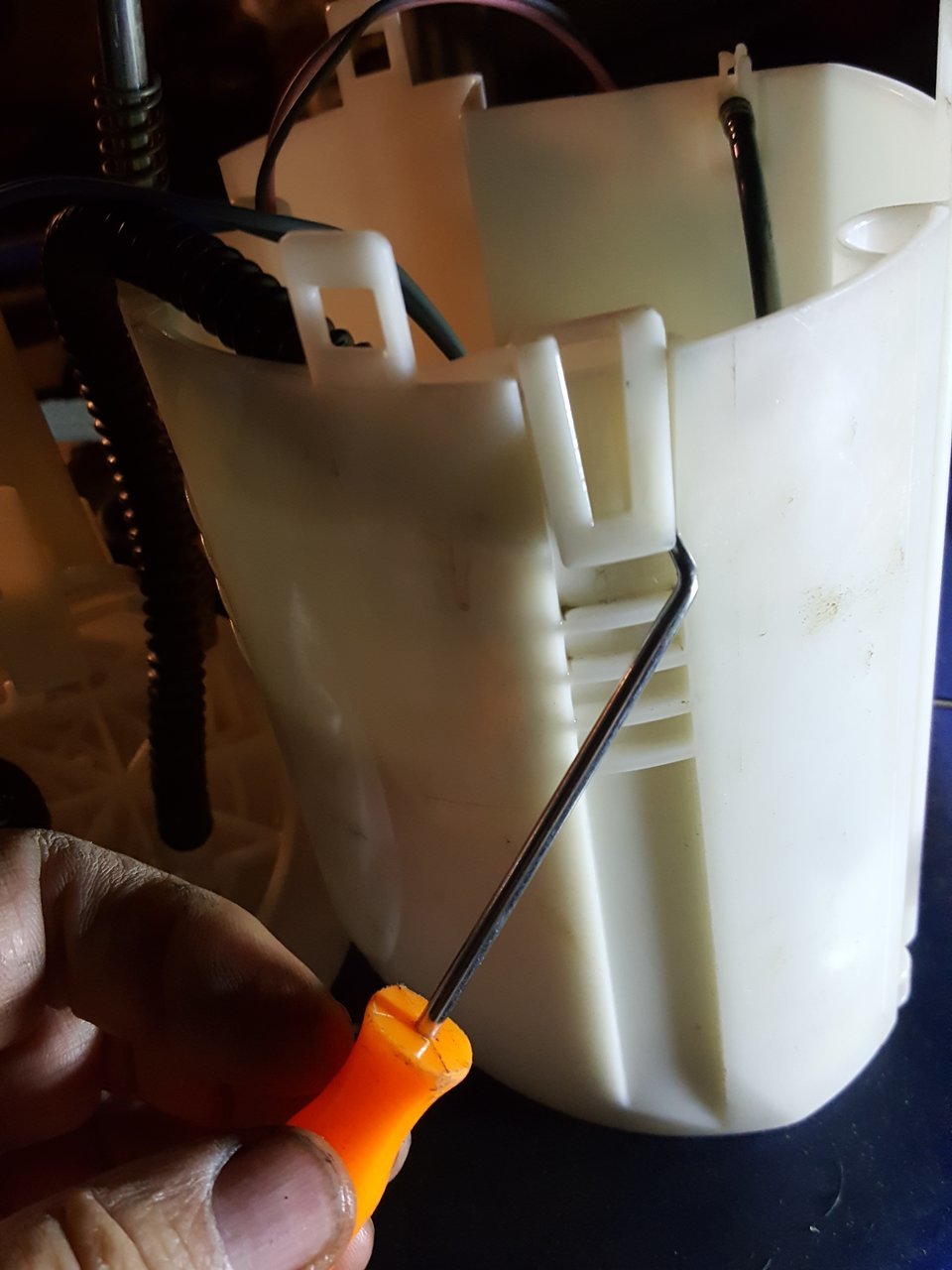

    Is this the same oe pump that you that did the AEM upgrade had?

    #1173
    GT7
    GT7 One piece at a time
    Aug 15, 2014
    #136201
    2,502
    Grant
    Phoenix
    2013 DCLB
    For mine yes.

    Not quite sure how the taller pump goes in here. Is there a write-up somewhere?
  15. Dec 17, 2017 at 8:05 PM
    #1175
    GT7
    Aug 15, 2014
    #136201
    2,502
    Grant
    Phoenix
    2013 DCLB
    Nope
    Just go for it
