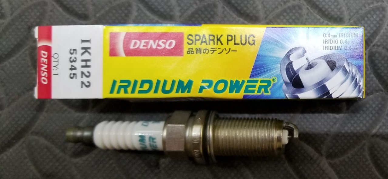

    Denso IKH22 gapped to .032"
    Service interval is 100k but i wouldnt wait that long

    Im going less than 60K for safety sake
    Also the gap was close nuff right out of the box.... Are u sposed to even mess with iridium gaps?

    I went about 50k. They were toast.

    In general, no, don't mess with Iridium plug gaps.

    Shouldn't have any issues gapping iridiums as long as you dont touch the electrode when doing it. The electrode is more fragile on iridiums
