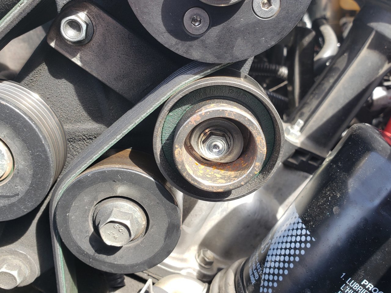

    It almost looks like the smooth side of the belt is running on a ribbed surface.

    I'm really not sure. It just looked like I should ask.

    I'll double check my routing. Crashnburn and I put it on. If it was wrong I'm sure one of us would have seen it.

    @12TRDTacoma ,@Roostfactor belt routing appears fine. Not my level of mild tension on the jfr belt wrap and the matching stripe mark on the pulley under it. Does that tell anything. Btw, stock tensioner still.20190421_144324.jpg

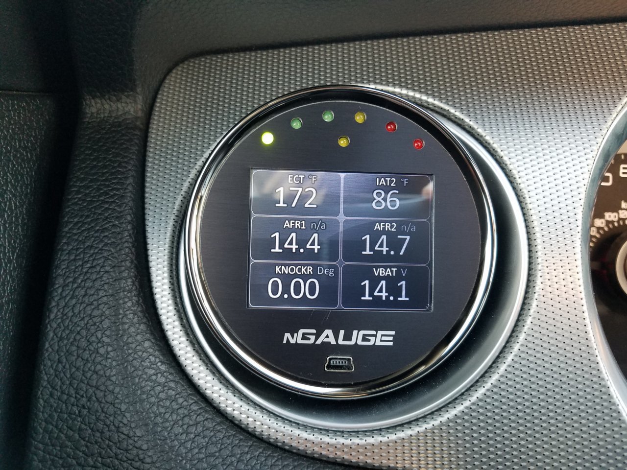

    Little to do with my Tacoma, aside from the fact that it also benefited from the nice BOOST weather that finally arrived in CO last week. (It made driving the Shelby to work even more enjoyable...)

    You are good my man. My belt looks weird like that too. As long as the inside does not show cracking you're good to go.

    Thanks. No cracks.
